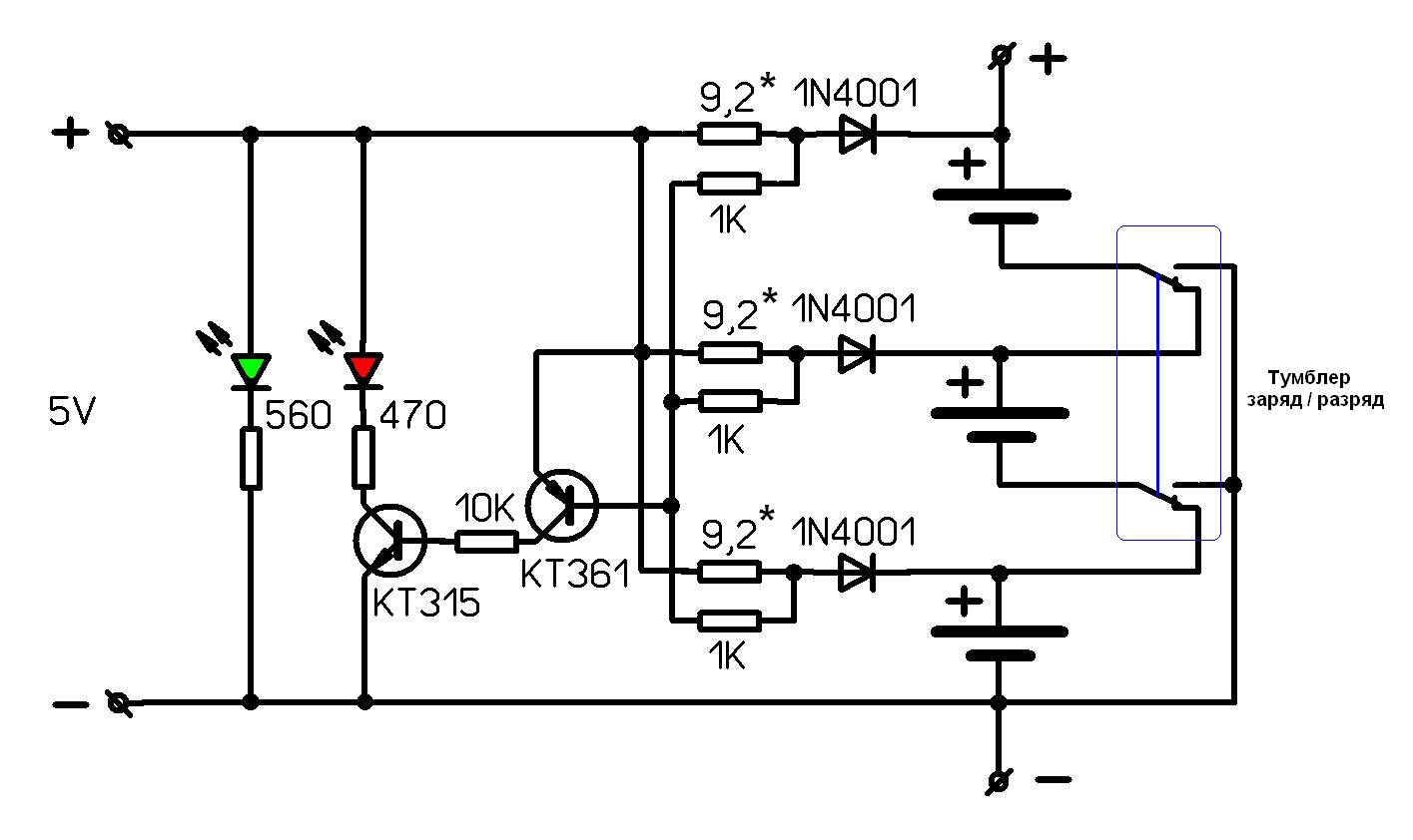

      • Use three mobile phone battery power.3 7V series.

                I have produced success.The detector can distinguish between the cap / aluminum foil and cans pull ring.Twisted-pair coil is very sensitive.I use three mobile phone battery / 3. 7V1300MAH ./11.4V
