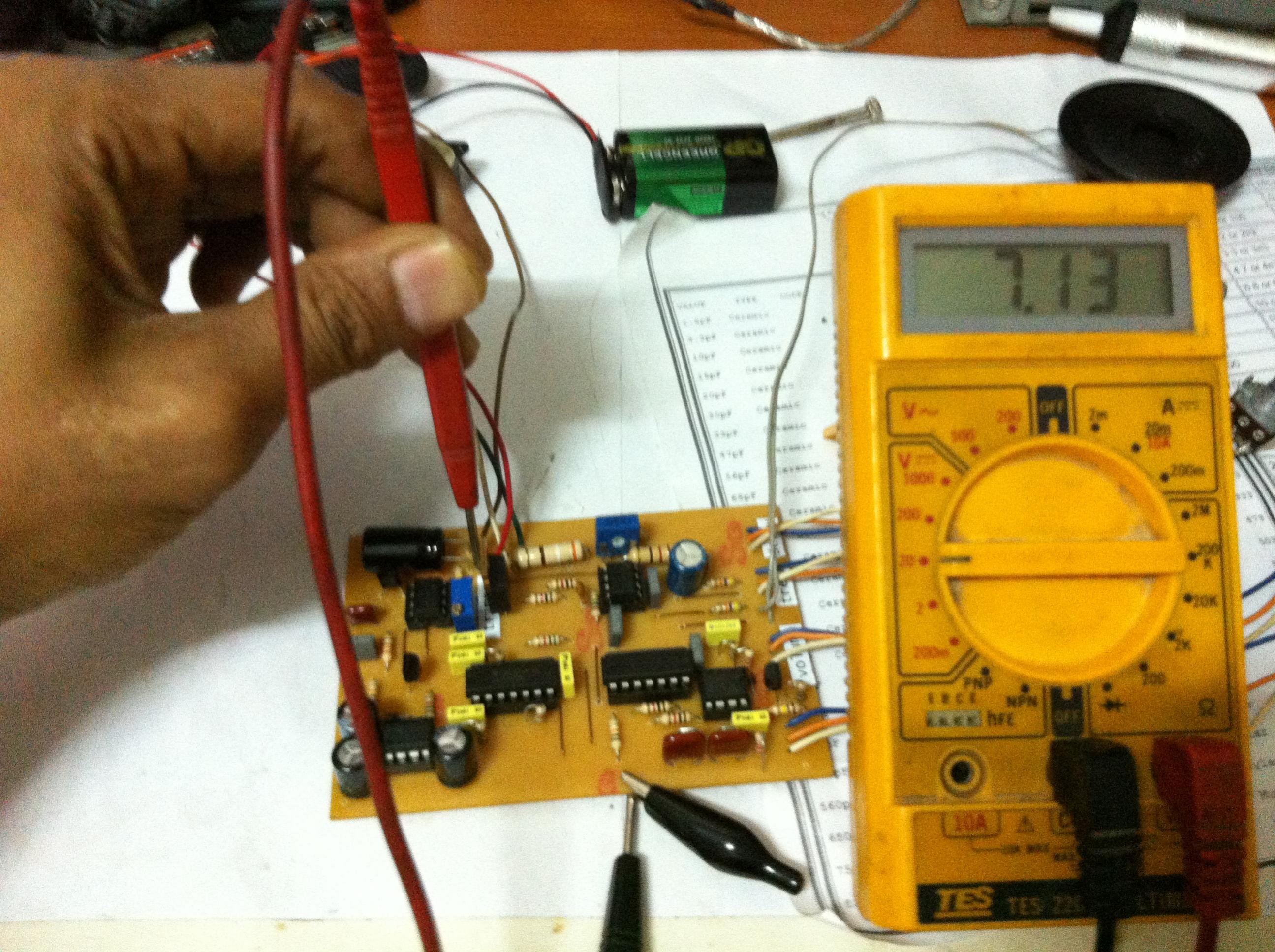

    • Hello Pacu,
      If you have a multymeter connect the com (= ground = black wire) at the - batt from the pcb ( is ground/green tracks on color-bmp pcb)
      The red-meter wire you use to see what volts you have on your PCB.
      For this use the Color drawing that is in replay no. 243
      Orance/brown is the batt. volts , (must be more then 9 volts if not you batt.s are to low)
      red tracks
      must be +5 volt if not then there is a problem with the 78l05 regulator
      blue tracks around -4 volt if not there is a problem with the icl7660
      Check this first ! also check how much current the board takes .. 35-40mA no coil no audio
      Succes...at the end it will work

          The Test Is Look like This or wrong
          I don't know how to use multimeter
          I just want to learn about electronics
          so Im still take time to understand about electronic

            • put your multy meter in the 20 volt range always select the range that gives the best info... so close to what you think it has to be

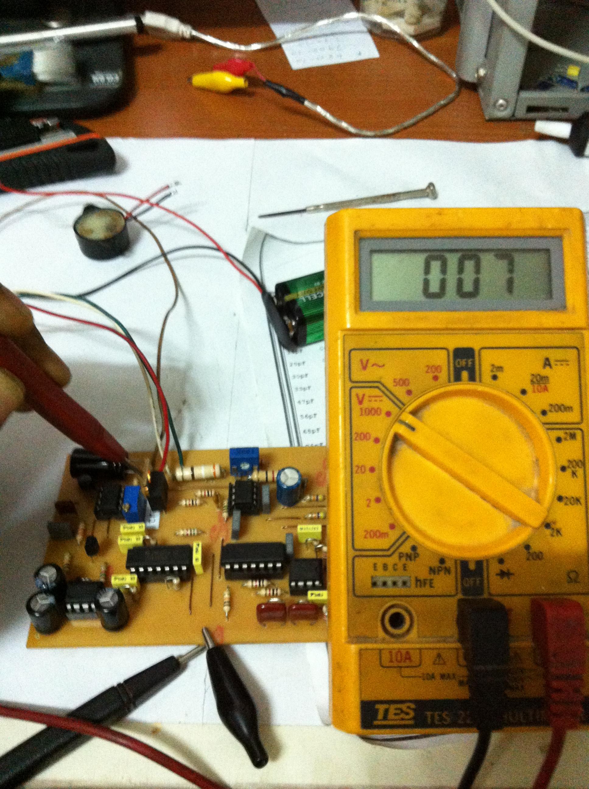

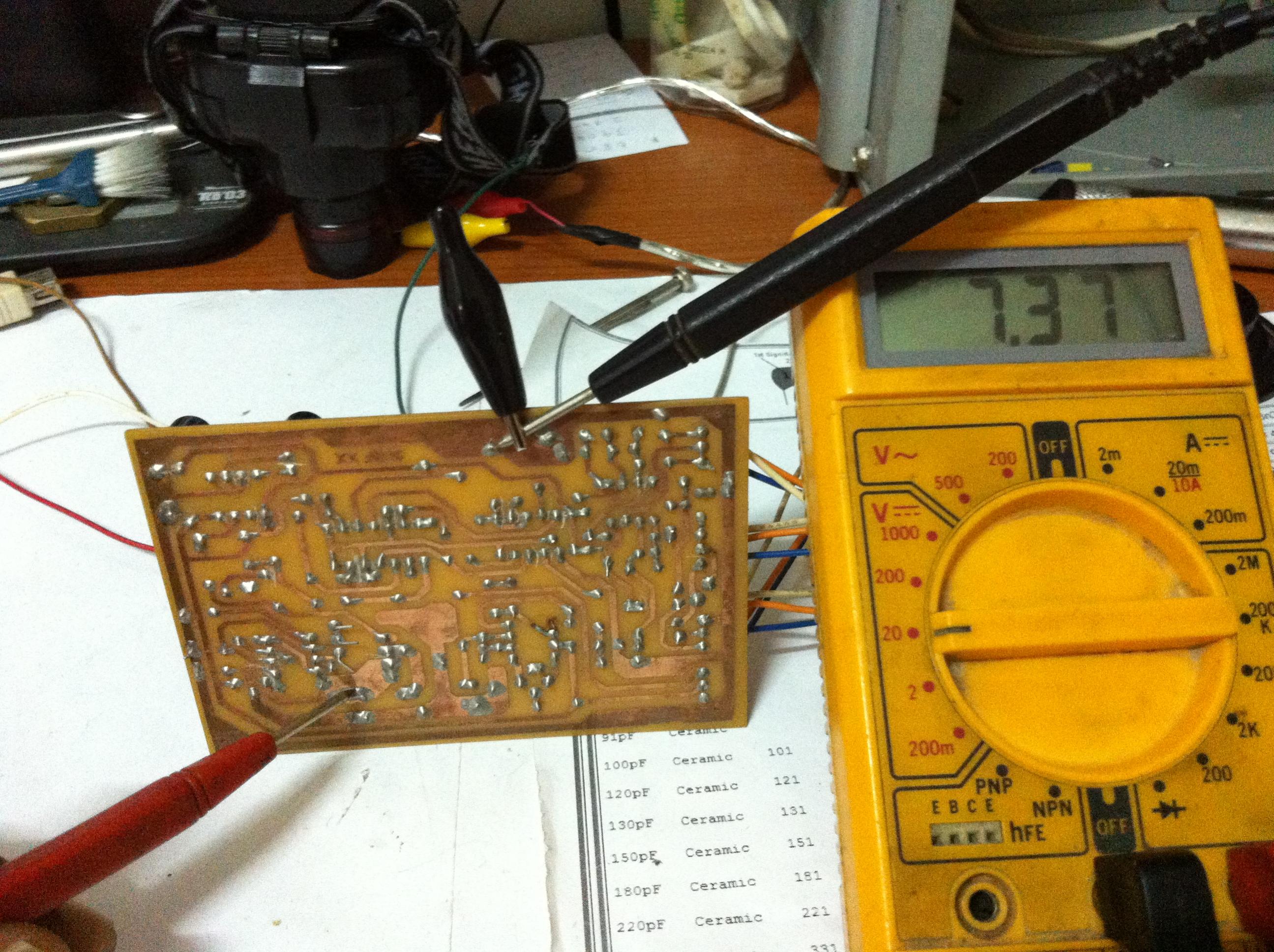

                • These results are
                  i take out speaker and coil
                  These results are
                  • You will make it , I am sure !
                    But you need a better battery,.... ( 8 x1.2V accu) or there is a problem at the board.
                    Put your meter to dc amps 200mA
                    Connect the red wire from the meter to the + connection from the battery
                    Connect the black wire from the meter to the + batt connection from the pcb
                    Connect the -lead from the battery to the - connection from the pcb
                    Now the meter is in serie's with the pcb board so the current in meter will be the same as in the pcb board
                    This way you read on the meter how much current the PCB take's. If ok it must be without audio around 50-60 mA (depends on the coil you have connected) and with audio on some 80-100mA (depends on the speaker you use)
                    Check this!
                    as my Englisch is not the best...if someone can give a better instruction...
                    • Connect the red wire from the meter to the + connection from the battery = i got 06.4
                      Connect the black wire from the meter to the + batt connection from the pcb = i got 06.6
                      ect the -lead from the battery to the - connection from the pcb = i got 0.7.4

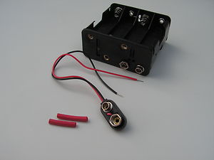

                        Take a 8x1.2volt accu pack (or 8x1.5volt batt) and then follow post no.280
