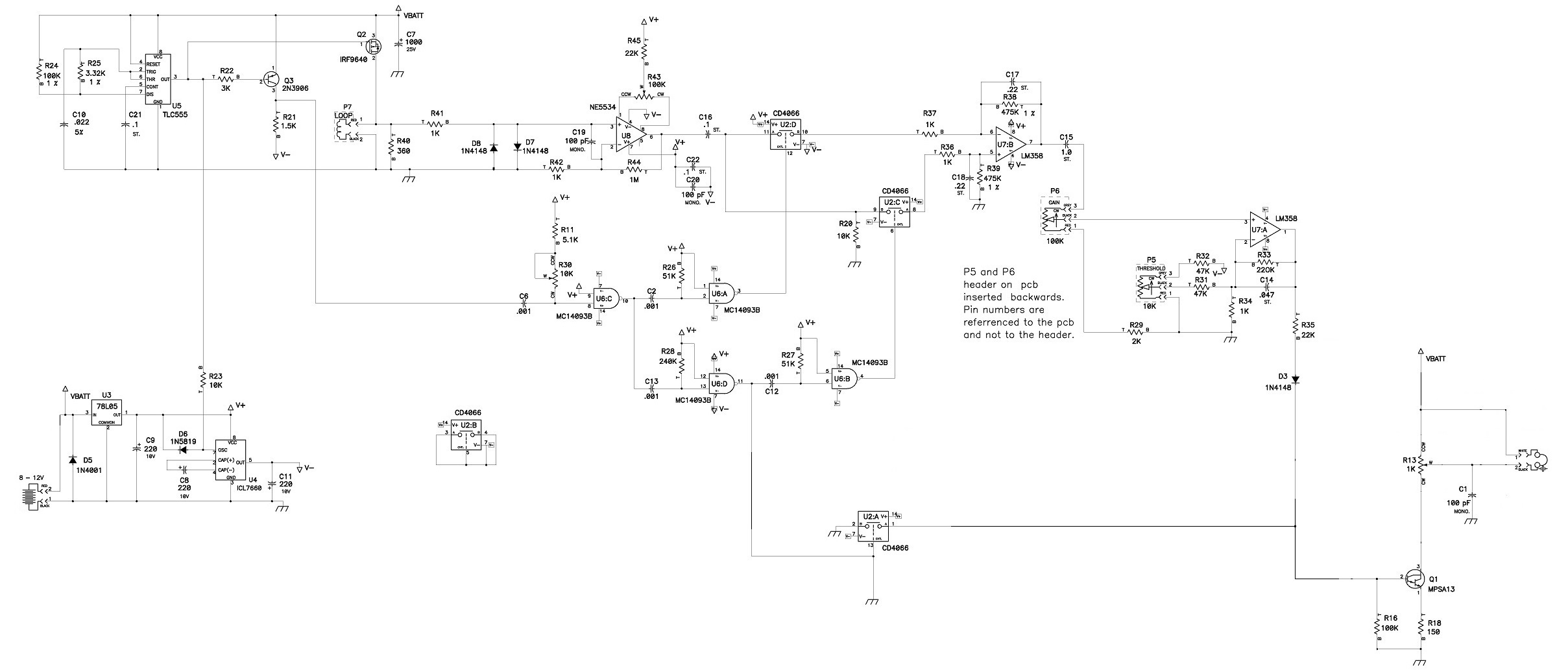

    Why so serious? I'm asking, because i want to know is that synchronized clock signal important to circuit (performance / reliability) and why silverdog's version doesn't have it. If this is too much for asking, maybe i need to stop posting at all for this forum.
    silverdog version is surf pi, and does not have sync osc. Surf pi PRO, has sync osc. and gain control.

      • I think the synchronization is to reduce noise from power supply in the main circuit?

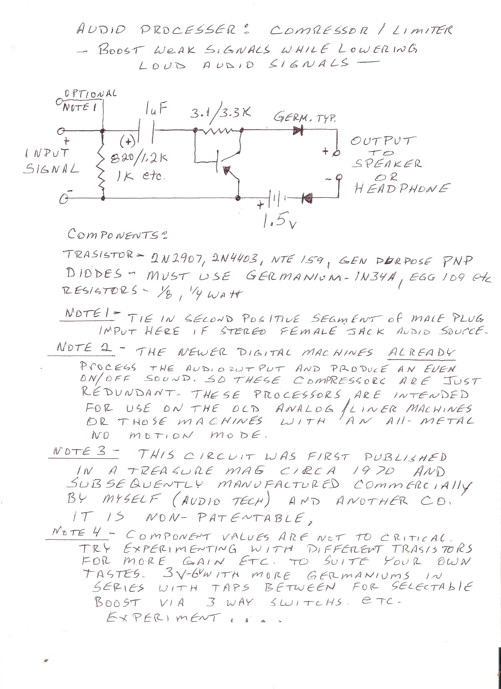

            Loud volume is good for faint deep signals, but i need to find a solution to attenuate the loud volume on shallow targets, as it blow my ears.
            • Have a play at this circuit. I built a few before and they tame down the Booms and Bangs and add a bit of boost to the faint of heart.
                Thanks for the schematic Homefire, i will give it a try when i will find my germanium diodes ). although i would like to see a difference between faint signals and loud signals. With this all sounds will be the same? it says: "will produce an even on-off sound"
                • There is variance in the loudness , just not as much.

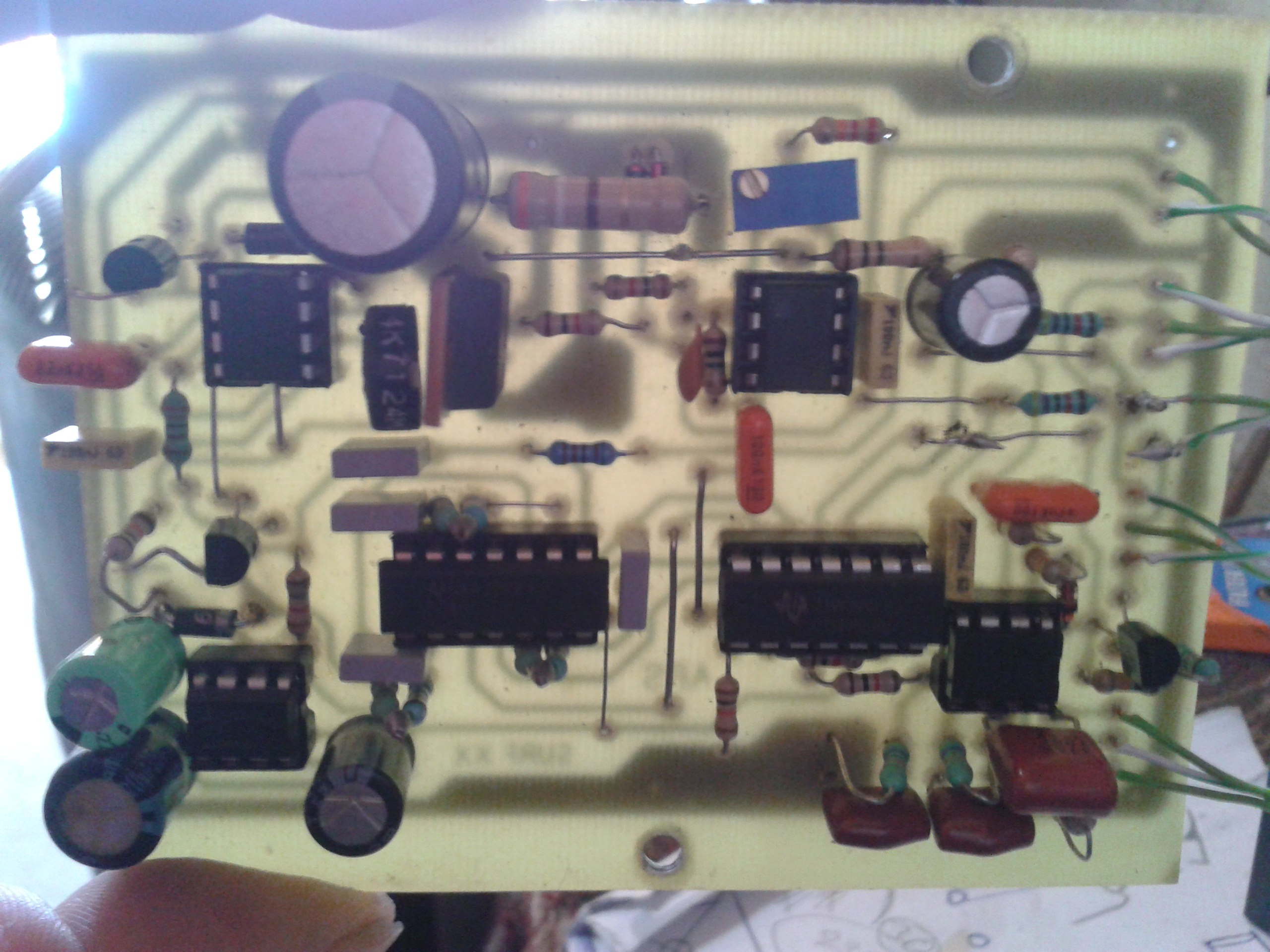

                      • i need some help...........i can detect all metals exept gold and only gold
                        any idea...plzzz your help....
                        5 cent 30 cm
                        1 euro 32 cm
                        3x3 cm aluminiun 45 cm
                        and
                        only 1cm 14k gold cross olso ring on center of my coil
                        helpppppppppppppp plzzzzzzzzzzzzzzzzzzzz
                        • I would suspect your Sample Delay is just too long.

                              Don't expect to much depth for the gold cross. You will need smaller and faster coil for that, beside the good setup of the pcb itself.
                              • thanks for your answers homefire and ionut.........final all good......gold cross a 18 cm.....
                                thank again for helpingClick image for larger version
