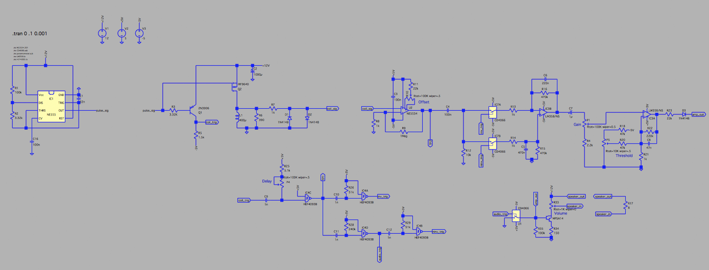

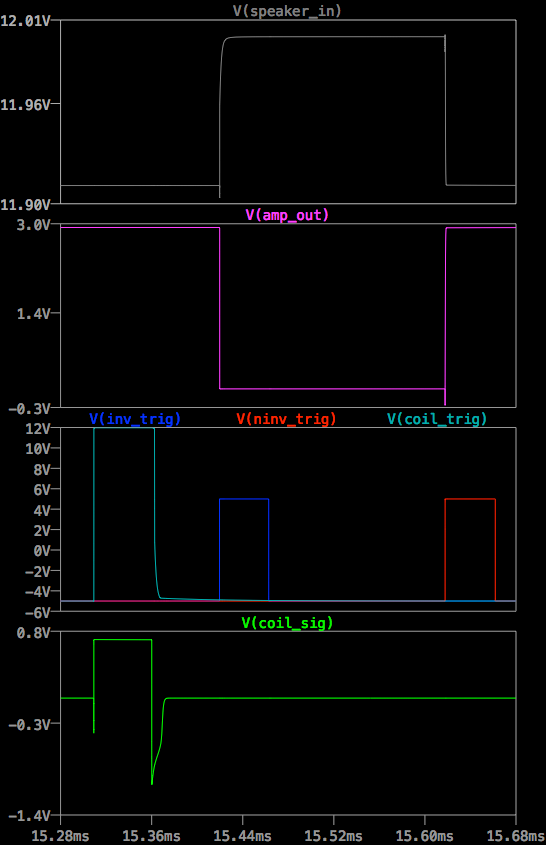

      I had some spare time and put a LtSpice simulation of the SurfPi Pro together to play around and understand the basic circuitry although I'm not sure if the output should look like that
      If someone knows and has the time, I'd like to know:
      1) Why are the signals to the non-inverting and inverting input of the second op-amp ( LM358 ) delayed? (I have attached a plot of the CD4066 switch trigger signal for the inverting (inv_trig) and non-inverting (ninv_trig) input)
      2) Why is there a 100nF capacitor (C4) between the NE5534 amplifier and the LM358 integrator?
      PS: One can also export the audio as WAVE file from LtSpice (gives ~600Hz beep in my simulation)
      Thanks!

      • Your simulation is correct, waveforms should look exactly like on pictures. 5534 must be DC coupled, signal is highly asymmetrical so “baseline” will shift slightly if AC coupling is used. Rest of circuit can be AC coupled however, 100n cap is added to separate DC component, residual offset from 5534 output, to prevent it from interfering with rest of the circuit. First 358 is “differential integrator”, in first sample, signal from target is integrated, in second, delayed sample target signal is already decayed, just earth field is present, and residual integrator offset, these two samples are effectively subtracted to produce output signal. Signal at first 358 is DC voltage varying in presence of metal. Second 358 is connected via RC network, of same time constant as of integrator, this is “motion filter” See original patent for more detailed description.

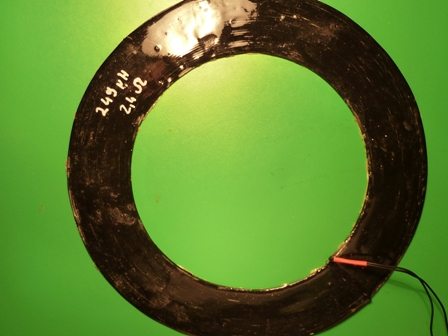

                  • Here's a clue. (Dumping resistor)
                    If the resistance of the coil is too high, then all the power is lost. You heat the coil. But you want to transfer energy to the target. That can not afford the small surf PI.
                    Why not just wrap a new coil? with less resistance. Teflon is not necessary. I have PVC insulation. Enmalled copper wire but goes. Only thicker the wire needs to be.
                    This is my coil: (i have also tried various coils, but this is the best) 0,5mm wire, thin pvc insulation, in resin cast:
