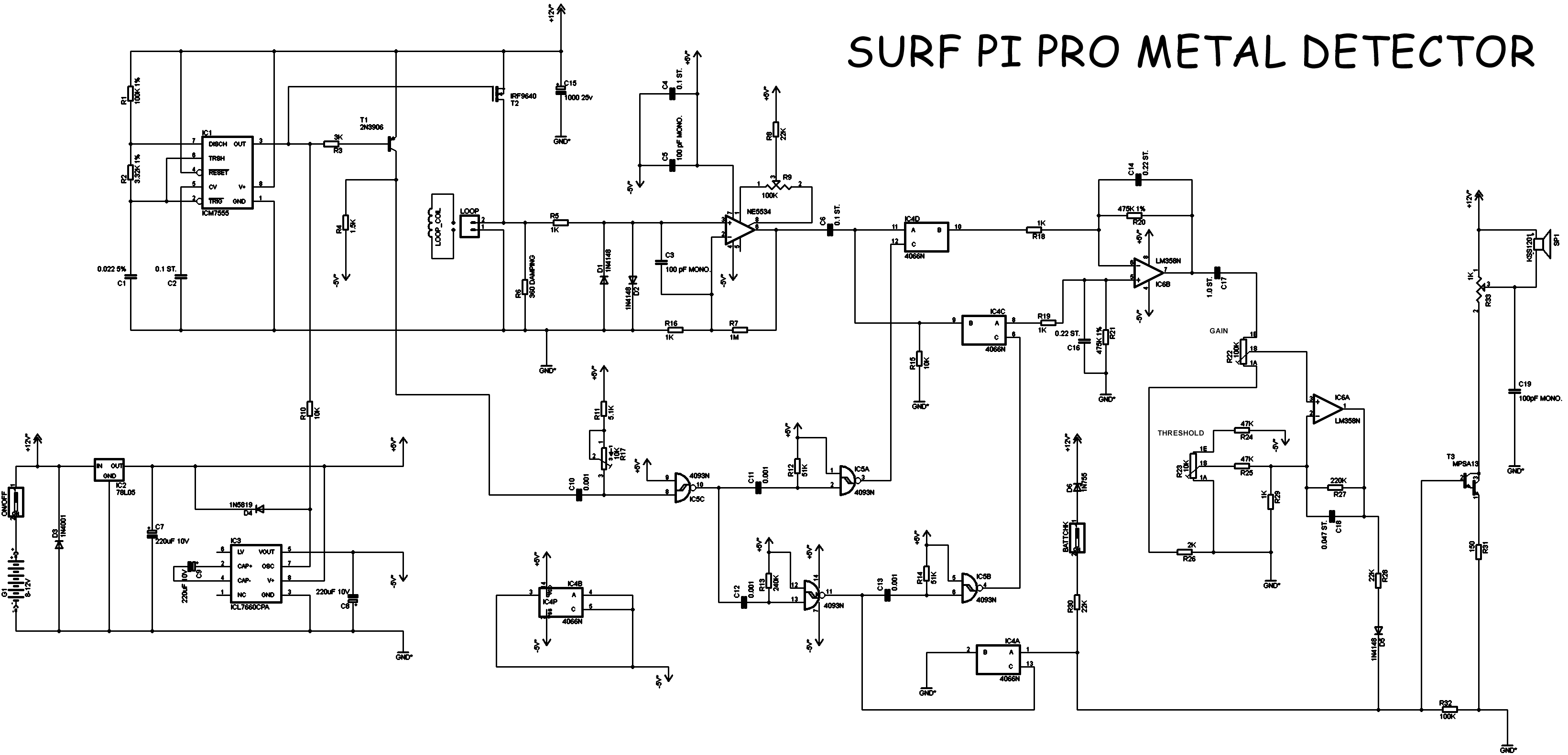

          • The project who have the correct LAY file and circuit
            • I just finished drawing scheme of "Surf Pi PRO", where I used the original scheme by Carl-NC as a substrate.
              I am very pleased that the official version published - thanks Carl!
              Drawing scheme I processed so that the thicker lines suitable for printing.
              By the way, please quick look at the scheme, how I remove potentially mistake, an oversight. From the original scheme, I threw out part of the "Clicker Pro", which to me was confusing.
              [IMG] http://i61.tinypic.com/1zd5b43.png [/ IMG]

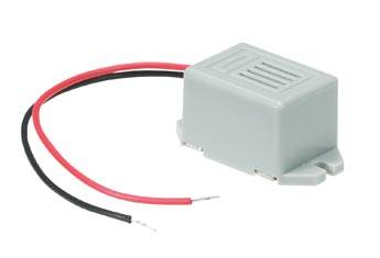

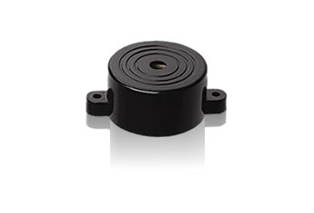

                            • @sinclairuser, what is the clicker pro? is that another variation of the surf pro pi... When saying clicker I am assuming it is the clicking type audio instead of the
                              standard piezo type..
                              Also while I'm in here, what is the best piezo for the surf pro pi? I have tried a few but am not liking the results so far.. attached two of the ones I have tried..
                              thanks in advance
