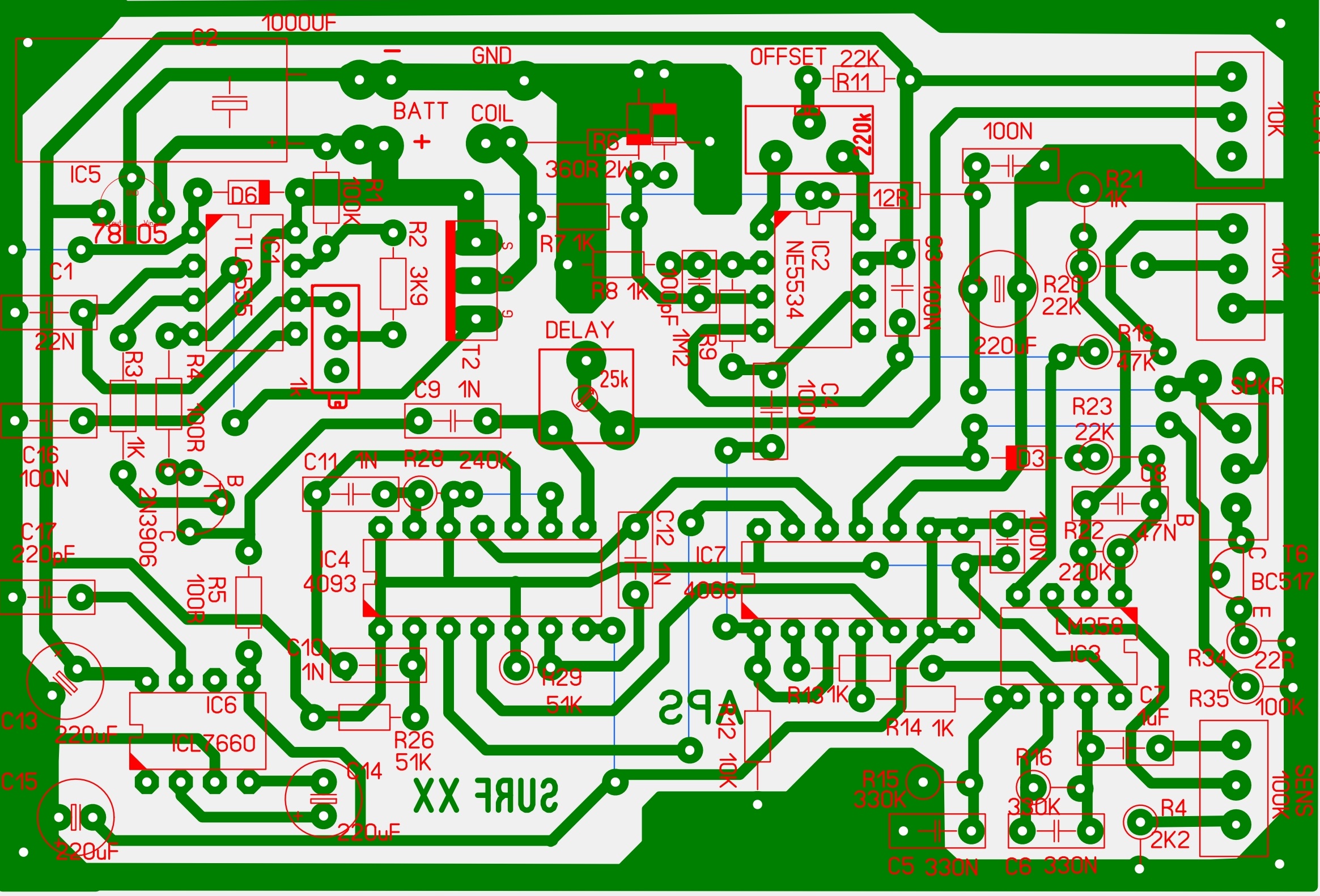

      • [ATTACH]31684[/ATTACH...... here the Surf XXX pcb in sprint layout 6, you have to check it before you built it ! , do not know if this was the last version I made.. but found it again on an old drive..

          • hi, the surfxxx, doesnt seem to work in eagle software, but works in sprint layout 6.0, do you have it in eagle 6.5.0 cheers
            • Surfxx is better then surf pi 1.2
              thanks APP
              • hi paku, Guru, do you have this file for sprint layout 5.0 cheers
                • yea i have i have download from this forum upload by apberg
                  but i still not make it
                  if u diligent you can make it and share the result here :P

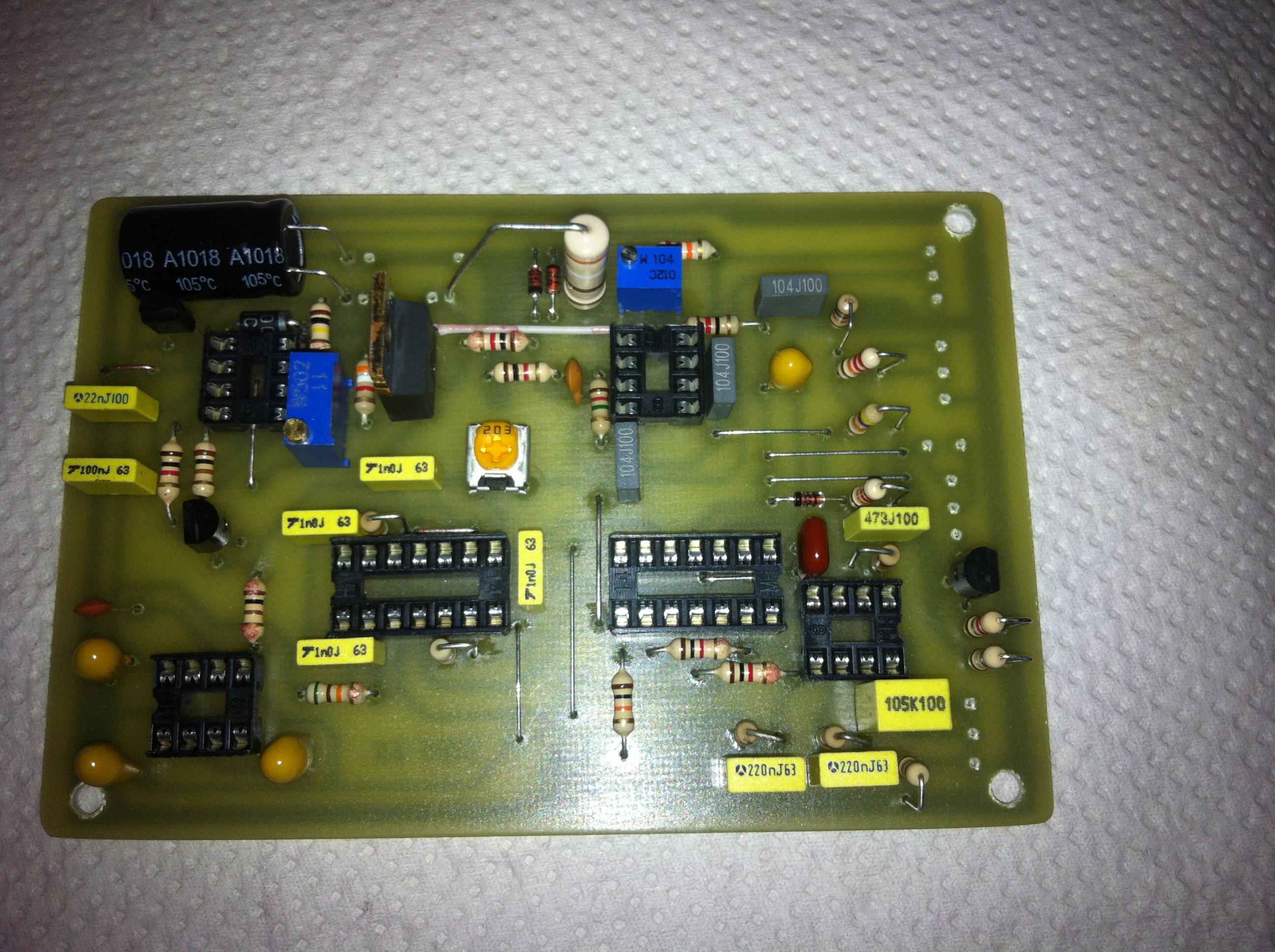

                  • Originally posted by TH Jim View Post
                    Hi Bernd,
                    Photo's of my board. Sorry they are not from the best angle but it is a real pain to remove the board from the housing, but should be clear enough for you to see. I wouldn't worry about the component body types you want to use - as you can see, mine is made from whatever parts were in my junk box and it works fine!
                    Regards, Jim.
                    What kind of caps are all these square yellow caps. I've never encountered them in parts stores here.
                    • Originally posted by scrungy_doolittle View Post
                      polyester film box capacitor

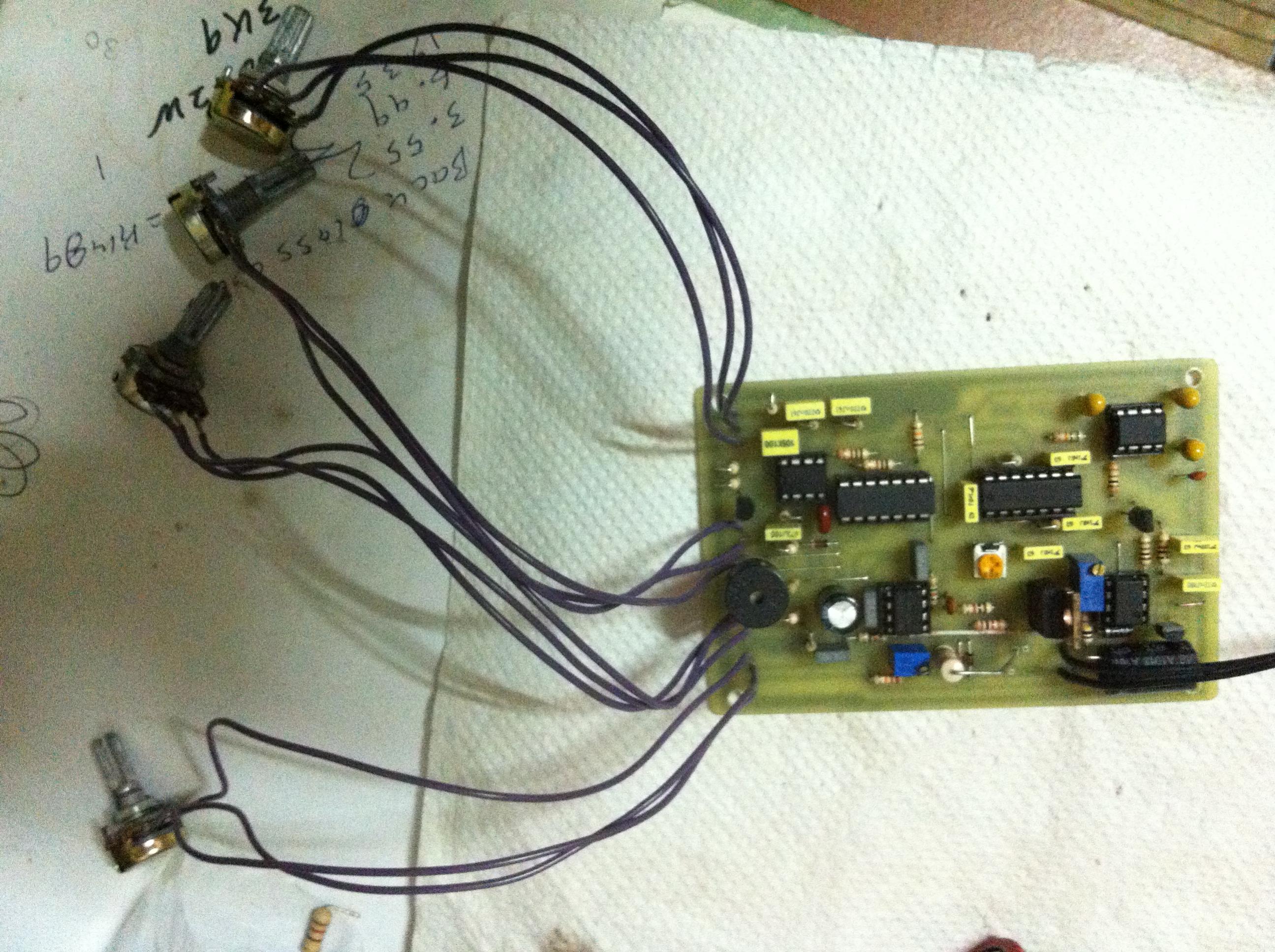

                              • Originally posted by paku View Post
                                SurfXX By Apberg
                                [ATTACH]32091[/ATTACH]
                                [ATTACH]32092[/ATTACH]
                                i have finish Surfxx and test this board is working but why IRF9640 Is Going Very Hot
