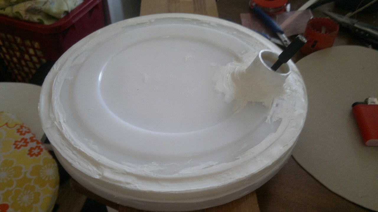

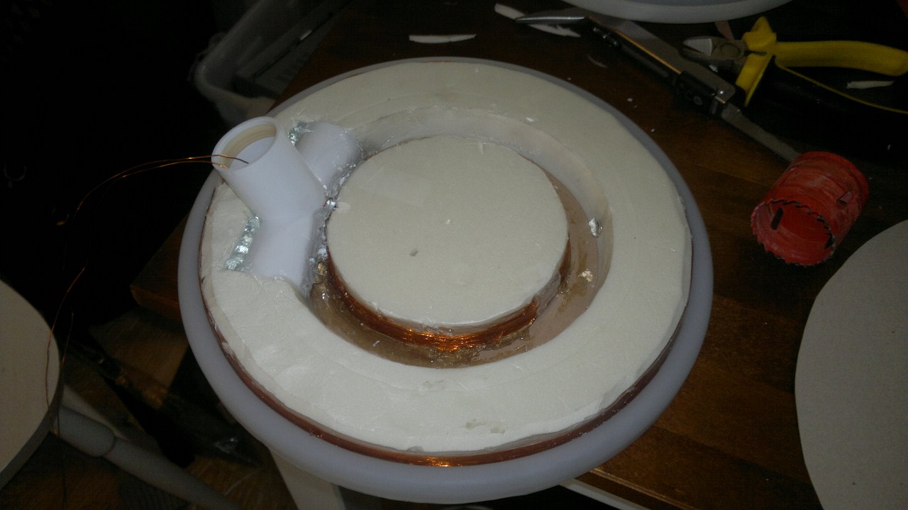

          Here is my double coil. Everything is attached with multipurpose construction clue and waterproof is made with silicone. Output is water pipe T model wich has rubber tightener inside and gives waterproof output.
          • #95
            Originally posted by Jeroi View Post
            ...and waterproof is made with silicone.
            ...which keeps water from entering a contraption but also keeps vinegar fumes inside (released by silicone), and not too long after your copper connections will surely corrode. I did this mistake some time ago with a balun transformer. The entrails of it were mostly disintegrated after only one season

              hello jeroi
              how is the performance of your detector
              have you tested your coil already?
              go on, looks good

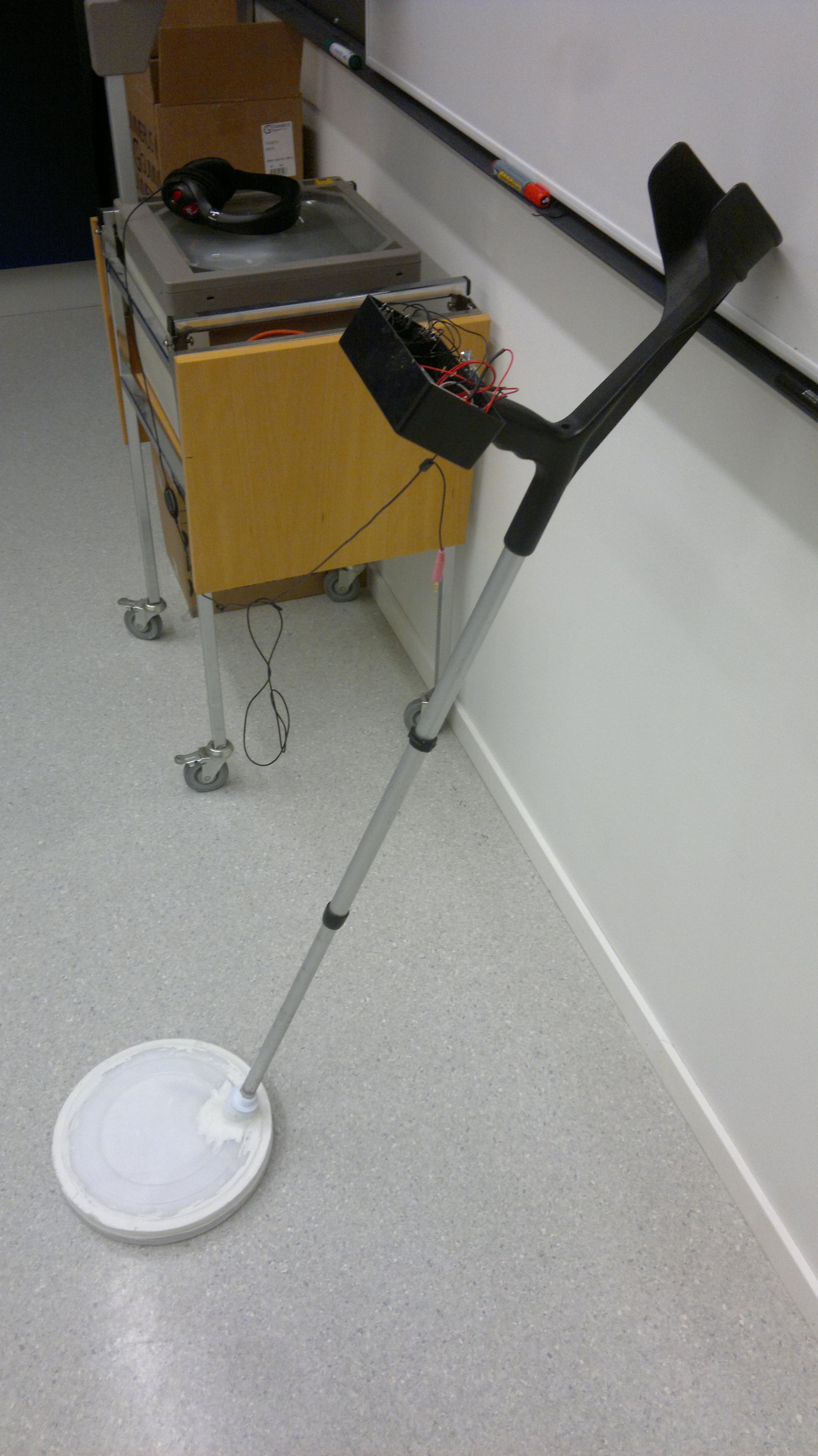

                Yes coil has aprox 40cm deep capability. I am going to build Surf-PI soon in couple weeks but at the moment I have the eti-561 circuit.
                • #98
                  hello
                  my video is here
                    Agreed!
                    • Originally posted by TH Jim View Post
                      Agreed!
                      There is a NON-Acidic Silicone Also Available.
                      • That one could do, but I'd go for hot glue instead. Works the same and its faster.
