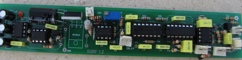

            There is 22k resistor feeding center pin of trimmer. Make sure it is properly connected on PCB. From supply voltage to center pin. Make certain that it is correct value.
            Can you put pics of your PCB. This could help.
            Your coils are good and not the problem. The culprit is on PCB.

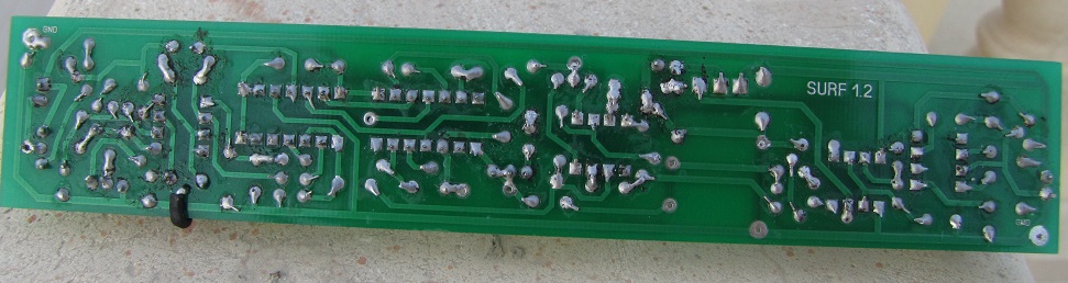

            • Thanks. I've checked three times the values and they all seem ok. One other thing i checked was Jose's advice to put 3k3 resistor on the 2N3906. However no difference. Will get some photos until it is not dark and let you know. After measuring again, the resistor R11 is 22k, 5,1 volt before, 4.3volts after(going to the trimmer). Meantime 5534 was replaced without result. Something else sort of bother me now. I think i mess up some zener diodes with my 4148. I start thinking i put zeners instead of 4148. They are too tiny for me to be able reading the markings.
              • Do not replace 1n4148 with Zener diodes
                • Here are the picsClick image for larger version

                    • I also advise you to inspect the solder side of the board very closely

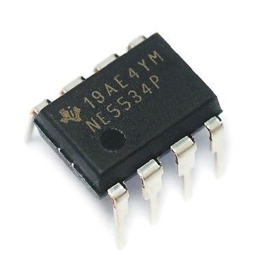

                        I you mentioned this, I have fake 5534 chips, offset don't do nothing. I will put photo of mine fake ones. When I replaced with genuine one, sensitivity was great. With fake chips, sensitivity was very poor. Something like what you are experiencing.
                        • O mighty god, this is what i should do at the begining. It will save me from two sleepless days off:-))). But as any human i was suspicious about my self. The fake one i heard of are with Texas instruments logo and exactly the same are the one i have in possesion.
                          I think tomorrow a visit to Dubai will reveal where the truth is.
                          Thanks again

                            • Originally posted by nonkapo View Post
                              Thanks again
                              Yes! My fake ones are Texas instruments logo!
                              My good ones are Phillips. Here is photo of good Phillips chip I used.
                              • Here is photo of almost same as my fake ones
                                The fake ones I have look like these except that they have the "U" notch on top as is normal.
