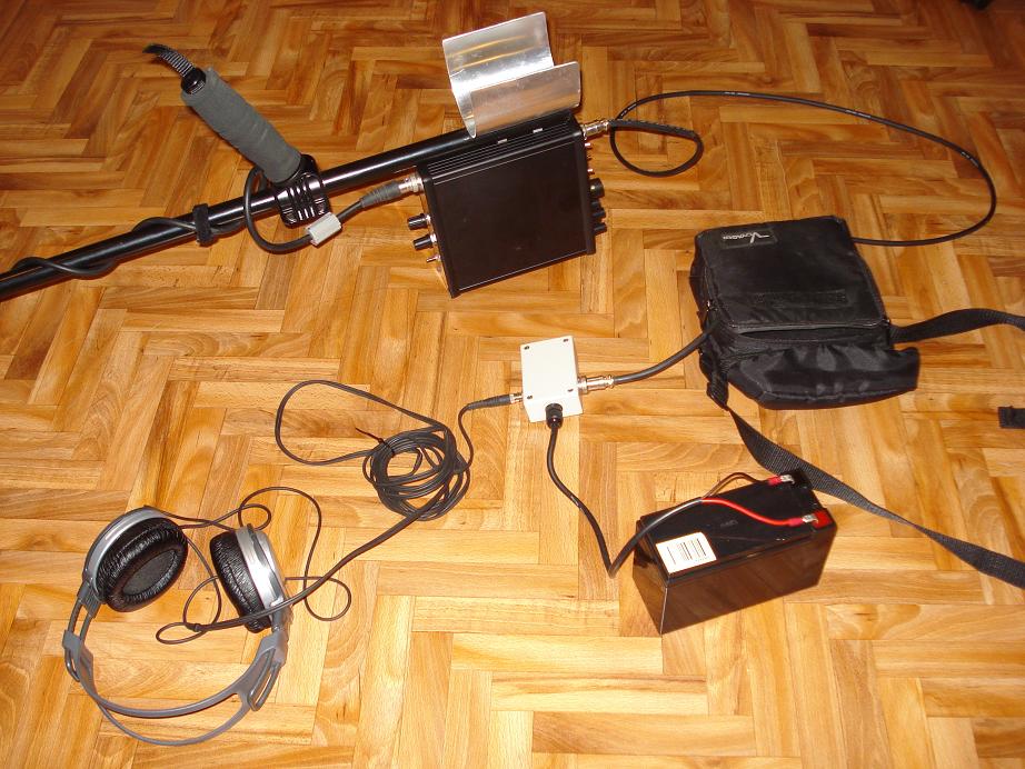

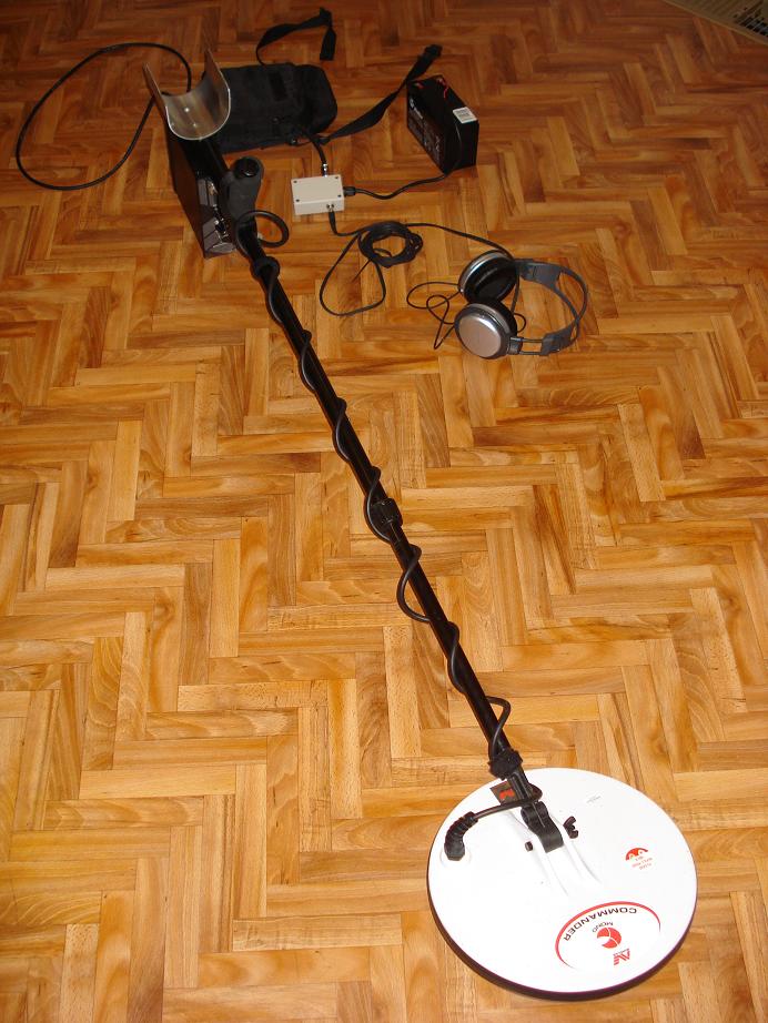

                              • #45
                                My finished project.
