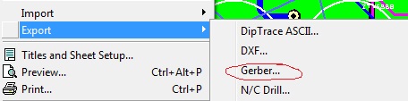

      Originally posted by ZED View Post
      Hey Detecto your version of diptrace is rather old mate,get the most recent version and it will produce gerber files.
      Zed
      Hi
      I am using DipTrace V 2.2.0.9 i think it is latest version published by diptrace, i can produce gerber files

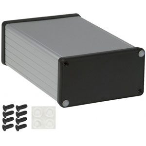

      It looks very good, i am planing to put detector in hammond case just a little bit less than yours, 16x10 cm with slots.
      Something like this
      Did you tested your SD2000?
