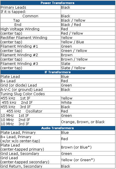

          -For I found another problem, the second transformer(red),Frequency determines from the color!!!!!

                        The sense of (RED)color determines frequency oscillator is available in the next to the variable condenser in the AM old radio .
                        -Such as picture.
                        ***This is clear from the components he uses the AM old radio-frequency.

                          The colour of the adjuster has no meaning, it's just convenient for manufacture to have different colours, it avoids placement errors, etc.
