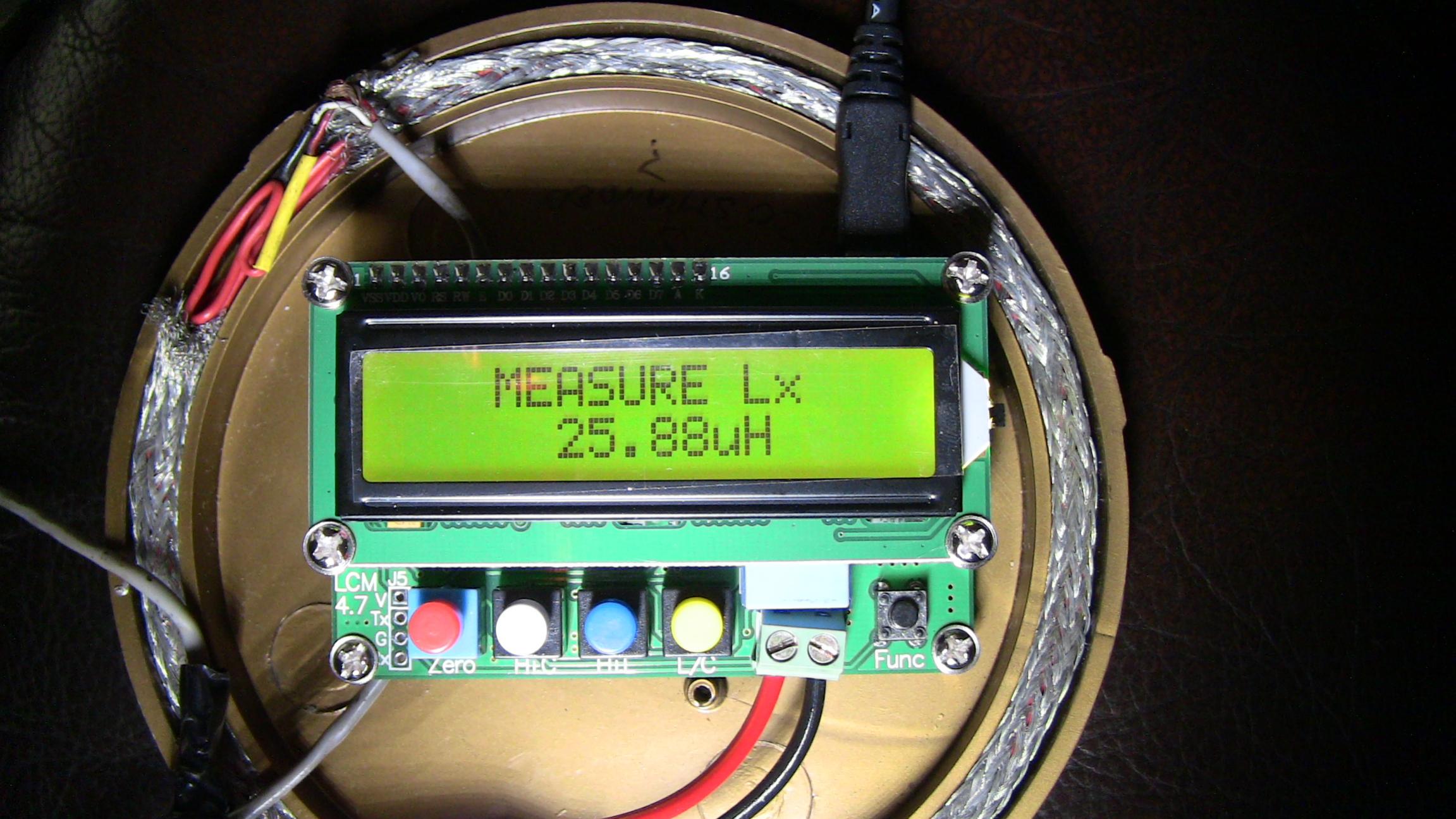

  • I had a spare moment, so I made my own copy of Hectors original search-coil. Tech details are: 10 turns of 16/0.2mm PVC insulated copper wire, with nominal circumference of 38cm, nominal diameter of 122mm. Heavy braided tinned-copper screen stripped from screened 6-core power cable, 10mm gap.. The 10 strand bundle was 6mm diameter average, and with the braid included, total diameter was 7mm. Measured inductance was 25.8 microhenry, with or without the shield connected to one end of the coil. This is exactly as predicted, which is nice. Construction was a bit tricky, getting the last 2 turns in was a slow process.
    • Originally posted by Skippy View Post
      Your timing (and build accuracy) is amazing!

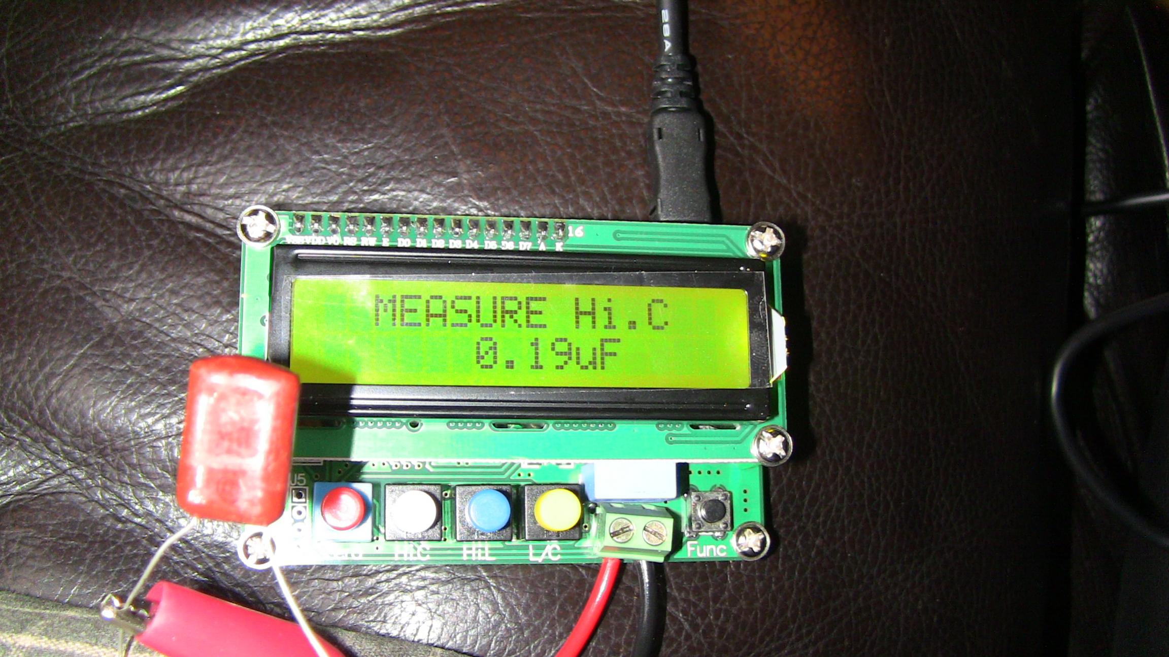

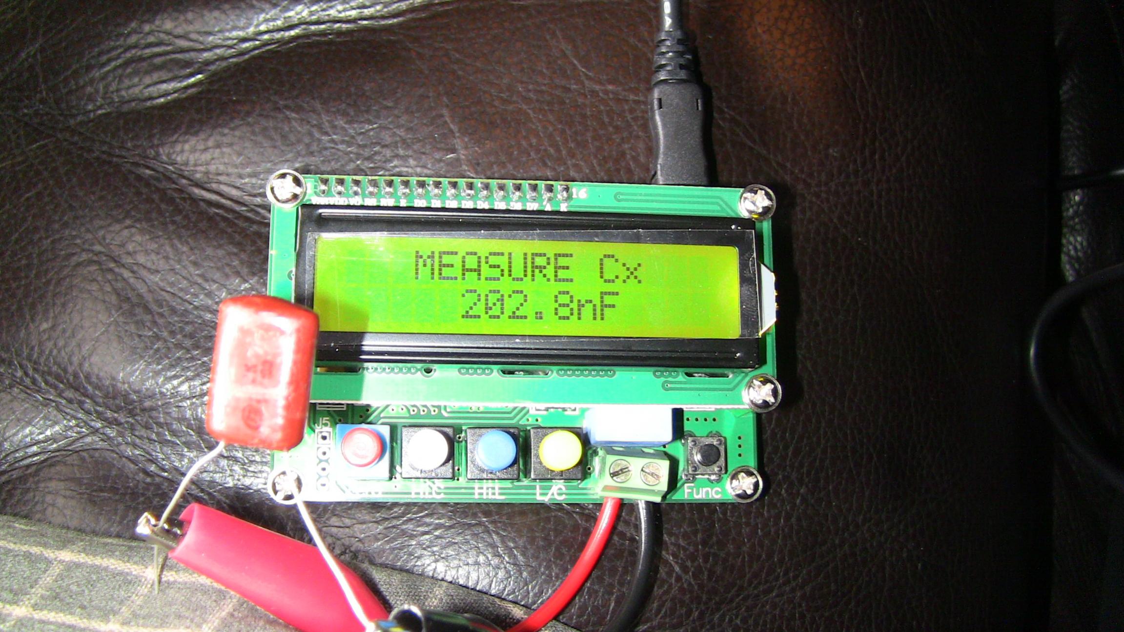

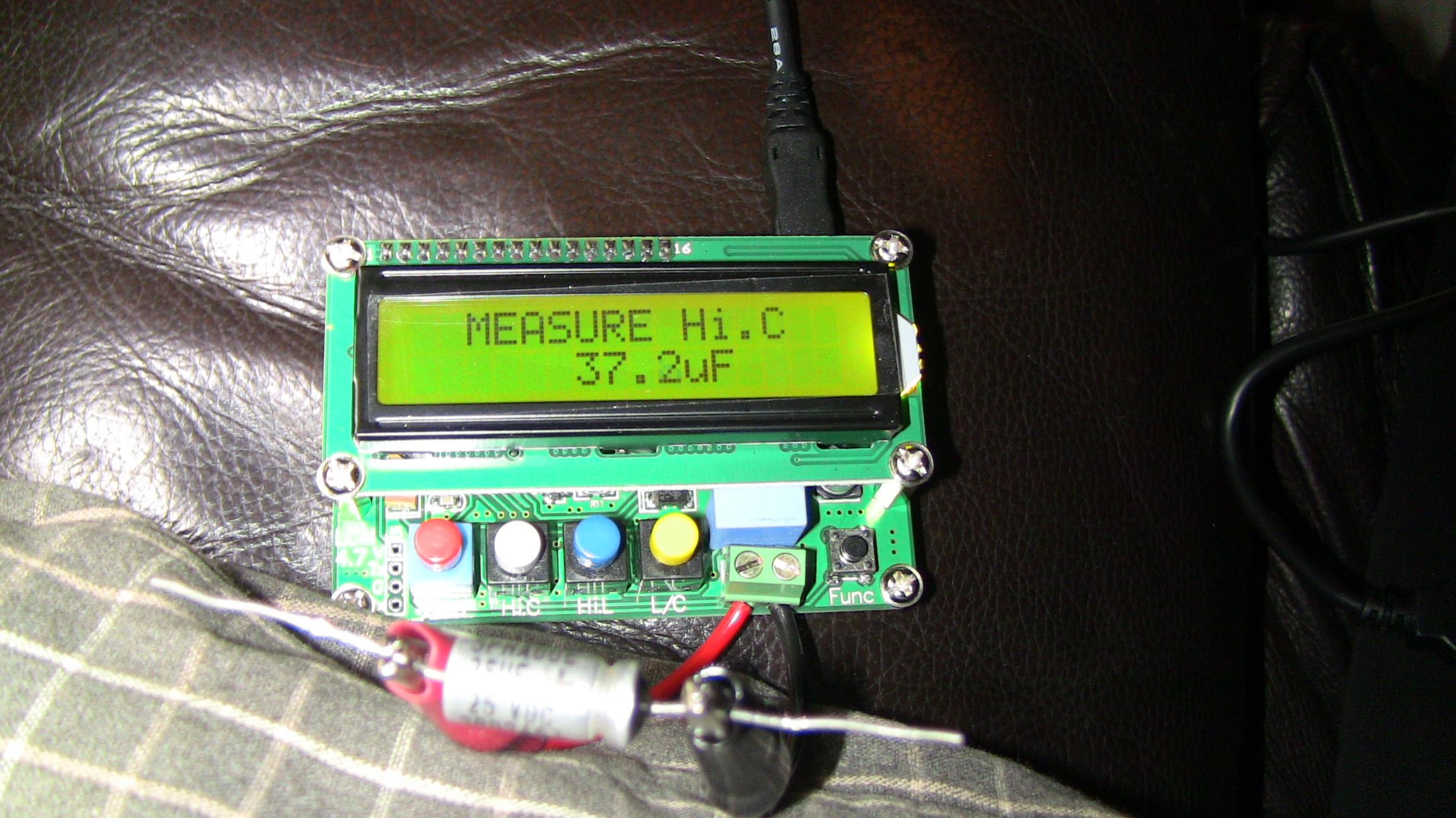

      Just got my new L/C meter from errr... OK China. Read some reports that it's accurate. Didn't want to give them any money but couldn't pass up $26 with free shipping.
      I'll pull the PCB coil and test it very soon.
      Wanted to test all 4 of my (Tesoro 4 pin) coils first, to include with the data in my 4 coil shootout.
      Thanks Skippy!

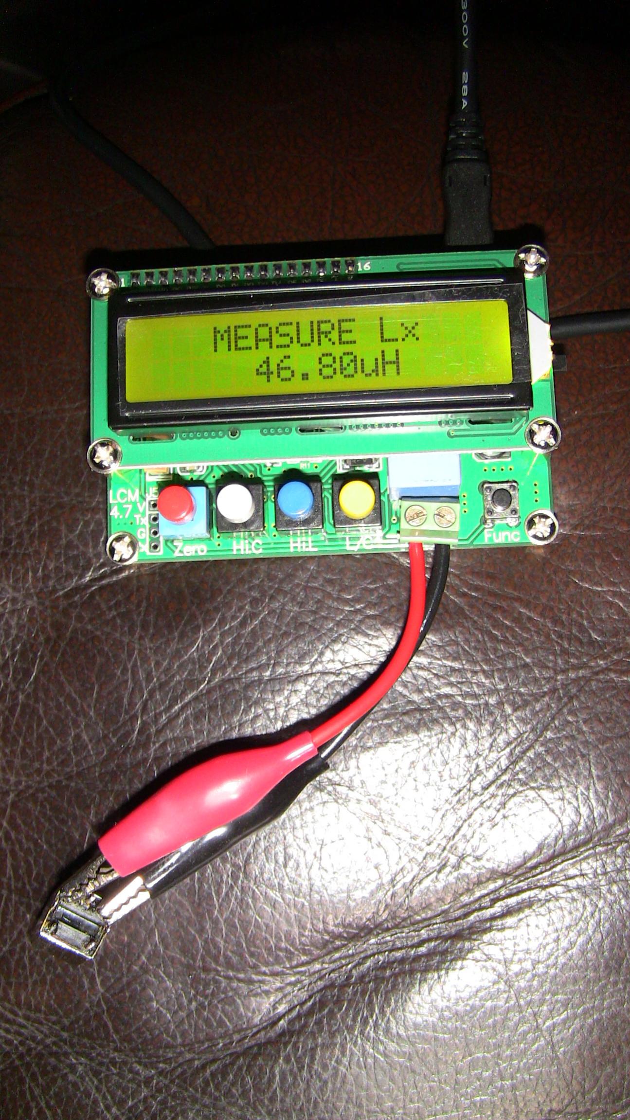

      • Hi Skippy
        The #'s are in!
        I squeezed the case a little and it varied from 46-48uH

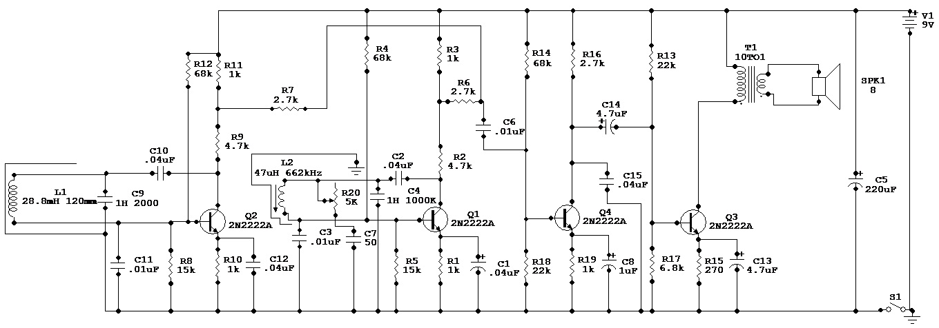

          Updated schematic.
          This should make a functional breadboard model

              Note:In the last schematic, the search coil is labeled mH and it should be uH.

                I think labelling coil in mH is ok (at least for classical BFO).
