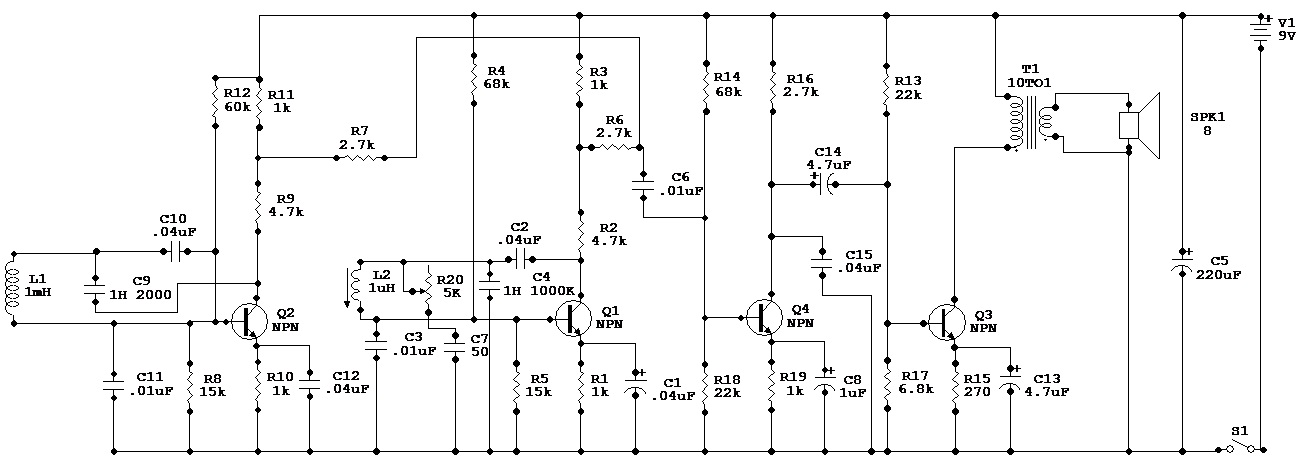

    Anybody know how to transfer ckt files from Circuit Maker? Was hoping one or more of you aces would be willing to snaz up that schematic

        It would be so much easier if I could present a ckt file so it could be manipulated within the Circuit Maker program. Otherwise, I may as well try to finish the updated schem myself, Thought one of you guys could do a faster, better job than me

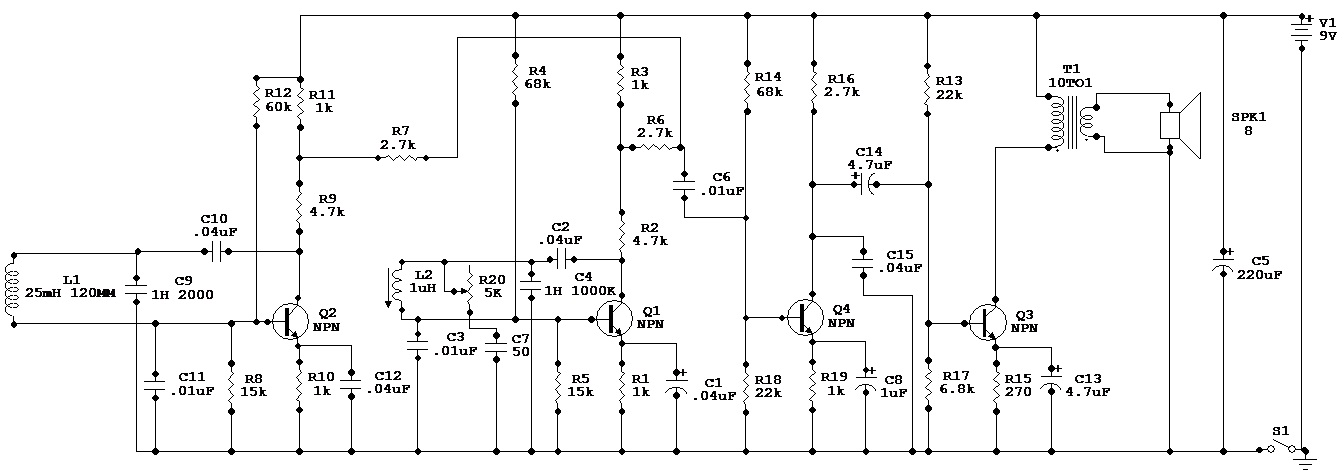

        • Originally posted by Gwil View Post
          Hi Hector
          It might be worth redrawing the circuit in this sort of layout, only neater and without any errors I may have added:
          Like this?
          • Hi HECTOR
            I hope you can say thank you to Gwil Because he gave shape and repaired some mis.

              Honoring an example of his layout is not saying thanks? Of course I can say thanks Gwil!

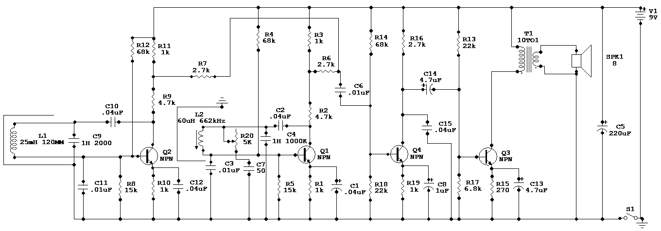

                • Spent some time correcting what I think are all the errors.
                  Has interest died on this? Is anyone going to play with it besides me?
                  This one here.
                  • L2 value incorrect, R12 value is 68K, screen on coil, and can on 10mm inductor not shown. It's worth pointing out that the audio output transformer doesn't need its output tied to 0V ground, it would track easier on a PCB if it were joined to +9V, I don't see why it couldn't be left isolated, either. I said I had printed datasheets for Toko 10EZ coils (Bonex/BEC/Cirkit catalogues), well I've found the same ones online recently, here's the link:http://pe2bz.philpem.me.uk/toko_coils/10ez.pdf.zip

                      • Originally posted by Skippy View Post
                        Thanks again Skippy and Jap!
                        Thought I changed R12 a long time ago...guess not.
                        Once this schematic gets approval by you guys, (it runs on the program now and even asks for more info to display waveforms) then I would be happy to try any mods that you see fit on my working unit.Click image for larger version

                            Wouldn't have made the much more logical and easier to read transformation without Gwil.
                            My original rendition was a top view actual layout. That's the only way that I could come up with to trace the circuit and keep track of things while doing it in multiple stages.

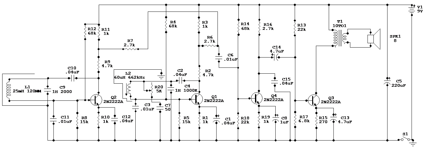

                            • Cut the trace that connects the audio transformer to common ground and moved the speaker wire to the isolated lead. No noticeable changes.
                              Changed Q1 with a 2N2222 metal can type. No noticeable changes.

                                Changed all transistors with 2N2222A with no problems.
