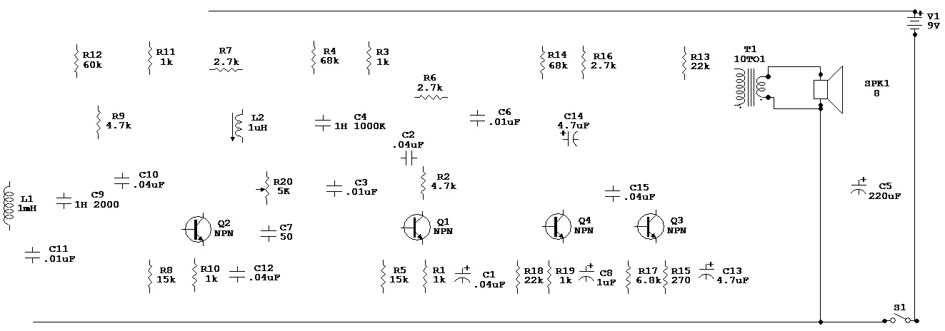

    I wonder if now is the time to think about 'modernising' and improving the circuit. I think adding some high-frequency power rail decoupling would be worth doing, such as 47nF from 9V to 0V. The non-standard (today) 0.04nF ceramic caps could safely be replaced by 47nF ones in all locations, I think. C7 could be replaced by 47pF, assuming the '50' means the cap is 50pF. Quick calculations suggest that adding 50pF in parallel with 2000pF will cause an audio output shift of 17KHz, which seems a bit excessive. I wonder if C7 may be 5.0pF? This would then give 5KHz shift, which is more sensible. Maybe this detail is one to sort out later. Anyone think that R20 (pot) and C7 should swap positions? Then the pot wiper and one fixed end could be grounded, the other fixed end going to C7.

      -(today) 0.04nF ceramic caps..... rong its 0.04uf=40nf safely be replaced 47nf ....ok
      -I think. C7 could be replaced by 47pF, assuming the '50' means the cap is 50pF....ok its C7=50pf =~ 47pf.
      -- There is an error in connected R20

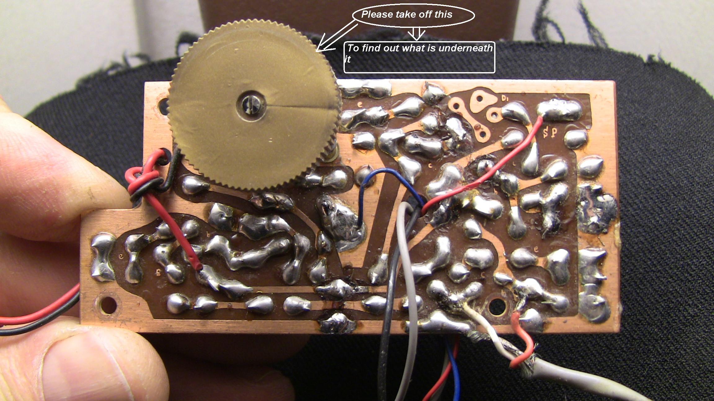

          The screw must be seated with thread lock. It won't budge.
          It is a 5K switched pot on metal, grounded standoffs. (they serve as the switch)
          There are no hidden circuit traces underneath.
          I double, double checked the R-20 connections. Can't find any errors.
          I didn't show the R-20/switch combined because CircuitMaker 6 Student doesn't have that option. This is also the first time that I've used this free online circuit design program.

            It looks like the detector was copied from a Jetco Mustang. I traced one about 40yrs ago when I was in high school. I still have that drawing somewhere.

              I looked it up online and the description sounds dead on. There's a pic of the back of the PCB too. I think that with a modified coil and some love from the Geotech crew, it would make a nifty pinpointer. Maybe put an LED ladder on it for those who don't want to hear it whine?

                Speaking of LEDs etc, I was wondering if the two missing components next to the audio transformer might be for a meter or LED connection? Looks like one part is a diode (it's labelled on the PCB), one maybe a resistor, with some other device wired in to the PCB.

                  And the one missing components next to (T2)10mm transformer maybe a resistor or
                  ceramic capacitor.

                      • Why is R12 still shown as 60K? Obviously, we don't have any views of the components that enable us to see this part, but it has to be something different, like 68K? Maybe the colours have faded or something, I suppose you could ultimately remove one leg and measure it with a meter.....
                          I think ferrite cores are unsuitable for BFO coils, they are very temperature sensitive. A suitable size for an air-cored coil,to start with is 35 to 40mm diameter. I suggest you take a look at the Scarborough EPE magazine mini-pinpointer design for ideas. I've made a 35mm coil for that, with self-adhesive foil screen. It would find a 25mm copper coin at 30mm distance.
                          http://david.alfa-romeo.eu/elektro/EPE/2003/EPE%202003-07.pdf
                          R12 is a 68K (65.5 to be exact)

                              • I've just had another study of my Toko datasheets, to pin down construction details of the 10mm can inductor. Though Hectors coil is not a Toko coil, I think it will be similar to Toko's 10E and 10EZ range, commonly used in 455KHz IF stages in radios. The inductance of these cores is determined by the number of turns and the specific inductance,AL (big A, little subscript L).
                                Inductance = AL x (number of turns)squared
                                Analysing the data for a number of these coils, it seems that AL is close to 25 nH for the 10E core. From this, to make a 60 microhenry coil for this project, we need 49 turns of wire. Commonly, 455KHz coils/transformers will have around 170 turns, so it should be possible to salvage enough wire to rewind them for this project, but Q would be improved if slightly thicker wire were used, or you may be able to rewind the original wire bifilar. These cores have a wide adjustment range, possibly +/-20%, so number of turns is not too critical.
