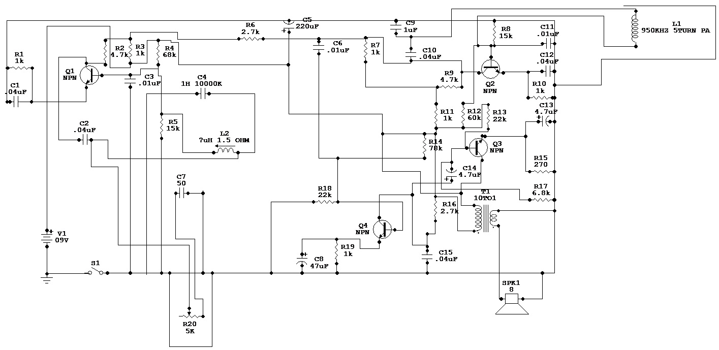

    Based on the search-coil details, I estimate it has an inductance of 6600nH / 6.6uH. It resonates with caps C9,C10. If C9 were 1nF (can you find out what it is, Hector?) that would give a resonant freq of 1.9MHz, which seems way too high. If C9 were 10nF, the resonant freq. would be 680KHz, which is close to the measured reference oscillator freq of 662KHz, which would actually make sense. However, Hector measured the operating frequency of the detector as 75KHz, so I'm unsure of what frequency anything runs at.
    I'm also puzzled by the 10mm transformer connections, surely pins 4 and 2 (and 6) must be joined internally to something?
    I don't remember saying 75KHZ.
    The operating freq measured at the SEARCH coil leads, with the threshold at a low hum, the freq was 662KHZ. 659-665KHZ Varies with thresh control.
    When I tested the stand alone search coil with a sweeping sine wave and monitored it on the scope, the voltage doubled when it hit 950KHZ. If I swept it just a little either way, the voltage would quickly drop.
    I'd be fine with taking the Tokyo coil out to test it again, if needed.
    My test gear is mostly for audio. Is there a test we can do with an oscillator and a scope?

      Well it seems that either your Schematic is Incorrect or your Resistance readings are incorrect.
      And does that T1 have a PART Number on it?

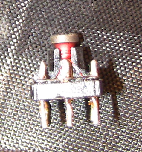

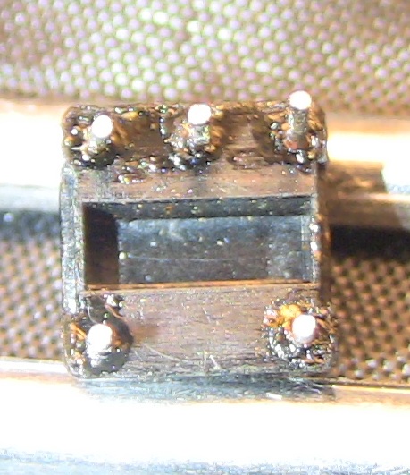

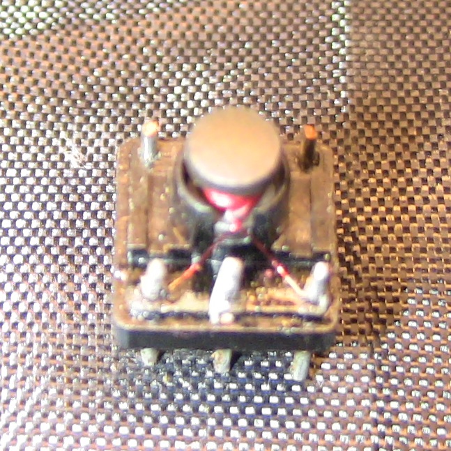

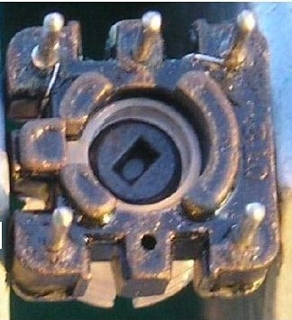

                  • #69
                    Well, this just simplified things X100!
                    A single 1.5 ohm coil.
                    Look at the pics and weep! (and laugh)
                    Who would have known!
                    A single coil with a movable slug. What's that called??? Adjustable choke? Is it still a transformer? I think not. Very tricky indeed
                    Time to move on with ease
                    • #70
                      I have to admit I was wondering if they had used the same basic circuit for both oscillators, when I saw the polystyrene capacitor/ 0.04 ceramic cap combination used in both circuits. Might we guess the 10mm coil and the search-coil are basically the same inductance? If the 10mm coil is only 5 - 25 microhenry, there won't be many turns on it. They typically have 100 - 150 turns of wire in 455KHz IF coils, with several hundred microhenry inductance. There's possibly less than 20 turns on this one. The internals of the coil are classic 10E / 10EZ type. I've just looked at my Toko data, it's probably around 15 turns on that core.
                      • #71
                        Variable chokes like that are fairly common.
                        Now its time to Correct the Schematic.
                        • #72
                          Yes, I do believe I've achieved success!
                          It runs now with no errors.
                          I'll double check the values. It's been a long time since I tried to read color bars on resistors. I usually stick a meter on them to avoid errors. I'll do that . Caps get me sometimes too.
                          • #73
                            There's an error in the R7 connections, it doesn't connect to C10. R12 is likely to be 68K, by comparing to the other oscillator. C9 value, is it 10nF?
                            The two oscillators are almost identical, the freq shift of the reference one is done by bleeding in a variable amount of 50pF cap in parallel with the 10nF oscillator cap, giving around 2KHz frequency shift. Q4 is the mixer, it appears to be linearly biased, but it is evidently driven hard, so it saturates and the non-linearity does the mixing. Cap C15 filters out the high frequency component, leaving the mixed audio, which goes to the power amp Q3.
