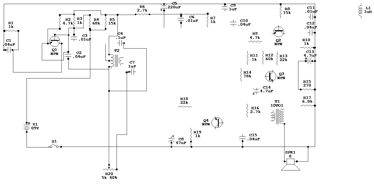

      I've already learned and refreshed a bunch of good stuff by starting this project.
      It's been well over a decade since I traced out a circuit to make a non existing schematic. My hand drawn version is not presentable so I decided to transfer it to a circuit design program and plot it out nice and pretty. I'm using circuit Maker 6 Student.
      My hand drawing is done, the components are all numbered, values marked and listed. The drawing transfer should take another day or so.
      Thanks to all you guys for the informative responses!
      I'm thinking that the adjustable ferrite core transformer was just the easiest way to make a centering adjustment for the threshold. (only external adjustment) on/off and threshold are combined onto a single pot/sw.
      Refreshing old brain cells is fun!

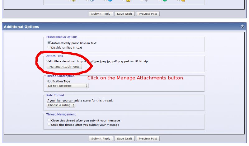

        Man! This is harder than I thought it would be. I've never done this on a computer before. Getting the hang of it. How do I get the image from Circuit Maker 6 Student to be transferable to a site like photobucket? How do I get the image to show here?
        I have the components all layed out, values listed, poles oriented. I just can't show what I've done so far.

            The pic shown is not the completed one that I thought it was. I have all the transistors figured out but not the 10mm ferrite core transformer/adjustable coil. I think it's 5 lead with a center tap on one side.
            All that's left is to interconnect about 2/3 of the remaining circuit on Circuit Maker 6 Student. (and figure out how to get it to show here)

                Don't worry about putting the image on PhotoBucket. Simply scroll down the page and select Manage Attachments. You can then add an image to your post on Geotech. Please take note of the maximum file sizes.

                      Got the file saved in Paint but it goes away when I try to post.

                            Maybe one of you guys can finish the interconnections before I do.

                                My gut feeling is the transistors will all be pnp type. And you've shorted two legs of one transistor together, by the way. This may help us check your 'handywork', looks like the transistors have b,c,e marked on the PCB:http://i777.photobucket.com/albums/y...squirt/017.jpg
