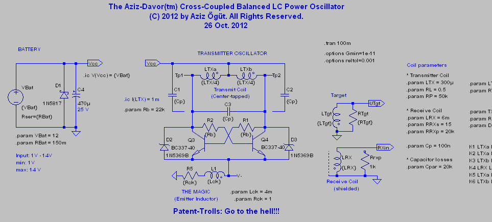

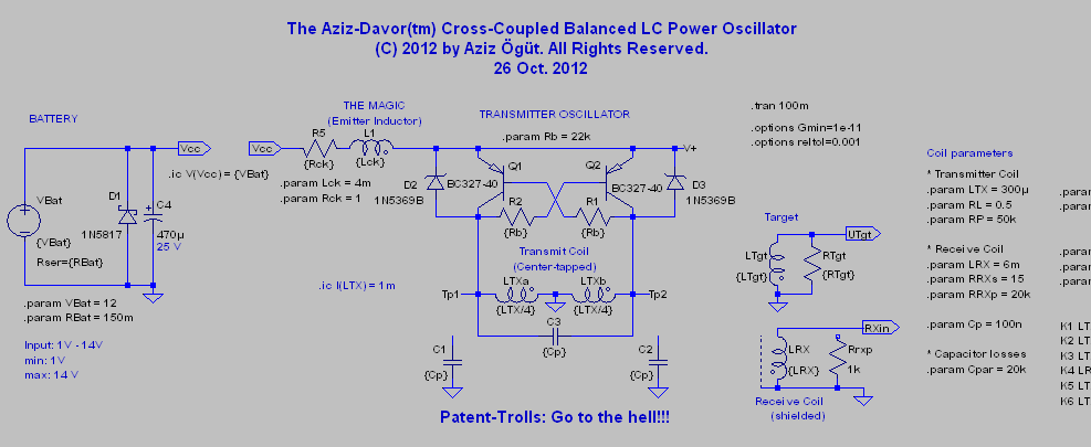

    • Ok, sorry my bad. The circuit gets better with better high voltage protection of the transistors.
      Remove the zener diode in the circuits above and connect two zener diodes to emitter-collector connection of the transistor (each transistor needs its own zener diode). Select the zener voltage so, that the maximum voltage of the transistor doesn't exceed the specification limit.
      Another issue: Start-up of oscillation. If the oscillator doesn't oscillate, we can bias the transistors with slightly different resistors. That requires two additional resistors however.

      • See below, what I mean with the zener diodes. But select appropriate zener diodes (39 V for instance).

        I personally like the PNP-variant as the coil voltages and center-tap is referenced to GND.

          Don't tell me them there diodes ( D2 & D3 ) are in parallel with each other!!

            PJ,
            no, not connected parallel of course.
            Each transistor has it's own voltage protection zener diode (same type).
            That was the reason, why I have updated the schematics to avoid misinterpretation.

                I don't know, what you are smoking PJ. Can I have the same $.hit?
                I need two zener diodes, so each transistor is protected during the start-up process. In a normal operation, the zener diodes shouldn't break down. If so, take high voltage rated parts or reduce the supply voltage.

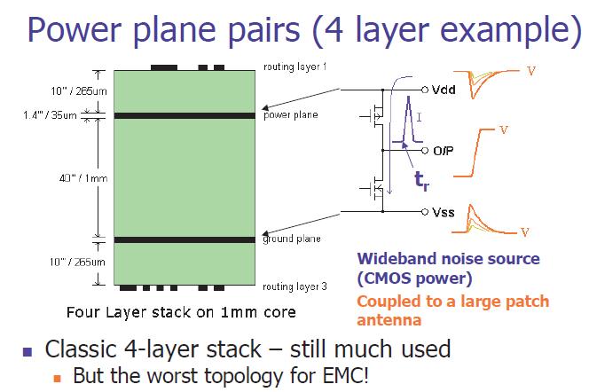

                          errr ... actually PJ is right ... some multilayer topologies are particularly bad for radiating harmonics ... esp 4 layer.

                            If we would have a DC current path, then we would have connected them parallel through the coil. But the magic(tm)(hocus)(pocus) in the circuit is producing an AC voltage supply for the oscillator (half sine waves).
                            I hope, that the "parallel diodes" cause enough imperfections to the circuit, so that the oscillation can start. In normal operation state, these parts are becoming parasitic capacitances. But they are very important to protect the circuit (transistors) at the startup process.

                              If ANY board is poorly designed then their can be a multitude of problems when its populated! But PJ made a blanket,unqualified statement and unlike you has never provided any explanation!He made it in connection with the QED inferring that the QED had harmonic problems because it used multilayer boards on 1 REV. This was and is completely untrue!

                                A 4 layer board with NO power plane will be much better.
