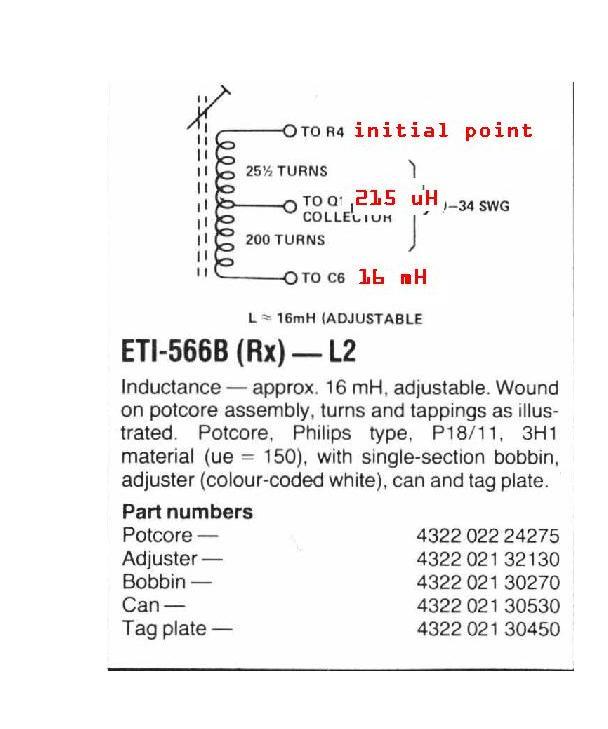

        Originally posted by Baterista View Post
        If you are referring to the L2 (receiver). The scheme is the same winding suggested above;
        225 1/2 turns
        1 step initial point
        2 step + 25 1/2 turns - 2.20 uh
        3 step + 200 turns - approximately 16 mh.
        Measurements taken with the coils inside the potcore.
        There is also the "adjust" for the potcore, as may be seen in the image.
        [ATTACH]21946[/ATTACH]
        detail
        [ATTACH]21947[/ATTACH]

        • #64
          Originally posted by fmnotes View Post
          Hello
          I have constructed this detector,
          The transmitter all good
          The receiver does not work.
          The inductors have values ​​mH asking the construction
          I just used potcore 23x17 approx.
          Do you think that this creates the problem?
          Can you send me how much is mH
          ie coil rx l2 to R4 to Q1 mH or μΗ ?
          To Q1 to C6 mH?
          Thank wait your answer.

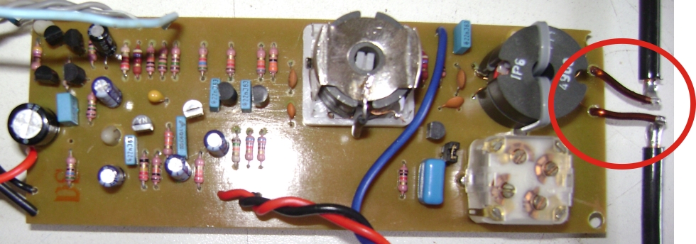

          Hello fmnotes, the potcore should not be the problem.
          The Rx coil L2 has the measurements as shown in picture.
Name:	coil Rx L2 eti 566.JPG
          First check the welding wire in the loop antenna.
          I had problems with it.
          What were the transistors you used?
          • #65
            [ATTACH]25552[/ATTACH]
            [ATTACH]25553[/ATTACH]
            Hi and thanks for your answer.
            They're using the prototype pcb and transistor bc549c, bc559b, bc639 and bc640.
            germanium transistor self is used in the transmitter AC131.
            Use signal generator starts from 100kh to 0.0 kh and the receiver gets nothing.
            measuring coil.
            total 16.18 mH
            R4 TO Q1 209.5μH
            I can not figure out my mistake.
            • #66
              eventually all good with construction.
              Works excellently.
              only if you tell me the performance of this machine.
              if you've tried it of course.
              Thanks again Baterista
