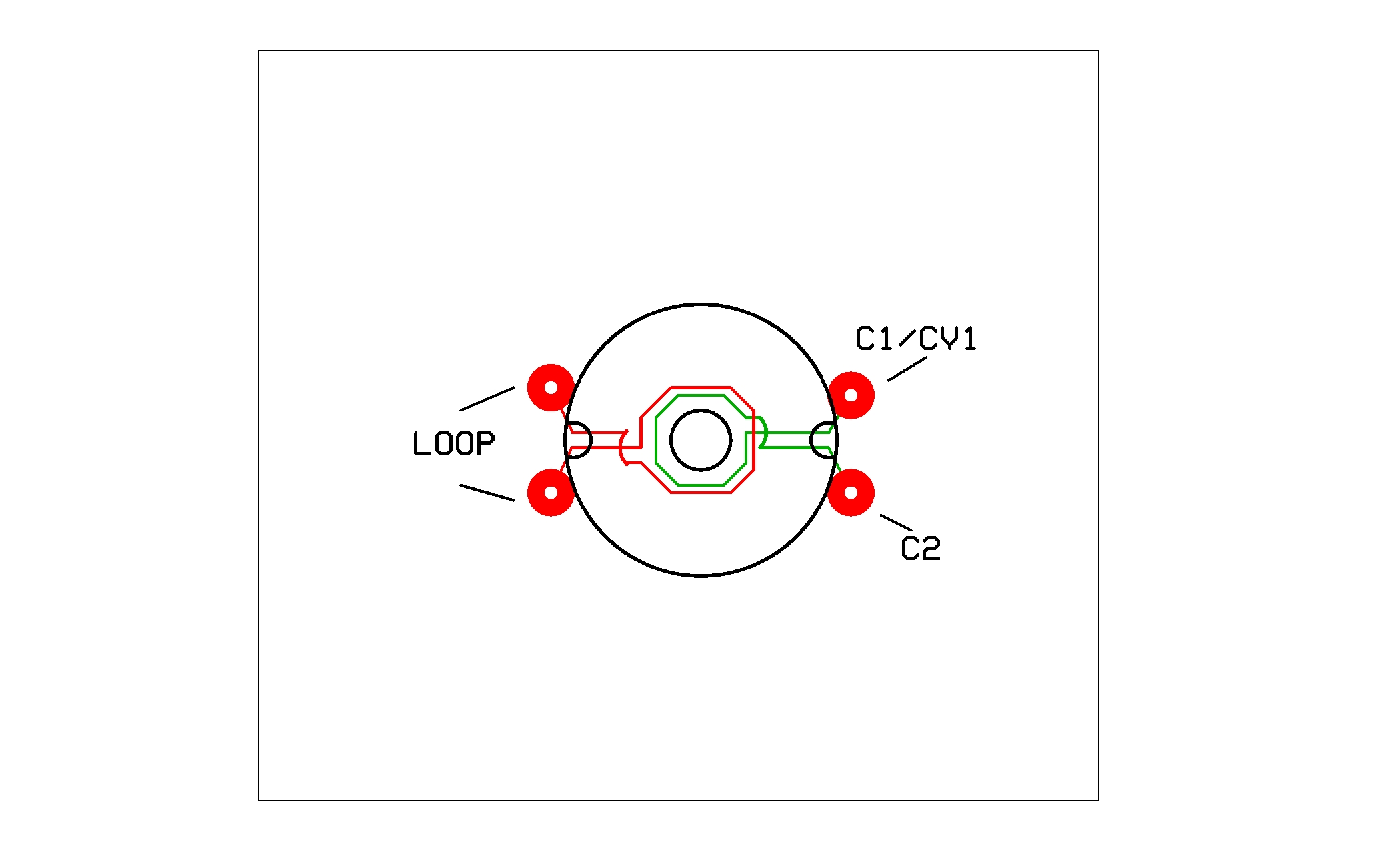

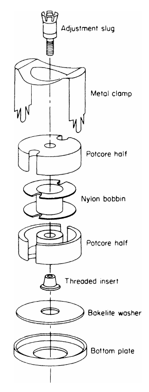

    Hi Baterista,
    Can you post detailed pictures of the pot cores (Rx - L1, L2 and Tx - L1) you are using ? According to article , L2 is a single-section bobbin and has adjuster (color-coded white ??) while other two are two-section bobbin. I probably got only single-section bobbins for all three and my adjuster slug doesn't fit as per following diagram.
    • #47
      Originally posted by mindfree
      Hi Baterista,
      Hello, the coils can be single section, no problems, the "adjust" of white code, according to the datasheet Ferroxcube (Philips) is for low or medium setting adjust, make sure there is a adjust of the brand you are potcore using.
      I utilized the brand Potcores Thornton (made in my country) in size 23/17, they do not produce the size specified in the original design (18/11), but this is not a problem, the most important is that it has a "ue" approximate of original.
      The winding shall be a huddle.

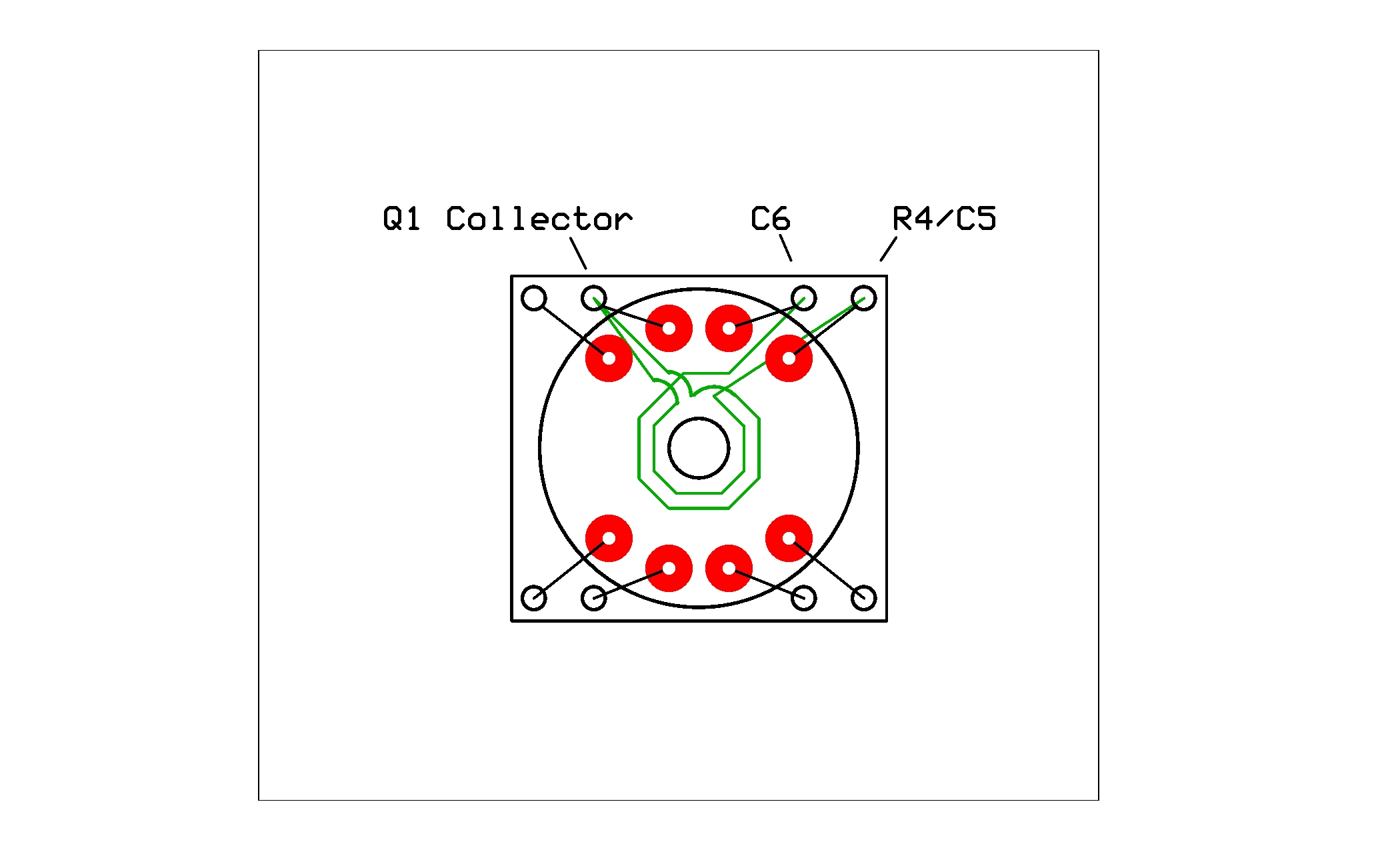

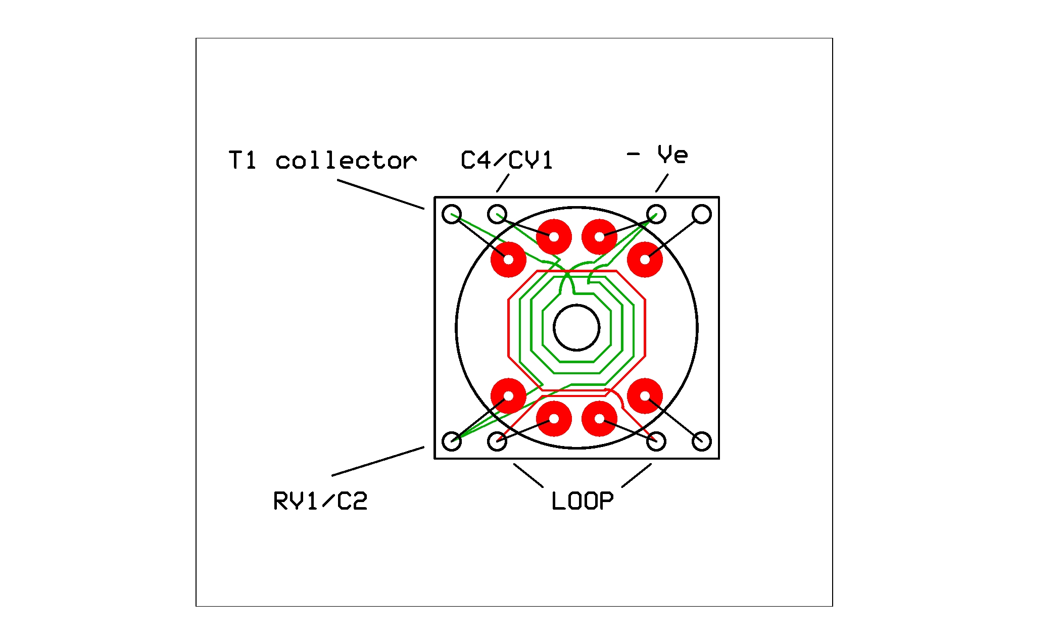

      Maybe these pictures help.
      L1 Transmitter.
Name:	L1 Transmitter.JPG
      L1 Receiver
Name:	L1 Receiver.JPG
      L2 Receiver
Name:	L2 Receiver.JPG

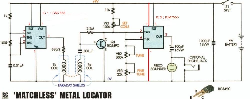

                    • #55
                      Hello friends
                      In eti549 ic (ICM7556IPD) can replaced by ICM7555...
                      • #56
                        There is no ICM7556IPD in ETI 549 that I know of.
                        • #57
                          Originally posted by mahavir View Post
                          Hello friends
                          Hello mahavir, Davor is correct, there is no ICL7556IPD in ETI549, by chance you refer to the project "Matchless Metal Locator" by Thomas Scarborough?
                          http://www.geotech1.com/pages/metdet/projects/matchless/matchless300c.pdf
                          If so, the ICL7556IPD in question is a double ICL7555, you must modify the schematic and PCB layout.
                          • #58
                            I am so sorry friend..
                            Now am making matchless metal locator
                            But I can't get ic ICM7556IPD so I want to replace by ICM7555.
                            Then the signals may change or not...
                            Thanks davor and Baterista....
                            • #59
                              • #60
                                Hello mahavir, try this (see picture). Use a breadboard and report the results.
