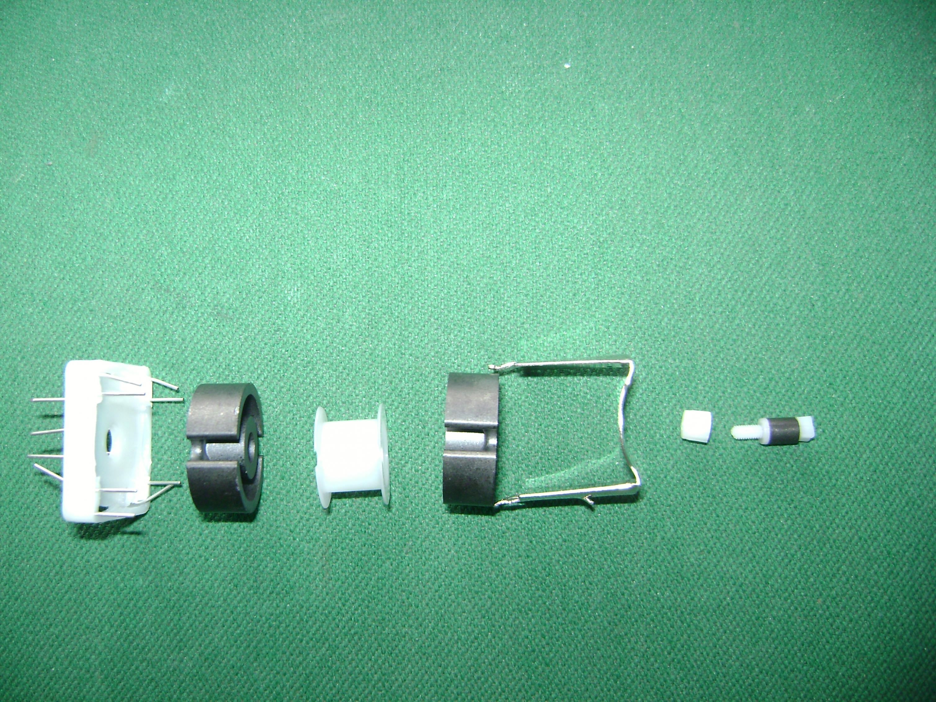

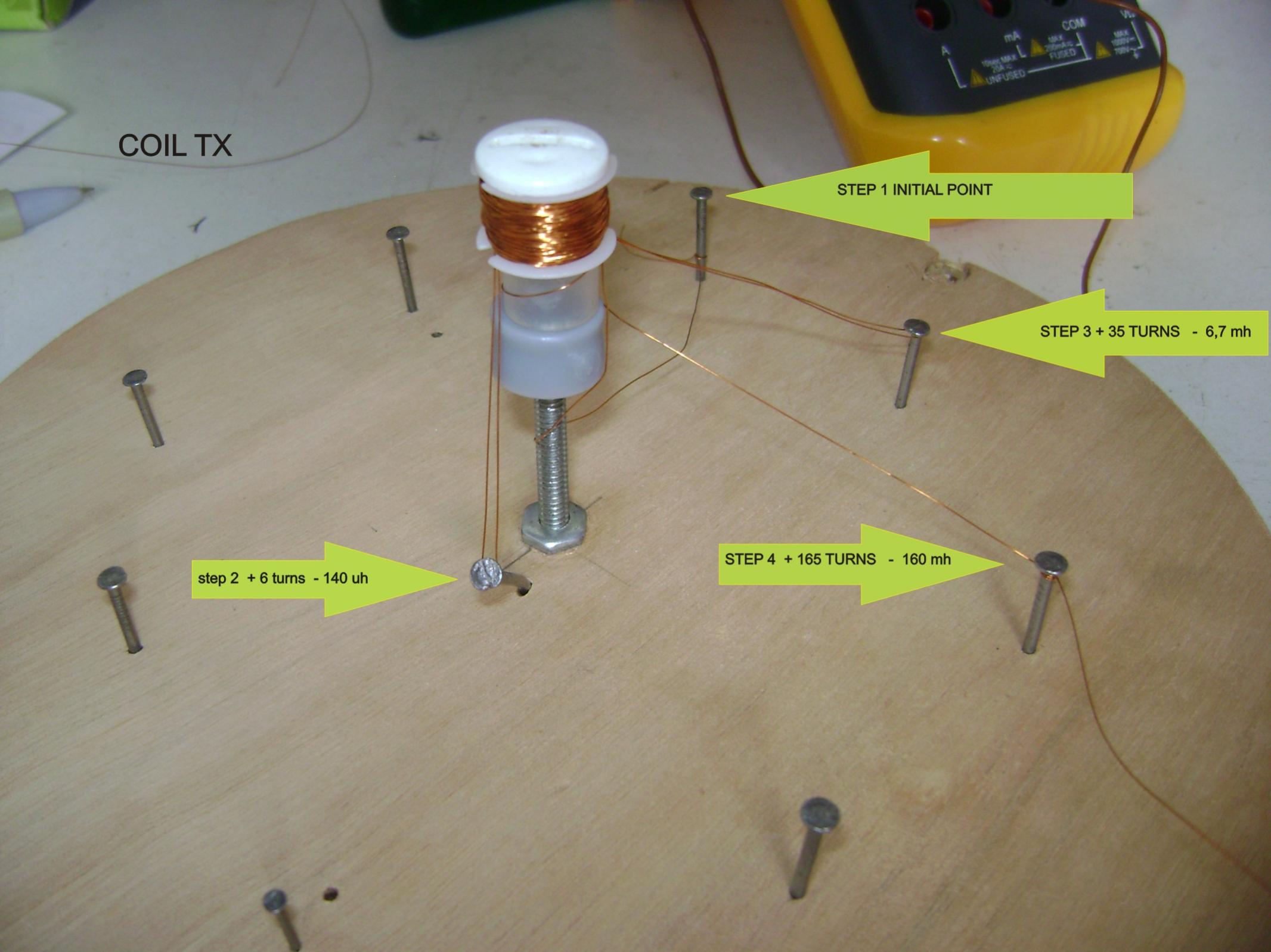

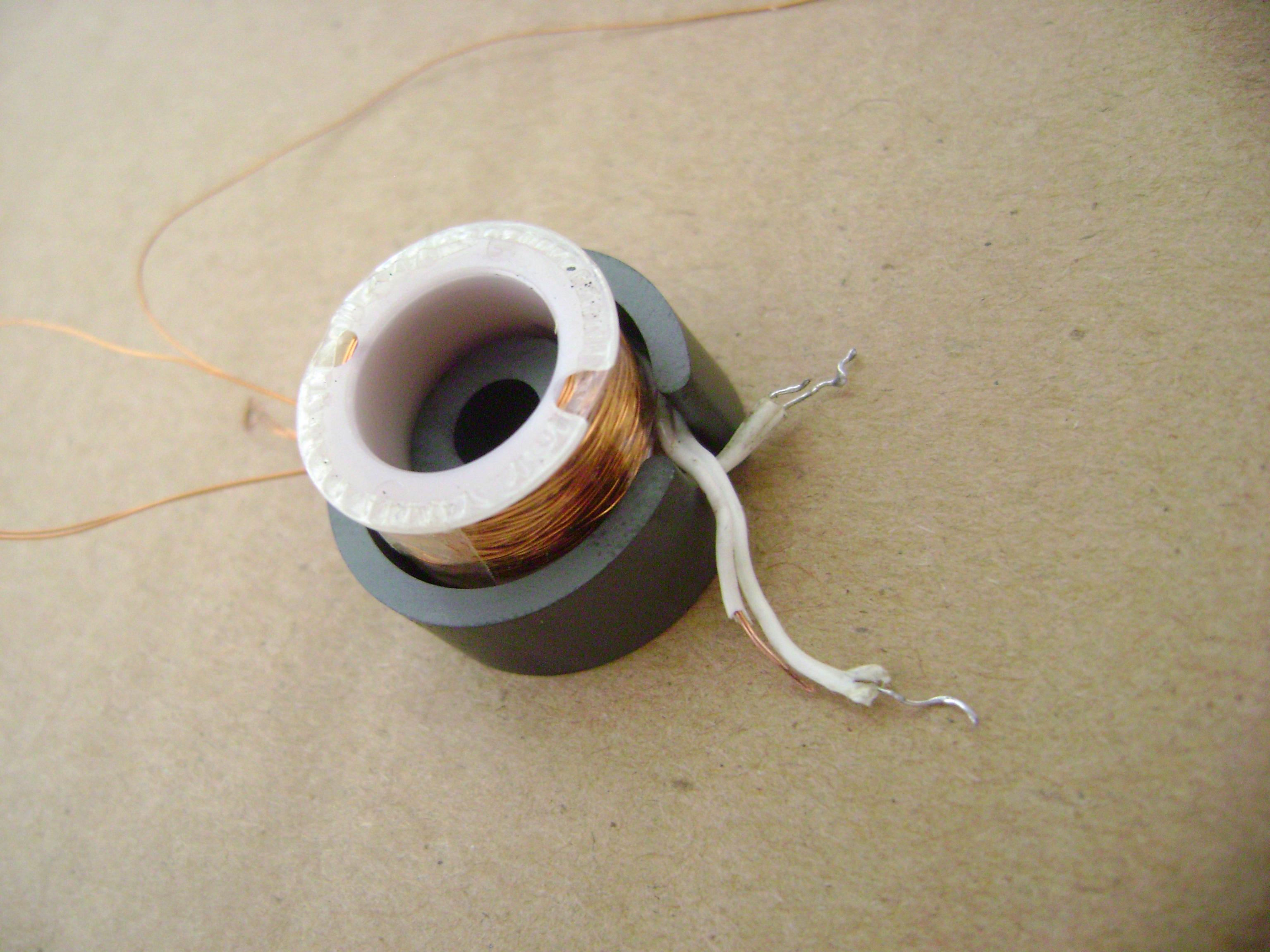

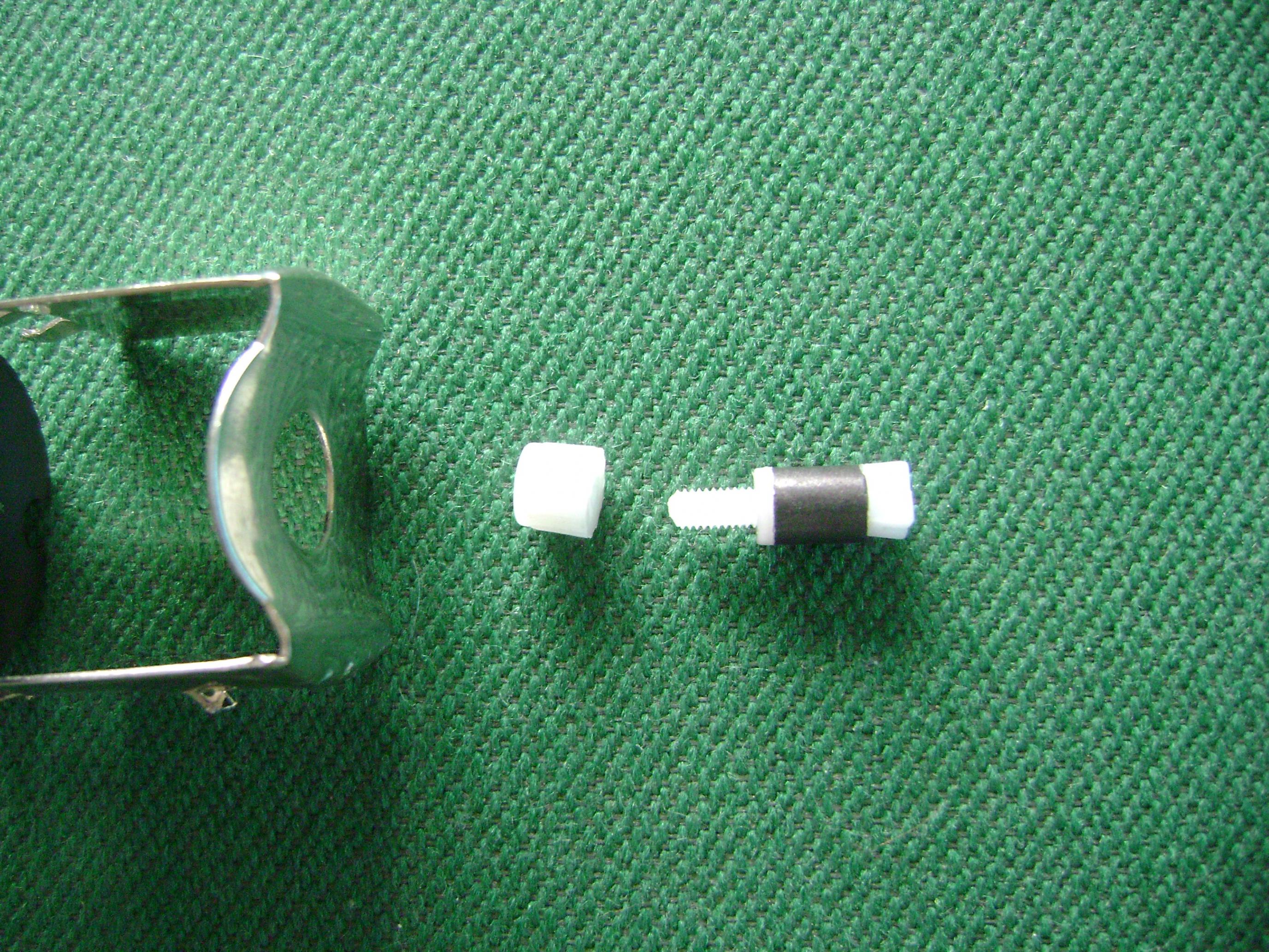

If you are referring to the L2 (receiver). The scheme is the same winding suggested above;
225 1/2 turns
1 step initial point
2 step + 25 1/2 turns - 2.20 uh
3 step + 200 turns - approximately 16 mh.
Measurements taken with the coils inside the potcore.
There is also the "adjust" for the potcore, as may be seen in the image.
detail

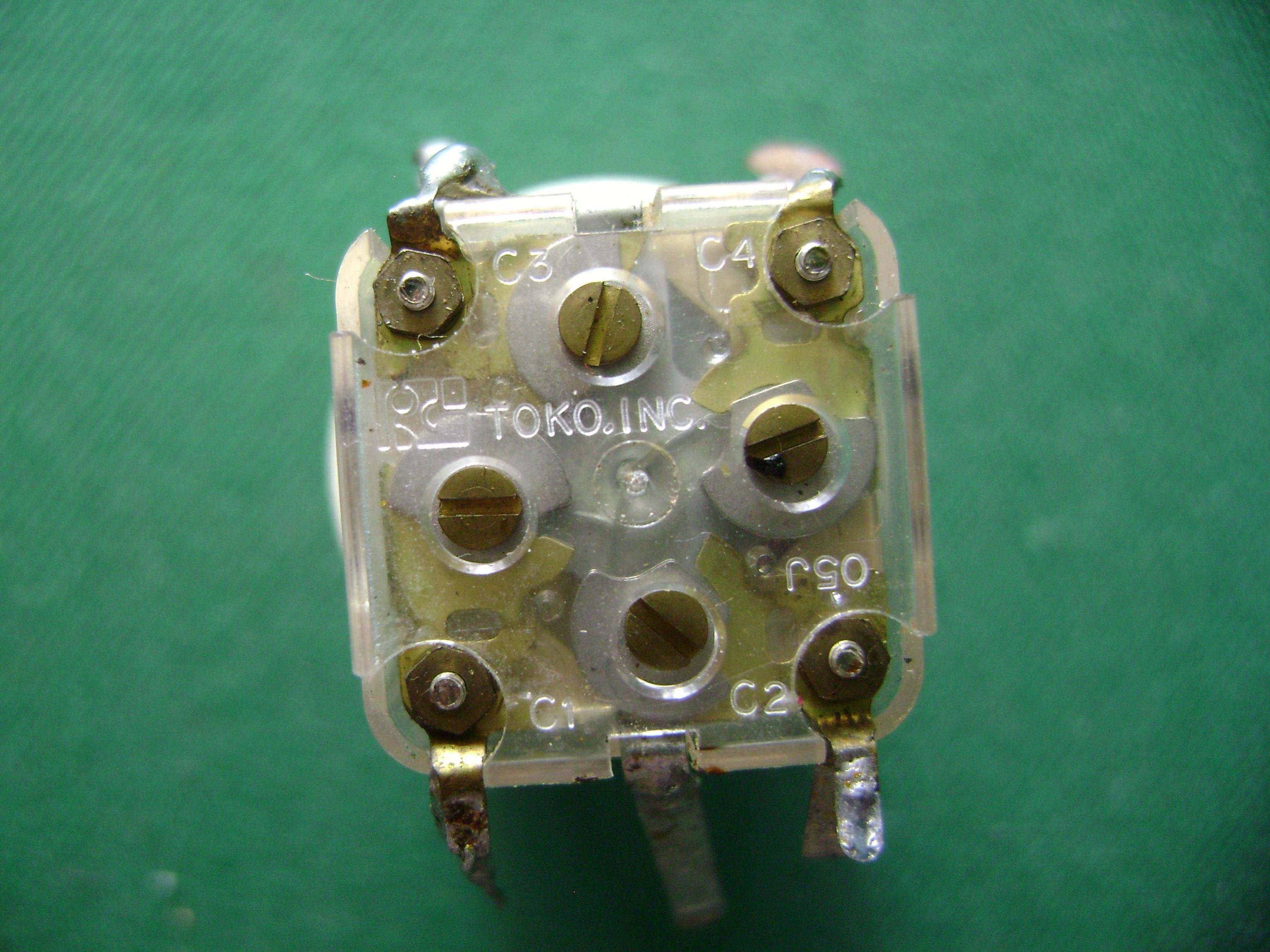

I can only get ceramic trimmers upto 70pf in my place.
Did you use FM Tuning Capacitor-Gang Capacitor for trimmer ? Do they have any capacitance value mentioned?
Can you suggest where to get trimmers?

Yes, I used this variable capacitor for tuning FM radio(scrap parts), this type of component is not easy to find in stores,Originally posted by mindfreeThank you Baterista for your post!
Also i can't find Q4, Q5, Q7 - BC559/BC179
Any substitutes?
Thanks!

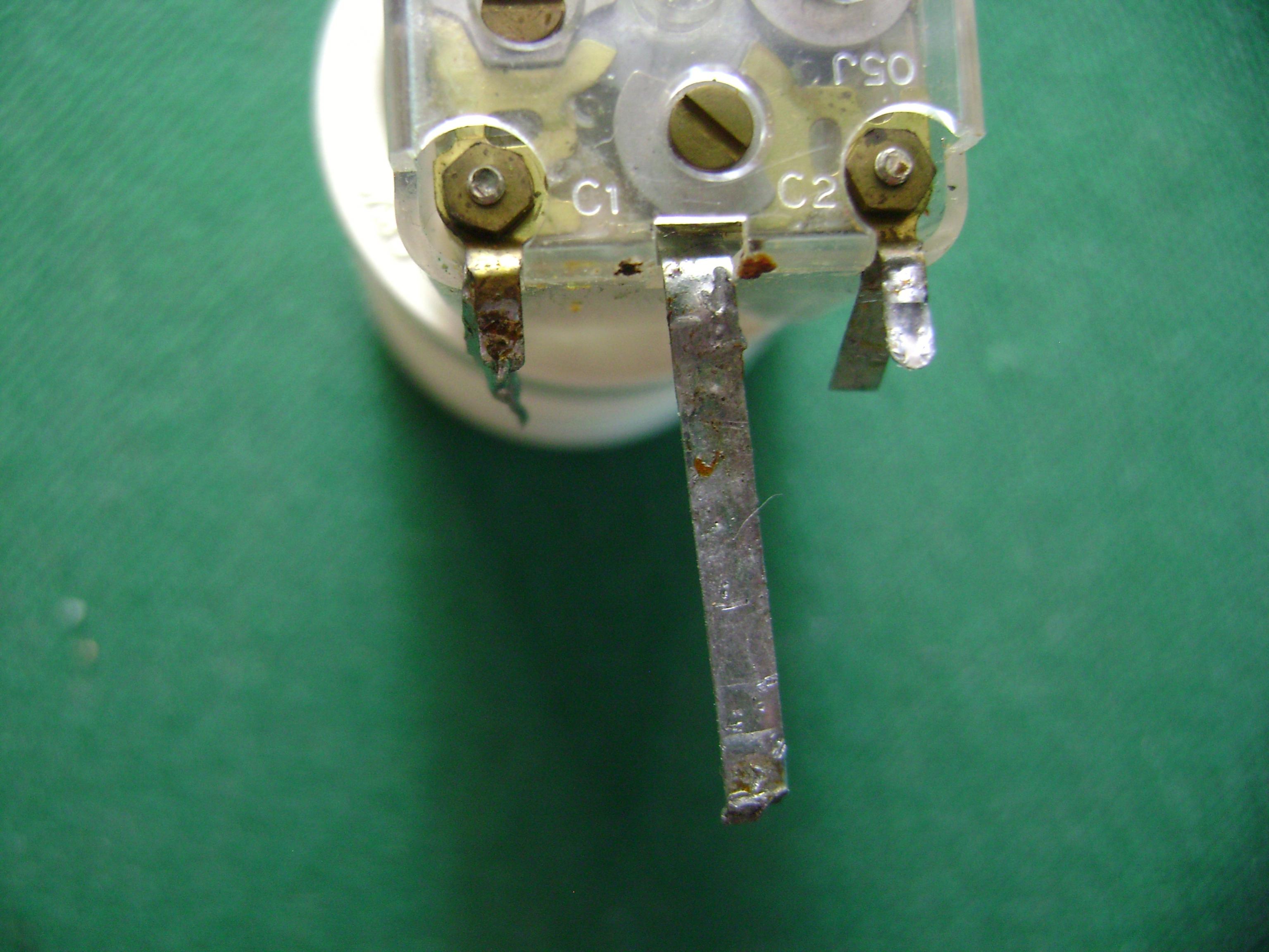

they are usually for 350 to 450 pF, looking at the picture there are 4 capacitors, each with a different value
(C1, C2, C3 and C4), in my measurements I C1 and C2 always found above 250 pF and C3 and C4 of 50 pF below,
measurements are made with the "COM" on the leg between C1 and C2.

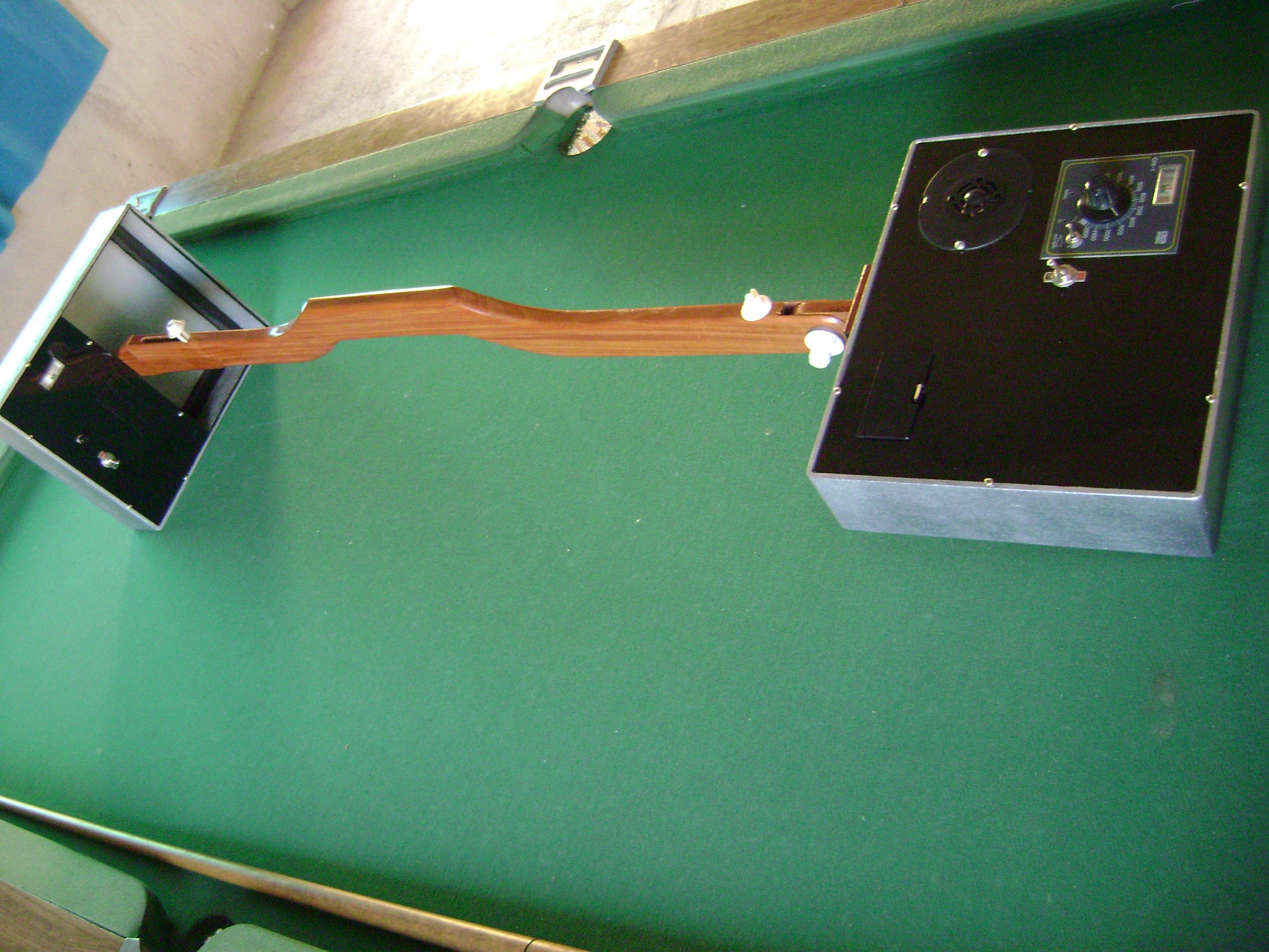

Yeah, I do not know what happened, I thought the image had disappeared only to me, anyway I'll repost the photo.Originally posted by WM6Hi Baterista
As far I remember you post a photo of whole detector in your first post here. I don't know if it is only on my browser, but I cannot see those photo any-more?
