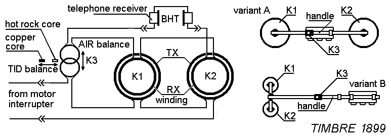

=Carl-NC;164483]These early detectors (all the way back to Bell's 1881 model) were not PI but rather induction balance. They used an electromechanical clapper to generate the TX signal. If it appears that the search coils are not balanced (as on the magazine cover), there are 2 more coils in the box which are used to create the IB.

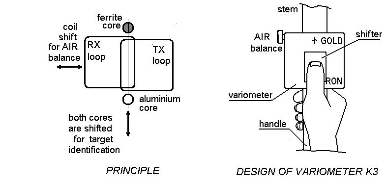

The early detectors (all the way back to Bell's 1881 model) were (like a conventional PI) wideband machines. They use an electromechanical interrupter to generate wideband TX signal in audio frequency spectrum. If it appears that the search coil arrangement is not induction balanced (as on the magazine cover), there are 2 impedances in the control box which are used to create bridge balance.
