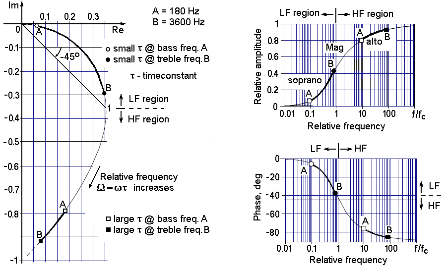

    HOW ANCIENT PI METALDETECTOR WORKS
    (See circuit diagram in post #37)
    Below is shown normalized locus of transfer impedance valid for all conductive nonferrous targets.
    The normalized locus uses relative frequency which has no dimension because is against the time constant of object. This allows in one locus to present the frequency spectrum of signal from two targets with different time constants. This method loses information about the scale (real amplitude of each target), but on the other it shows important spectral differences between received target signals. Here's how the normalized locus can explain the different timbre of the sound of two targets, which differs in timeconstant.
    The TX of metal detector TIMBRE illuminates environment with powerful magnetic pulses which in frequency domain are represented by wide band of audible frequencies. The bandwidth is even larger than the so-called ELF radio band (300 ... 3000Hz). With letter A is denoted the lowest frequency of the band (in this case 180Hz) and with letter B - the highest (in the case 3600Hz). Each boundary frequency appears twice on the locus, which is impossible when the impedance plane is not normalized.
    TARGET WITH SMALL TIMECONSTANT
    For this target, the whole illuminating frequency band appears in the low frequency region of target's spectral characteristic. This is below cutoff frequency, where the phase lag is small #less than 90 deg, but the amplitudes and phases depend strongly on the frequency. Magnitude OA in the lowerst end of frequency band appears significantly less than the magnitude OB in the upper end . In order not to clutter the drawing, the vectors of magnitudes OA and OB are not drawn. Only vector 01 for magnitude at cutoff frequency is shown for reference.
    The top right diagram illustrates what timbre of voice give this target. At relatively small timeconstant we will hear timbre SOPRANO because the amplitudes at low audio frequencies are relatively small to amplitudes at high audio frequencies.
    TARGET WITH LARGE TIMECONSTANT
    For this target, the whole illuminating frequency band of TX current appears in the high frequency region of target's spectral characteristic. This is above cutoff frequency, where amplitudes and phases depend less on frequency. Phase lag is more than 45 deg, but phase differences between frequency components are small. Magnitude OA in the lower end of the frequency band is virtually identical to the magnitude OB in the upper end of the band as shown in the top right diagram. In this case the operator will hear loud audio signal with timbre ALTO.

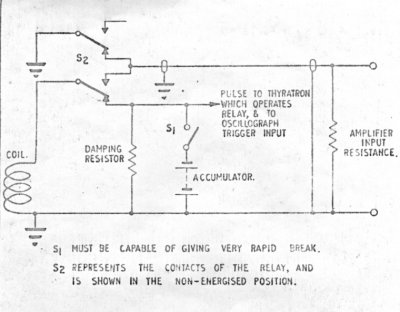

        This subject comes up from time to time as if it were some new technology. Snubbers have been around about as long as inductors in order to limit or control the high voltage that occurs when current is interrupted in and inductor. However, the interest here is their use in a PI metal detector. The first PIs that I was involved with in 1966 used a BUY12 silicon planar transistor to switch the coil current. This had a maximum Vec0 of 80V. A snubbing network of a 10D8 diode, 0.47uF capacitor and a 2K2 bleed resistor were required to prevent the transistor being instantly destroyed. A few years later, silicon epitaxial planar transistors became available and it was found that these would happily run without an external network in a repetitive avalanche mode. A popular device, and relatively cheap, was the 2N3055 workhorse. Many manufacturers made this device, but interestingly only the Motorola version would switch fast enough.
        In 1967, I was also involved in the design of a solid state front end for a seagoing proton magnetometer. Till then, relay switching of the polarizing current was the norm, but because we wanted to get both the polarising circuitry and the preamp down in the towed fish, we opted for transistorised switching. The sensing head had an inductance of around 20mH and a snubbing network was essential both for relay or transistor switching.
        With modern high voltage mosfets snubbing networks are not required, except that there is some concern for advanced designs regarding avalanche noise in a balanced coil system, where measurements are taken during the current fall / avalanche time. Also, there is the argument that improved switch off times can be achieved by using a snubber network rather than avalanche mode.
        Simple proton magnetometers use a changeover relay to switch the preamp and tuning capacitor either to ground or to coil, after the coil damping period. This is similar to a PI, except for the capacitor. In effect this is a blocker, and a similar suggestion was made in the 1956 paper “A Pulsed Bomb Locator” by F B Johnson. The relay operating time constituted the delay.
Name:	1956 relay.jpg
        Today, mosfets have replaced relay contacts in most applications, and do not suffer the limitations of mechanical devices. Therefore, switching a PI coil and the preamp input using such devices is an obvious choice in many designs.
        Eric.

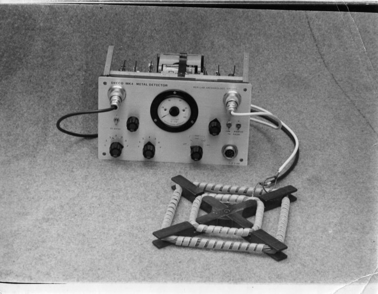

                    • #55

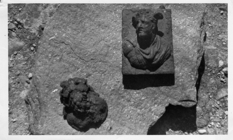

                      In the 1960's archaeologists in general were much opposed to the use of metal detectors. There were good reasons for this at the time, but they did not appreciate how useful a tool it would be for them, when used in a proper and controlled way. In 1968 we were invited to do a survey on Delos using DECCO 4, not by the archaeologists involved, but by a numismatist, Tony Hackens, who was studying Greek coins of that particular historical period. The archaeologists did not like us being there, and gave us part of the site where, I was told later, that they hoped that we would not find anything, and pack our bags and leave. As it turned out we found so much that had been missed by visual searching that the use of the detector could not be ignored. Subsequently we were allowed into the main excavation where two bronze figure heads were found of the gods Hermes and Bacchus. Knowing that the objects were there prior to digging, ensured that there would be no inadvertent damage by spade or trowel. Bacchus is the one with a beard likened to a bunch of grapes.
                      I will post the full report as a .pdf, but having trouble uploading it at the moment.
                      Eric.
ID:	334855 Click image for larger version
