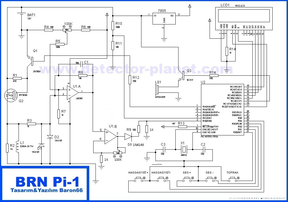

    • In post # 148 of this thread, 6666 suggested an alternative frontend, consisting of 2 opamps:
      I built it, but it doesn't work. When you look at the coil configuration: the voltage over the damping resistor goes to 5V during the switch-on pulse. When it is shut off, there is a negative going flyback pulse. These pulses are then limited by the 2 diodes: 0.6V positive for the switch-on time and -0.6V for the flyback.
      This is DC coupled into the opamp pin 2.
      On pin 3, a very small DC voltage can be adjusted with the 100K trimmer. The 0-5V voltage is divided by 100K (R5) /1K (R7).
      The output of the opamp is the amplified switch-on pulse, NOT the flyback.
      Can anyone with more analog insight than myself please explain how this is supposed to work ?
      Thanks in advance,
      - Bernard
      • This schematic looks little bit ridiculous. I doubt it ever was working.
        DC coupling is bad idea because negative flyback pulse keeps input voltage out of range. Op-Amp input voltage should be between supply rails.
        Add a capacitor 0.47 between diodes and negative input of Op-Amp. It may help.
        Also LM358 is too bad choice for PI detector preamp. Should be replaced with something low noise and high slew rate.
        May be there are more glitches in schematic, can't tell it right now.
        • OPA2350 will works great in this schematic because of one 5 Volts supply. It has low noise (5nV/√Hz), and high slew rate (38MHz, 22V/μs) but little bit expensive.
          Also OPA2350 has "input common-mode voltage range that extends 300mV below ground". http://users.ece.utexas.edu/~valvano/Datasheets/OPA4350.pdf
          I have never tried but may be it even will help to use current schematic without capacitor because we have that negative voltage input that goes below ground rail.
          • Thanks, Waikiki_Sweep for your inputs.
            I actually got it to work by increasing the DC offset on the non-inverting input pin.
            I increased R7 from 1K to 4K7. The input signal on the diodes is a positive switch-on pulse going up to 0.6V followed by a -0.6V flyback.
            The idea is to lift the signal up enough to amplify only the part of the flyback just below 0V.
            AC coupling could also be a solution as you mention.
            Thanks for the information on alternative opamps
            - Bernard

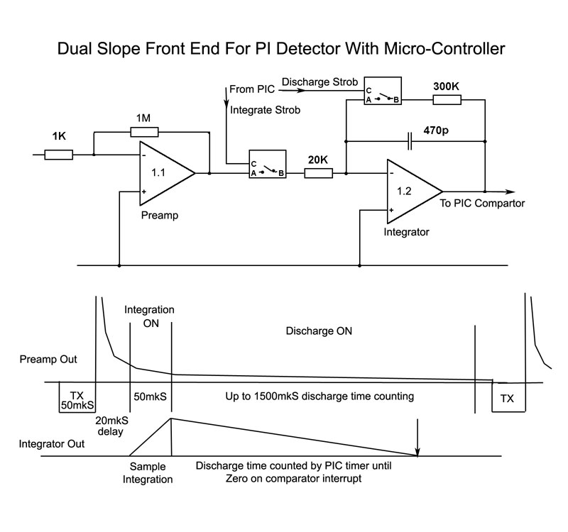

                              • Learning most successful Russian PI detectors like Tracker PI, Koschey, Clone PI, I saw an interesting solution.
                                If you anyway going to use dual OpAmp you can turn second amplifier into integrator with great benefits.
                                You just need add two switches. One for sampling and other for discharge.
                                You can make fast sampling then slowly discharge capacitor waiting when PIC comparator hits zero and counting time.
                                What benefits:
                                1. If you will have up to 1500 microsecond for timer counting you can increase sensitivity us much as you can.
                                2. Using integrator you will suppress noise very effectively.
                                3. Reading shorter sample after TX you will detect gold reliably because small gold items decays in 10-30 microsecond.
                                What is contra:
                                Just one additional IC needed - switches or multiplexer. Something like cd4066 or even 74LVC1G3157 or two FET transistors like J201 or PF5102FS which is better because turns by lower voltage.

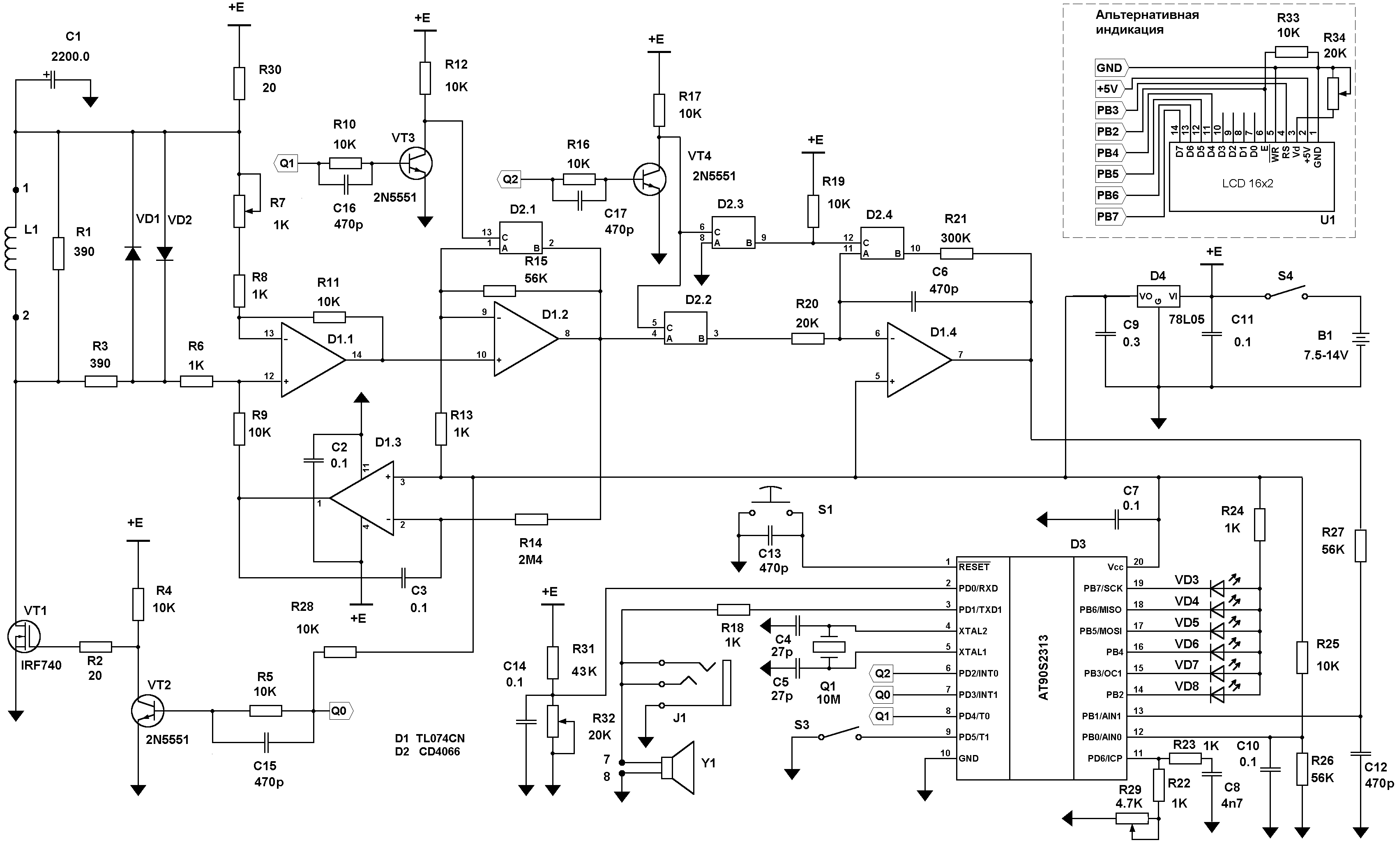

                                Original Tracker PI schematic: Click image for larger version
ID:	338721 www.metdet.ru
                                Several modifications named Clone PI you can find on http://fandy.hut2.ru/Chance.htm
