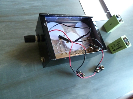

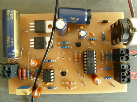

                          Hello Mohandes
                          On this very nice website you will find all the information you need.
                          http://users.telenet.be/willaert/MD/..._en/intro.html
                          I built this PI detector. I highly recommend it. He works reliably. You can work with different coil / experiment.
                          My PCKINI:
                          I hope this information will help
                          Dixix

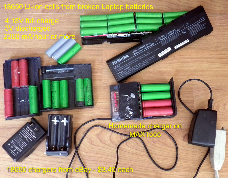

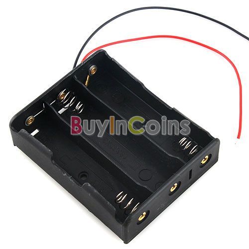

                          • Because of high power consumption (up to 100 mA) use of four 9V batteries probably turns to be costly. Also they are discharging too quick.
                            I can recommend replace it with five 18650 Li-Ion rechargeable batteries 3.7V each. ( 3.7 X 5 = 18.5 V ) or 21 Volt at full charge.
                            Also they will give you 2000-3000 mA/hour or 20-30 hours of work from one charge at full load.
                            If you have changed detector to work from 12 volts it is enough to use three cells because at full charge
                            it gives 4.2 Volts each or 3 X 4.2 = 12.6 V
                            You can buy 18650 cells for $1-2 each on eBay, you need $2-3 for holders for 5 cells. Charger for 2 cells costs near $3.
                            Also there are very good 18650 cells you will find if disassemble any broken battery from notebook, laptop, netbook computer.
                            Than you will have free and literally unlimited source of power for your PI detector. 500 charges for every cell.
