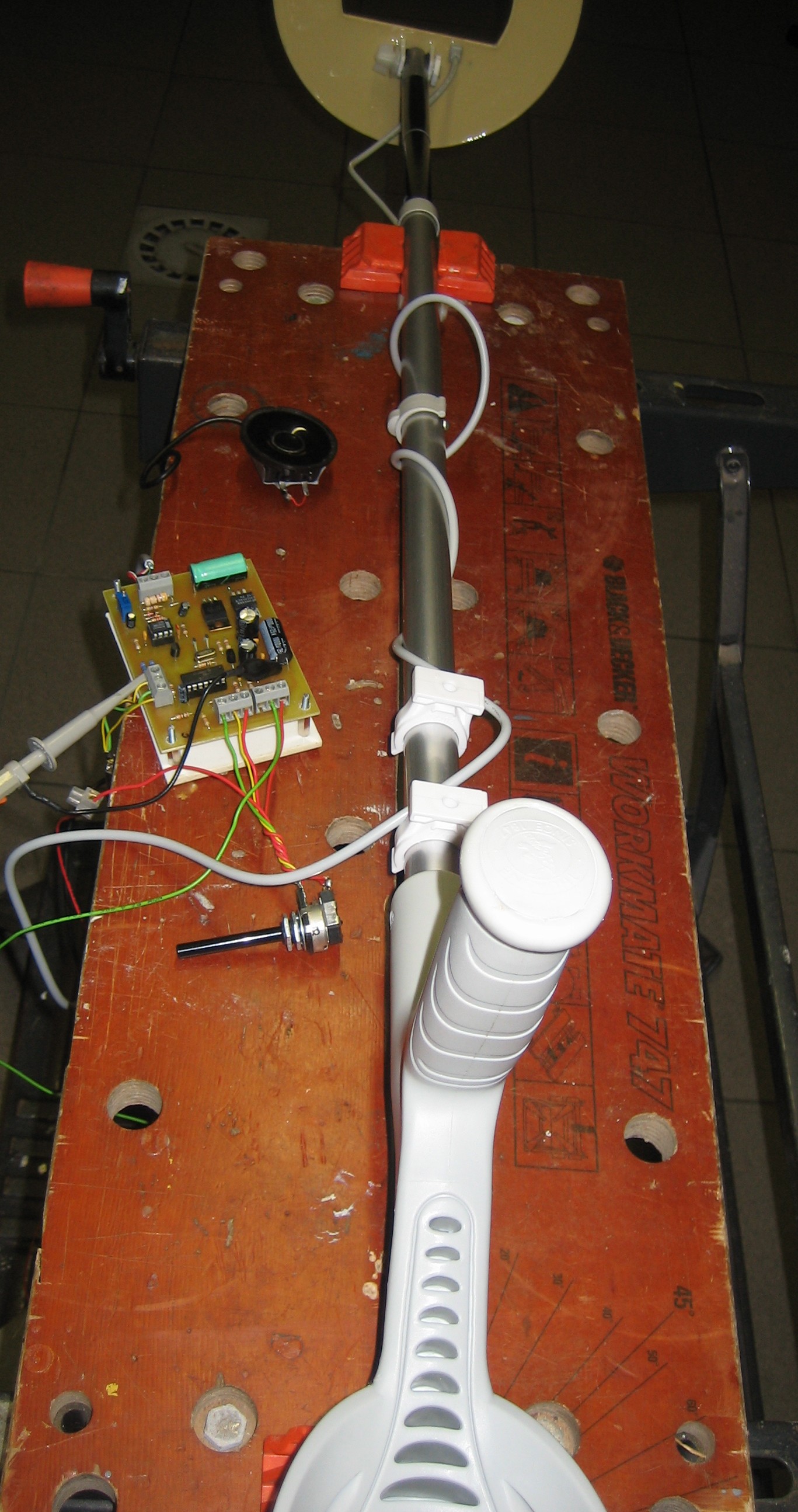

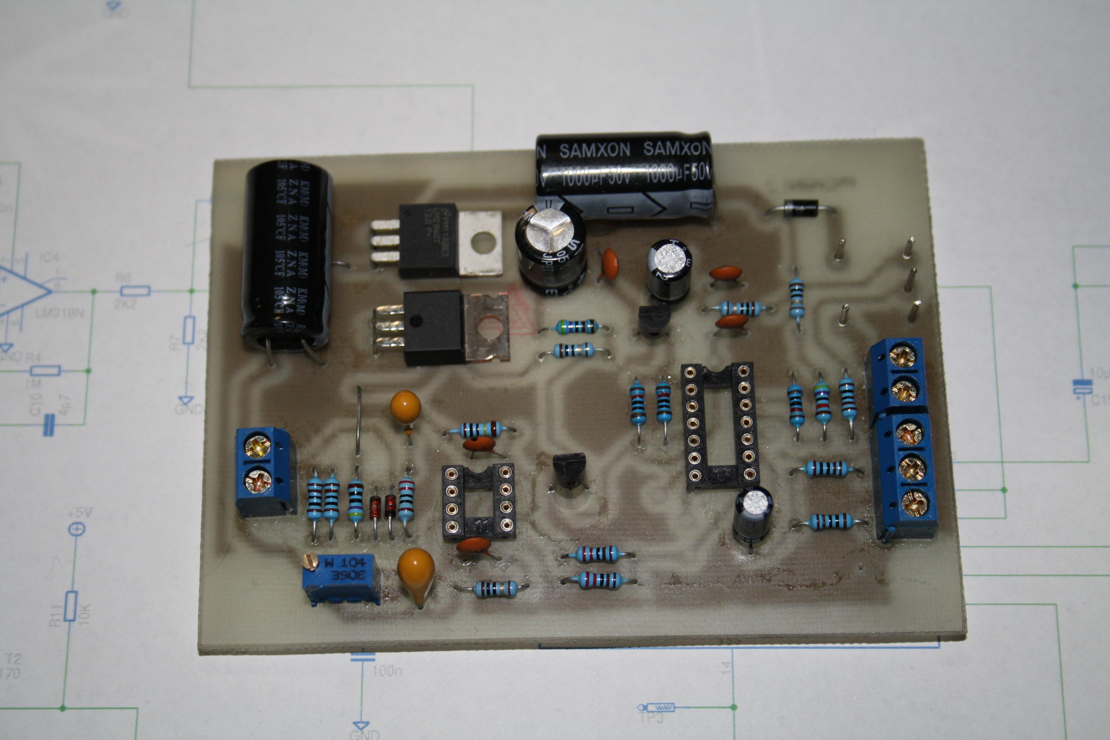

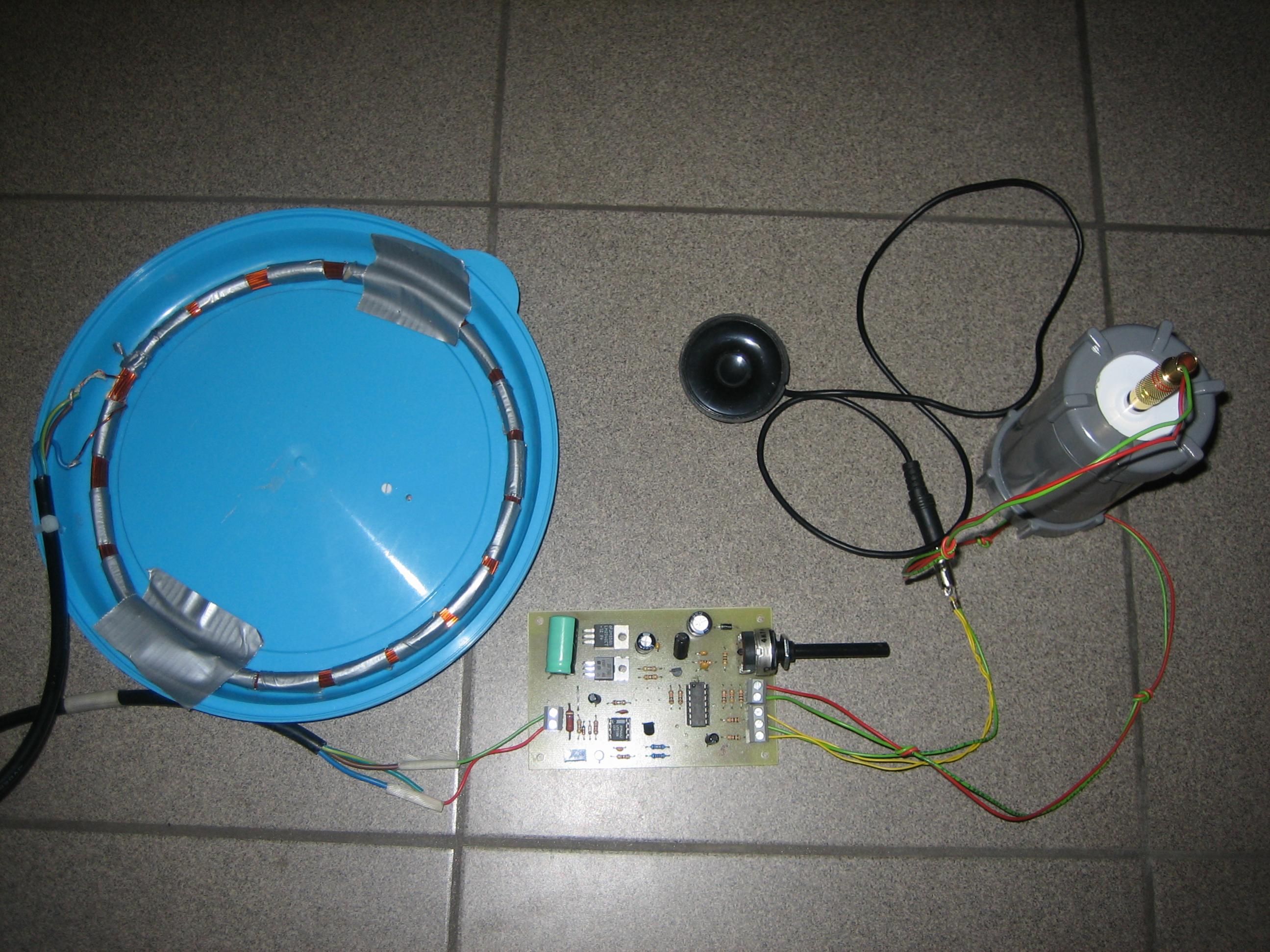

    Hi Mike,
    I programmed a V2 board with the file that is available on my website and did some more tests.
    First: a picture of the test setup:
    Close up of the board
    There is a jumper underneath the big elco !!
    The only difference with the layout on the website is that the damping resistor across the coil is a single 470E resistor instead of 2x1K parallel.
    I also measured some values:
    Resistance across the coil connections - no coil attached and unit switched off: 461 Ohm.
    DC voltages:
    L1: 11.97 VDC
    L2: 11.94 VDC
    Opamp:
    pin 1: 9.46 VDC - pin 5: 9.46 VDC
    pin 2: 7.98 VDC - pin 6: 8.65 VDC
    pin 3: 7.98VDC - pin 7: 11.90 VDC
    pin 4: 0 VDC - pin 8: 1.39 VDC
    Microcontroller: -- with sensitivity potmeter almost at minimum
    pin 1: 5.06 VDC - pin 14: 0 VDC
    pin 2: 0 VDC - pin 13: 0.41 VDC
    pin 3: 0 VDC - pin 12 : 2.90 VDC
    pin 4: 5.05 VDC - pin 11: 0 VDC
    pin 5: 4.96VDC - pin 10: 0-5VDC tick
    pin 6: 0VDC - pin 9: 4.32VDC
    pin 7: 0VDC - pin 8: 4.32VDC
    Hope this helps.
    Again: inside the house with an unshielded coil like the one in the test setup, I can only turn up the sensitivity very little.
    It's only on the beach that the sensitivity can be cranked up without disturbances.
    Best regards,
    - Bernard

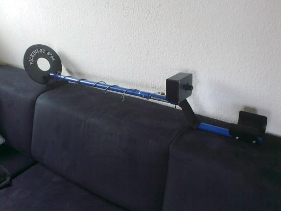

        • #64

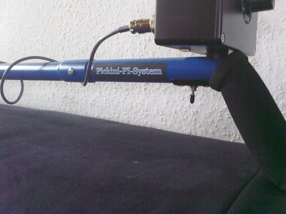

          "finished" now i have to make some tests with different coils before i make a video.....Click image for larger version
ID:	335822Click image for larger version
          • #65
            Nice work ! Looking a lot better than the builds I did so far, but then again, my mechanical skills are limited...
            Best regards,
            - Bernard
            • #66
              thanks bernard! and also thanks for your excellent project!

                  Hi Mike,
                  Great build and nice video
                  Some good design features too:
                  - switch between pinpointer coil and search coil
                  - separate, removable battery pack - you can take a spare one in your backpack
                  Hopefully spring will kick in soon and get rid of the snow.

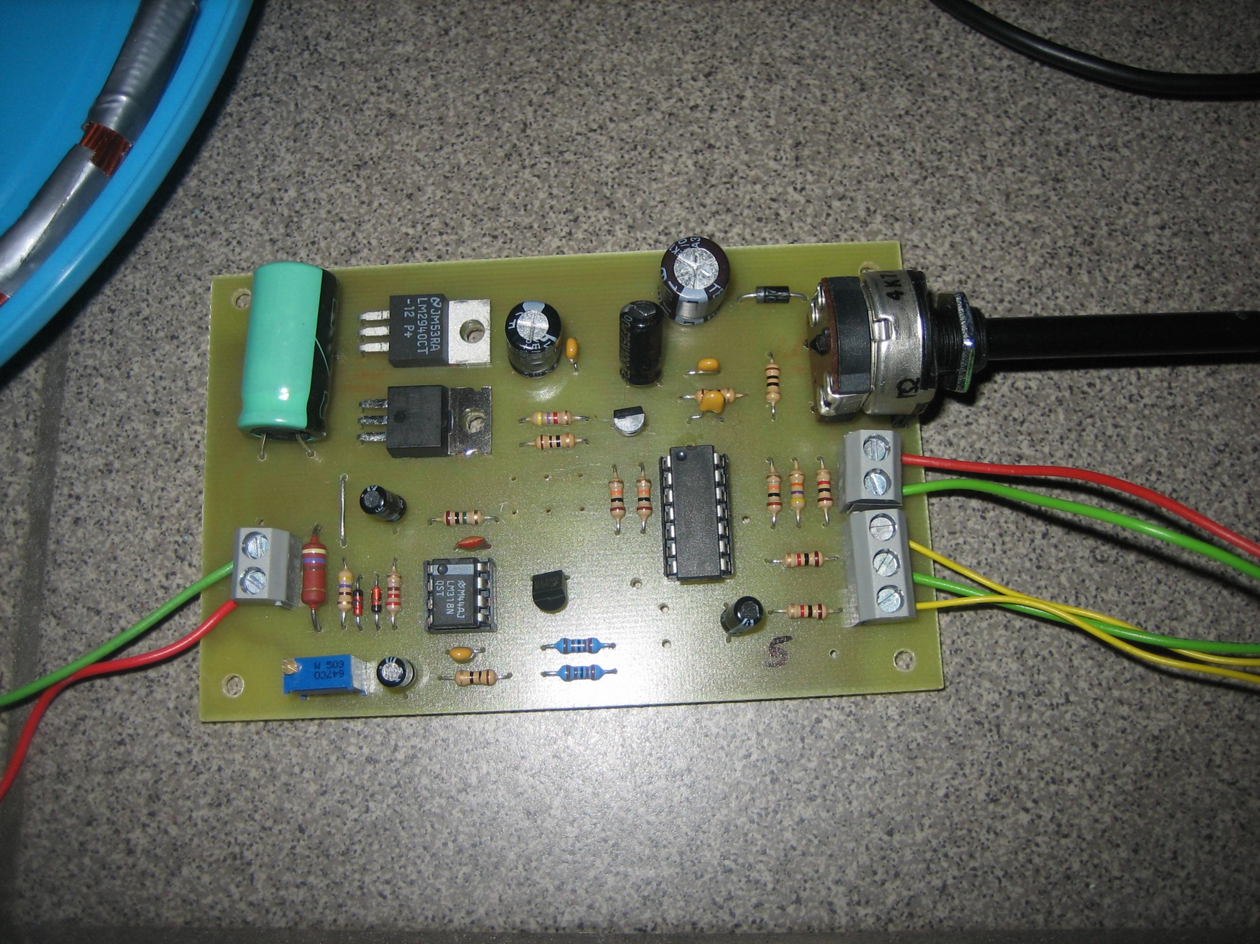

                    My build so far..
                    Pic has been programmed.
                    About to power up before inserting Ic's.
                    Check power supply etcClick image for larger version

                    • #70

                      • #71
                        Bernard, can you say something about power consumption?
                        @WM6: Thank you, Please have a look here: http://users.telenet.be/willaert/MD/...technical.html
                        90 - 130 mA depending on the sensitivity potmeter setting. The pulse frequency changes with the sensitivity setting -> current consumption changes.
                        @john: looking good
                        The 100 nF ceramic decoupling capacitors look smaller than the housings I am used to, but if they have the correct value, go ahead !
                        It just surprises me that there is not much difference between the 4p7 feedback capacitor housing and the decoupling capacitors...
                        Just make sure it's not 100pf instead of 100nf !
                        One other tip: you can use the wire jumper that is located underneath the large elco at the coil side to secure the capacitor to the board by routing the jumper over the capacitor housing

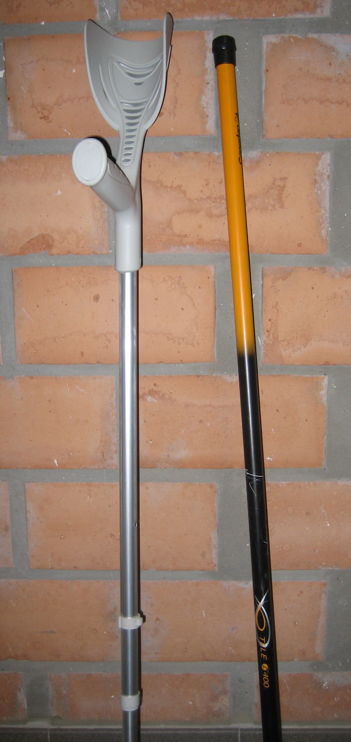

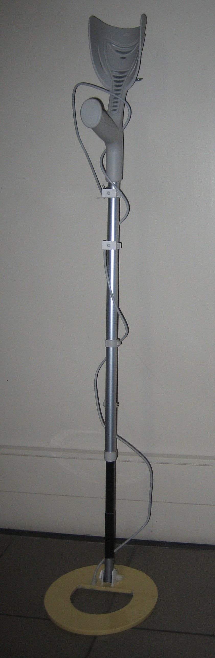

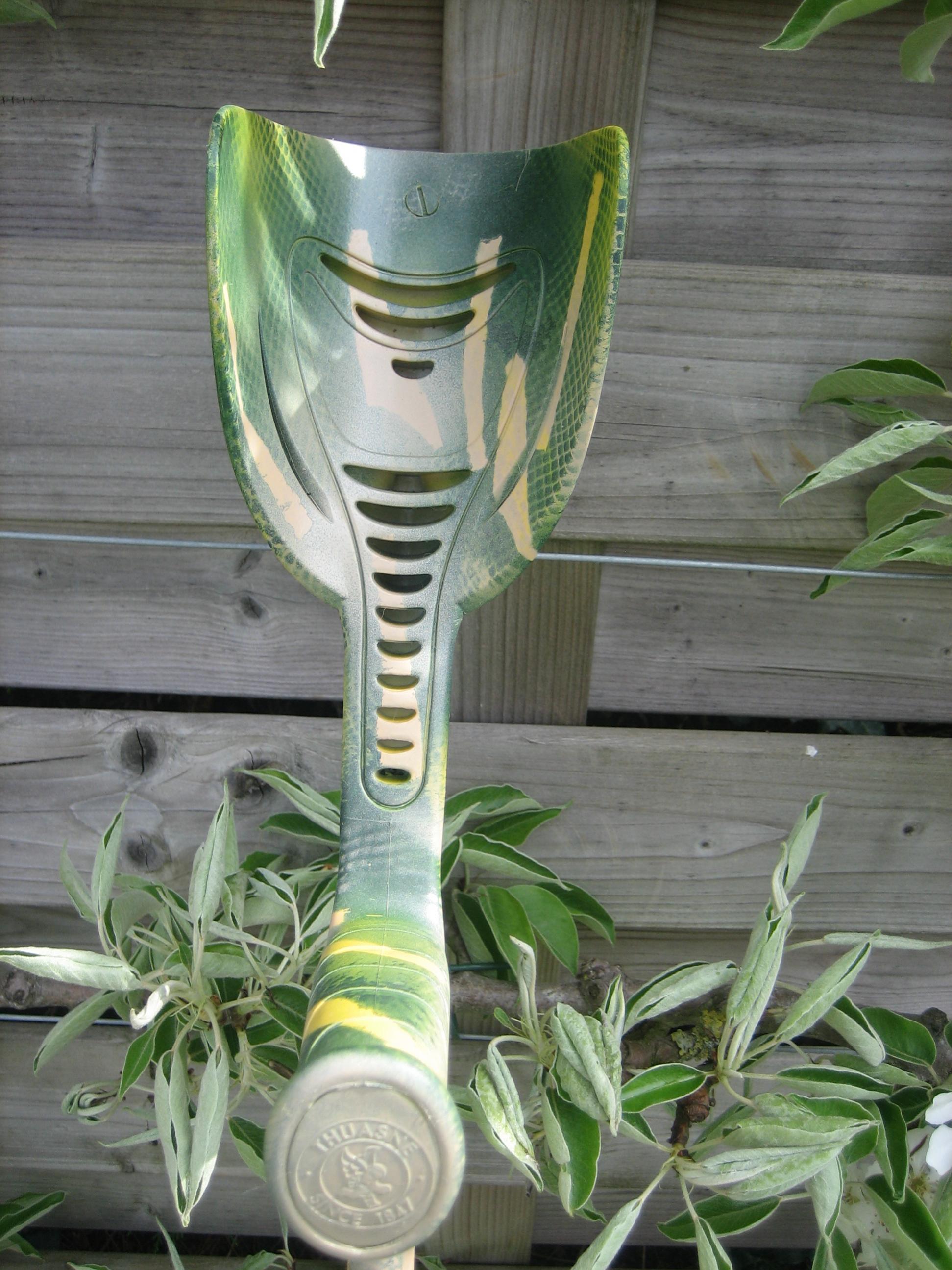

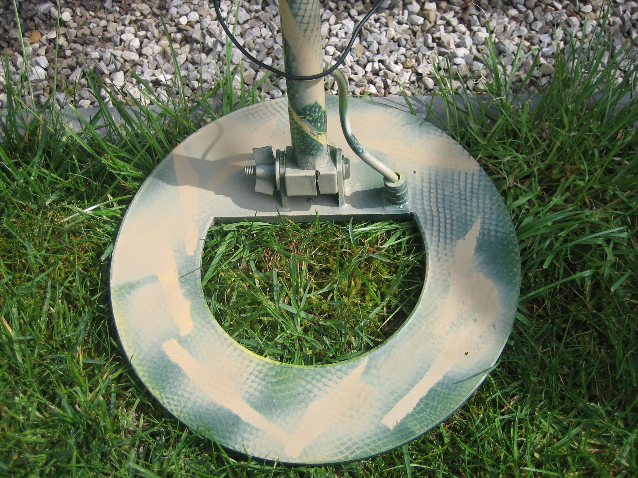

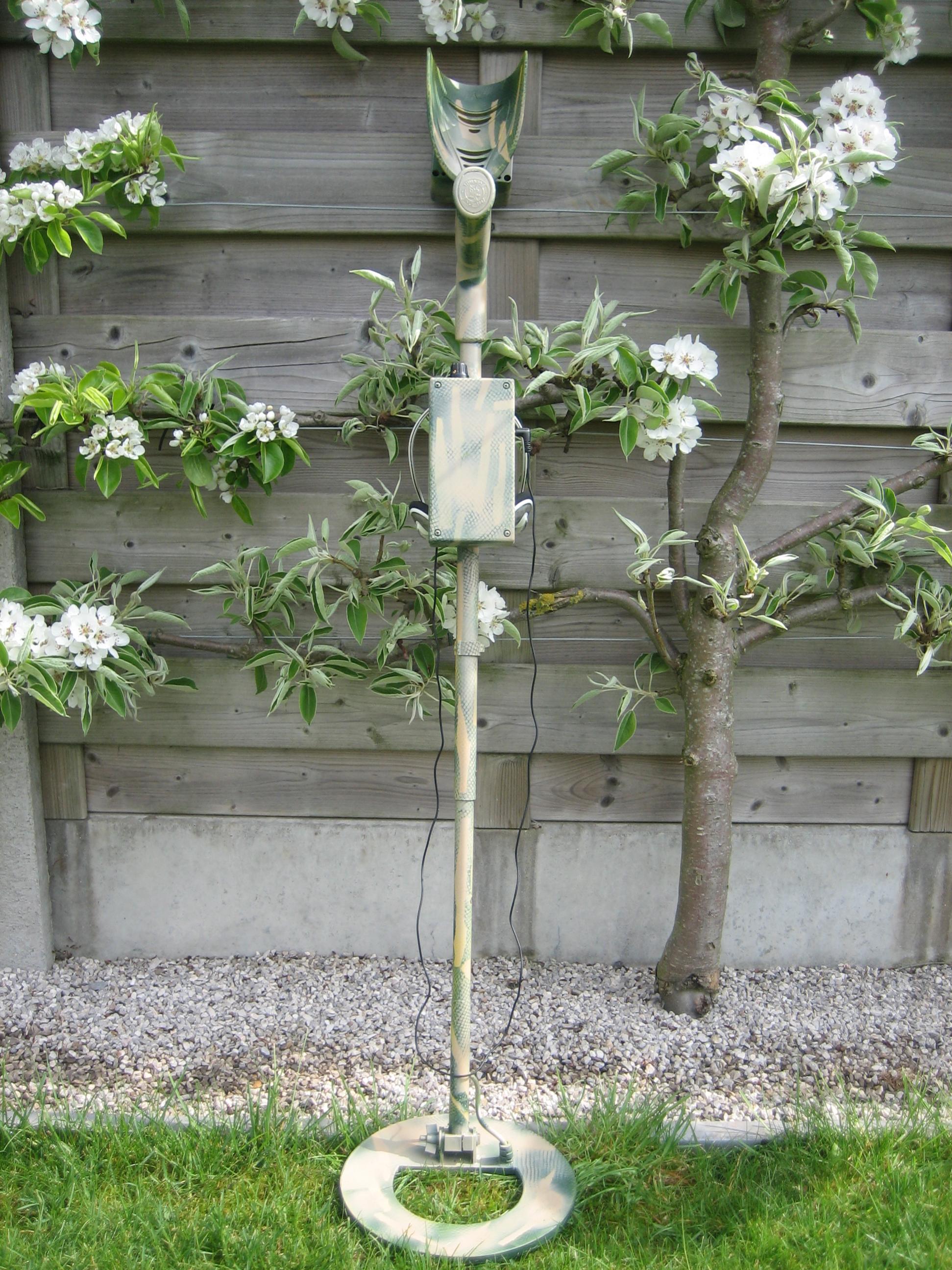

                                Some evolutionary pictures of my latest build - elbow crutch + low-cost carbon fishing rod - combined with spray paint experiments on camo patterns.
                                The outcome is a "dune snake" pattern - although I've never seen a snake in the dunes...
ID:	336017Click image for larger version
ID:	336018Click image for larger version
ID:	336019Click image for larger version
ID:	336020Click image for larger version
ID:	336021Click image for larger version
                                Have fun,
                                - Bernard
