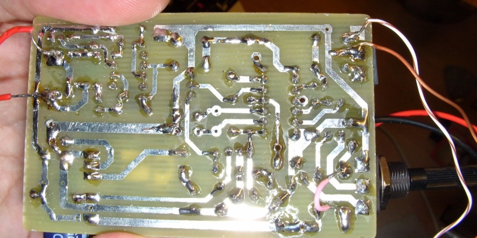

  • i just hear the startup tone and no ticking sound
    get 8v on the pin3 lm318
    were should i start to search the failure?

      • hello
        i have used hispalbas layout - that was not good
        missing connection
        from coil (upper coil marking) to +rail from cap C6
        not funny
        and i still have two 1k resitors parallel to coil
        because i had jumped the post where it was written to replace them bei 470r (i think a least 1W) dampening resitor
        typical file salad
        and i lost the overview
        will start it with a new board i think
        and after finishing i will write an how to send the hexcode to the pic manual (had waste some yours with experimenting and it was so easy when you would know where to set the marking in the new mplab 1.9)
        thanks bernard for fast reply and help

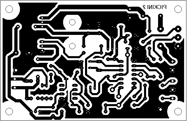

        • This is my original layout that works:
          On Your layout, there is no connection between the +12V rail and the coil.
          You can add a simple wire bridge to solve this.
          You can use 2x1K in parallel ( normal resistors) as dampening resistor - instead of the single 470 ohms resistor.
          Best regards,
          - Bernard
          • some pictures of my crap board
ID:	337965Click image for larger version

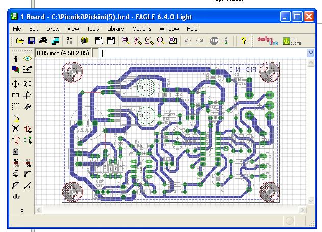

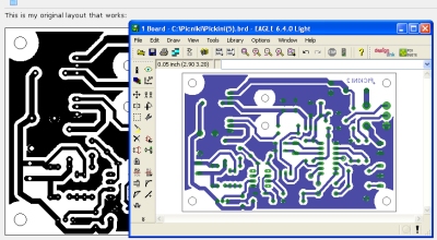

              • Bernard
                in post #199 your pcb has large earth planes on it, but when I view the pcb from your site they are missing, did you remove them ?
                • When You open the PCB file in Eagle and You right click on the ground trace and select "ratsnets", the ground plane [ the dotted outline filled ] should appear.
                  I never succeeded in saving the layout in Eagle with the plane visible
                  - Bernard
                  • Bernard
                    Thanks that information works.
                    Now with grid off, rats nest on, layers 16,17,18,19,20 all on
                    I now get this
