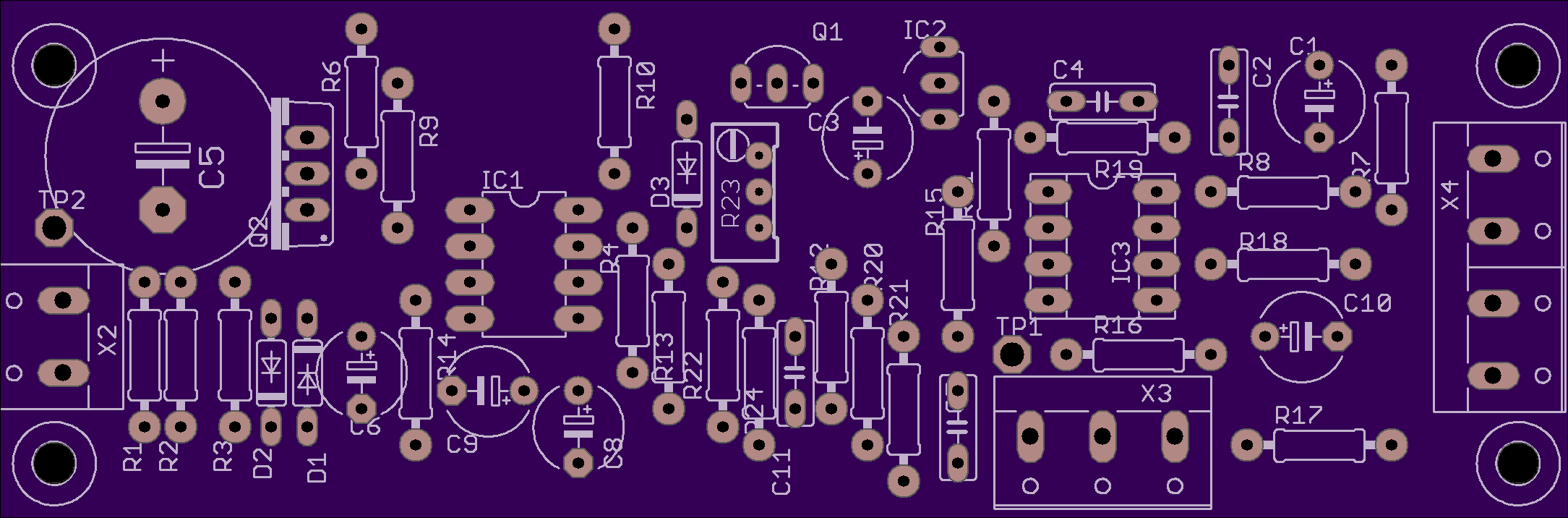

                    • Hello to the group,
                      I've read through the discussion here and didn't see any mention of anyone having pcb boards available for the Pickini.
                      Has anyone put this project on one of the small run board house's shared projects area?
                      I used OSH Park for one of my ham PIC projects with very good results and reasonable pricing.
                      You end up with a very nice one or two sided PCB with through plating and silkscreen.
                      Mike

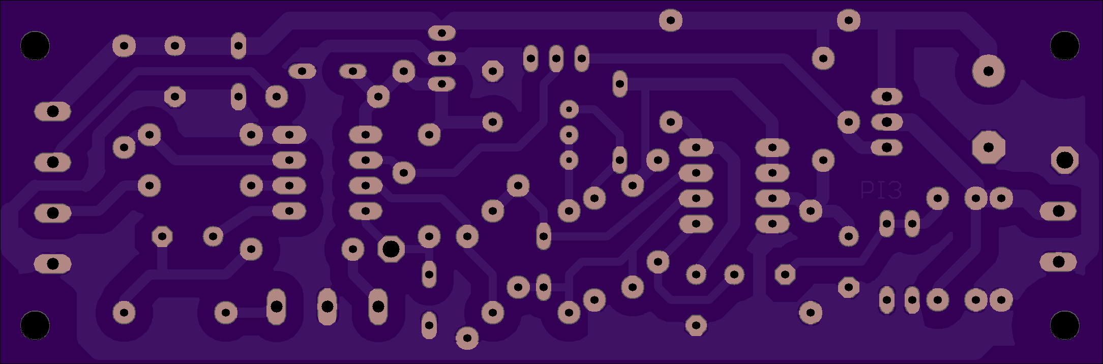

                      • I had not heard any reply, so I ordered three PCBs for the Pickini project from OSH Park.
                        There is an option to share the design so others may order as well, but until I've built and tested one, I'll hold off on that.
                        Here's photos of the front and back rendition made from F117's Eagle file for V3.

                            • Once I've got one from this board house working, I'll share the project.
                              Cost was $31.05 for three pcbs including shipping.
                              Mike

                              • Nice looking PCB's
                                Be aware that these PCBs are for Pickini V3 which has a separate thread:
                                http://www.geotech1.com/forums/showt...ld-PI-detector
                                The main disadvantage of V3 over V1/2 described in this thread is that the performance of V3 is changing with changing power supply voltage. V1 and V2 have an onboard 12V regulator.
