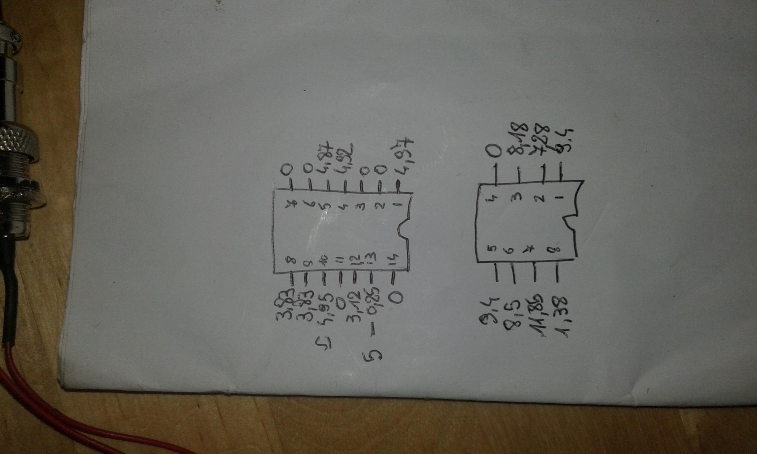

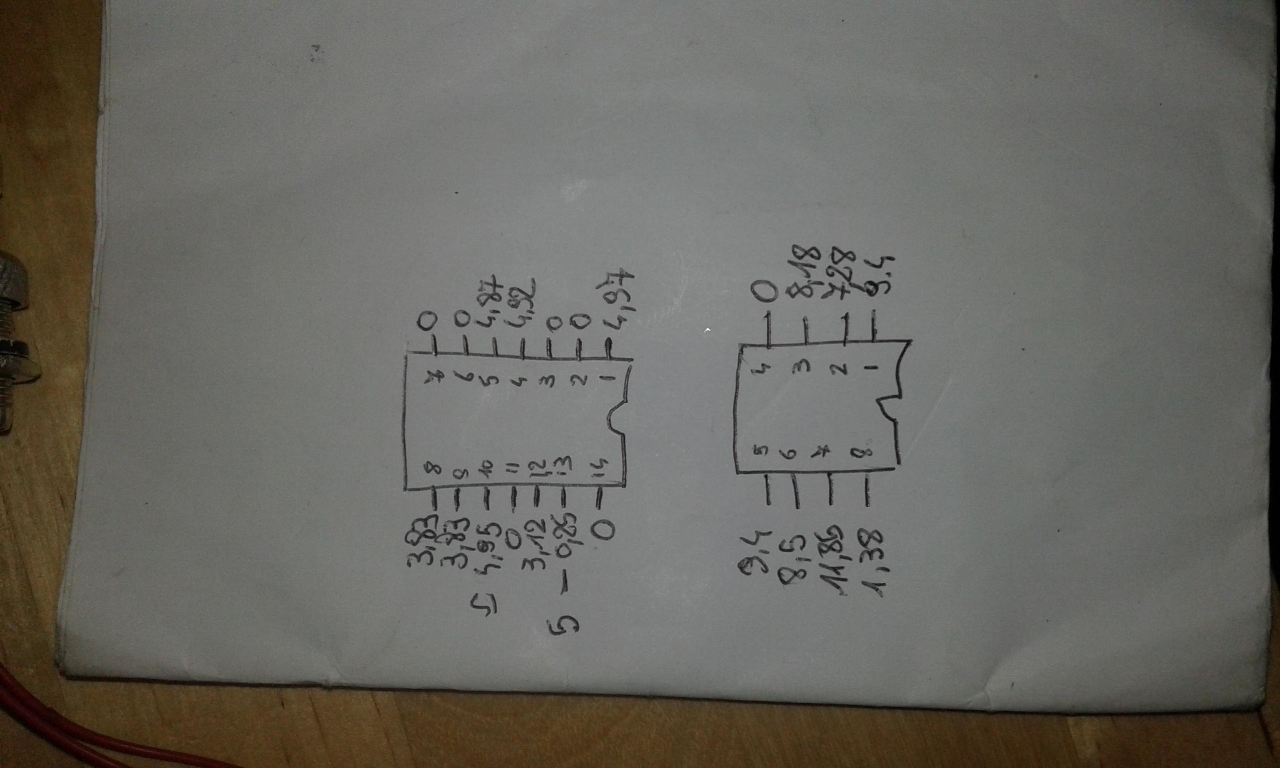

  • Goodmorning everyone. I mounted the second pickini for my brother and I found some problems. All sounds are ok. but he does not feel the metals. I'm using a surf pi 1.2 coil with 3.4 ohms of resistance. it's too much? Thanks a lot to everyone. greetings dabbo
    • Check port #61 in this thread
      http://www.geotech1.com/forums/showt...detector/page3
      to verify the DC voltages on all pins.
      If you suspect the coil: swap it with the first one you built.
      Success!
      - Bernard
      • thanks a lot. Today I will try to measure the pins .

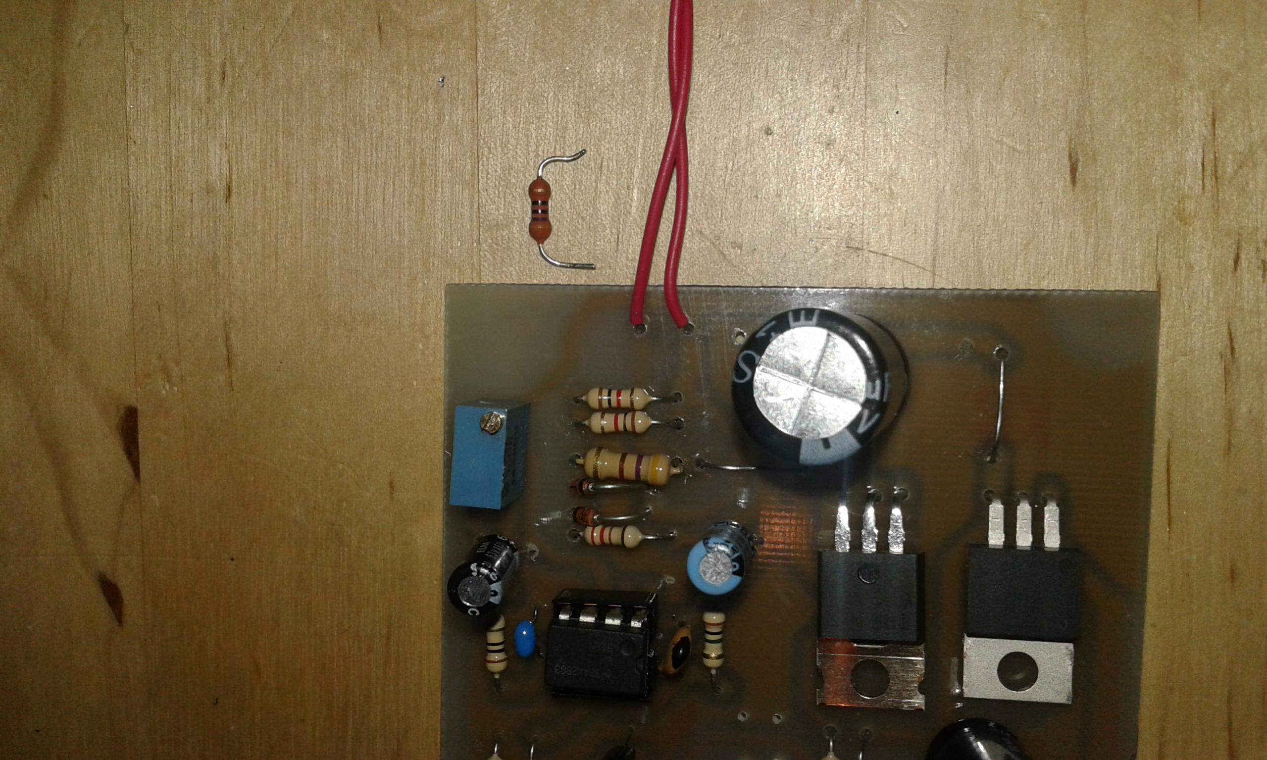

            • everything seems ok but the current on pins 8/9 does not change with metals .
              • I solved the problem !! I replaced the resistor 470 E. now works !!!!! thanks for the help Bernard !!

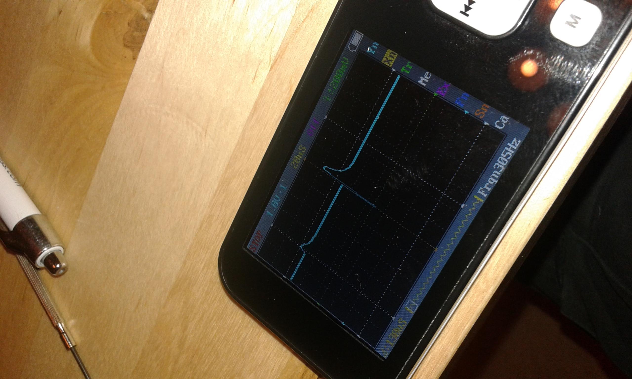

                        • Hi Dabbo, I have been thinking about buying a smart phone to try your frequency counter idea, could you please show on the schematic of the pickini exactly where you connect the smartphone thanks.
                          • Good morning to all, i connect my smartphone to Pin 8-9 of pic . I build a probe to divide the Voltage. Best regards dabbo
                            • https://youtu.be/xL4tHMMv7-U
                              • Thanks Dabbo very interesting, there are some cheap smart phones for about AUS $100 could be worth a try.
                                My multi meter has a freq counter could try that to.
