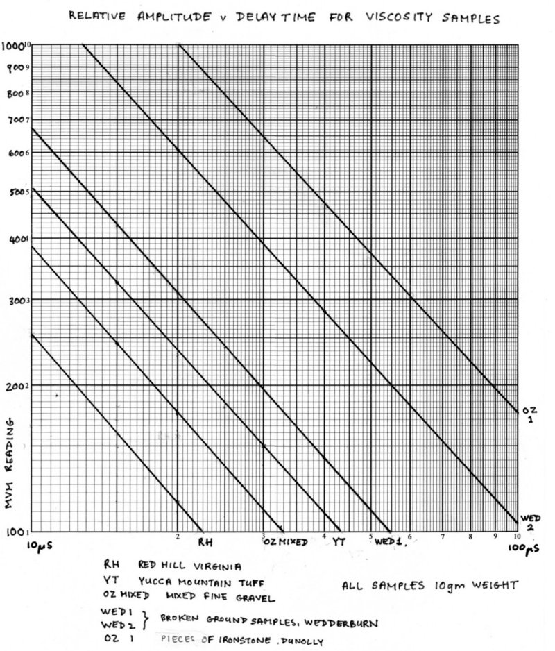

                      • This graph gives a visual image of how the viscosity signal varies with sample delay for a range of 10gm specimens. Red Hill soil the worst in US that I have so far, except for Yucca Tuff (sometimes called Tiva Canyon Tuff) from Nevada. Not a place you would go detecting anyway as it is being evaluated as a nuclear waste repository. YT is of special scientific interest though as it is composed of non-interacting single domain titanomagnetite grains rarely encountered in nature. See Institute of Rock Magnetism Journal, IRM Quarterly Fall 2004 Vol.14, No.3 and Spring 2006, Vol.16, No.1. These are downloadable and free from IRM website. I was lucky enough to get some samples a few years ago to do some viscosity tests.
                        The graphs are not fudged in any way and are from results measured this morning on a microprocessor timed viscosity meter under test at the moment. They do show that the viscous decay law is constant over the range of samples tested and it is only the amplitude that changes quite dramatically. Delay range 10uS through to 100uS. Amplitude in Viscosity Units (mine).
                        Eric.

                          Well, guess what. I have an OZ hot rock with very high susceptibility and viscosity and its viscosity signal increases considerably when you bring a ferrite magnet up to it. The magnet itself gives no signal; I checked that. The same magnet causes the viscous signal to disappear on a sample of Virginia Red Hill soil. These tests were done on 10gm samples of each in my Viscosity Meter, so very well controlled. On the RH soil the VM reading returns to its original one immediately the magnet is removed. The Oz ironstone takes about 15 mins. I will do some further tests as those opposing results are interesting.
                          Another thing of interest for those who strive for short delay times is that the viscous signal amplitude is 2.2x as great at 5uS as it is at 10uS
                          Eric.
                          Just to add a bit of information - As the ferrite magnet is lowered over the specimen (Oz rock) the viscosity reading increases about 10% but then starts to decline as the magnet is brought still nearer. Can't get anywhere near cancelling the viscosity completely though. It doesn't matter which way round the polarity of the magnet is, and the effect is the same if I bring the magnet in at right angles to the TX field.
                          Eric.
