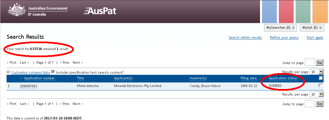

    Ferric, don't mind UF appearing here. Trolls do that. And nothing useful. Ever.
    to you too!
    It is because it's expired.

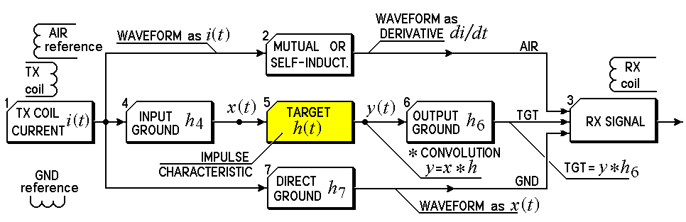

    • #77
      SOLUTION IN TIME DOMAIN
      Math operations in TIME DOMAIN for ground balance.
      The block diagram given here explains in detail what information is required and what mathematical operations to be performed for ground balance. For explanation is used terminology of TIME DOMAIN. Analysis and explanation with terminology of FREQUENCY DOMAIN will be done separately.
      COIL system
      Four coils are showed in the block diagram:
      1. TX coil used for excitation with time varying current i(t).
      2. RX coil used to receive TGT signal, but it receives also AIR and GND signal.
      3. AIR reference coil. It is used to obtain pure AIR signal. For example, this is only a turn wire on the TX coil.
      4. GND reference coil. It is placed in position for induction balance with TX coil to obtain pure GND signal.
      This example uses 3 RX coils to illustrate that the the ground can be balanced. In practice, a suitable software can simplify the system.
      TARGET
      The target is represented as a block or stage 5 with input and output. If we know the input signal x(t) and the output signal y(t)., we can identify the target by calculating its transfer function h(t). The name of this transfer function in time domain is IMPULSE CHARACTERISTIC (impulse response). For calculation of h(t) is used a complicated mathematical operation called DECONVOLUTION, because y(t) is convolution of x(t) with h(t).
      AIR signal
      This is the excitating signal that induces eddy currents. It is produced by mutual inductance or by self-inductance (at Monocoil search head) so its shape is like di/dt (derivative of TX coil current). A turn wire above TX coil can generate enough large AIR signal for refence
      TGT signal
      Since the target is buried, the energy passes through the earth twice to induce TGT signal in RX coil. Therefore, TGT signal contains distorted information for impulse response of target h(t). Excitating signal x(t) differs from AIR signal because it is the output of block 4. It is obtained by convolution of excitating signal in input of the block 4 with impulse characteristic h4.
      Similarly is distorted the output signal from the target y(t). It undergoes a convolution with the impulse characteristic h6 of block 6.
      GND signal
      This signal contains very important information for the calculation of impulse characteristic of target h(t). Therefore, in block diagram is shown symbolically a GND reference coil.
      It is assumed that the excitation signal x(t) of target has the same form as the GND signal. It is assumed also that the impulse characteristics h4, h6 and h7 are similar in shape.
      Computational algorithm
      1. By deconvolution of GND signal with the AIR signal is calculated the impulse characteristic h6.
      2. By deconvolution of TGT signal with the impulse characteristic h6 is calculated the target output y (t).
      3. By deconvolution of waveform y(t) with the GND signal is calculated the impulse characteristic of target h(t).
      4. Follows comparison of the form h(t) with known forms.
      This block diagram can not show what should be the function i(t) in order to obtain a better SNR and better energy efficiency. Analysis with FREQUENCY DOMAIN can do this.

        It looks very clever , of course .... the only problem is where to get a direct ground signal

          Yes. That particular one expired. Historically it was ML's IP, and now, by virtue of patent law it is not. See for yourself...

                  OK , but how can you be sure that our ground is homogenous ? In another words - can you guarantee that the ground near your "special ground coil" is the same kind that the ground near your target ? Just imagine the situation when the pure ground is near the coil , but near the target we have a kind of mineral with ferromagnetic properties .... your ground balance won't work in such condition . So , as I think , your theory is beautiful , but useless in the real world
                      Dmitry, you are right. The method is sensitive to change in ground properties, but the method is useful.
                      I designed a metal detector used as locator for "jewelry meteorites". They can not generate signal at air test because they have no both conductivity and permeability. However when they are in the bad soil, they create local "discontinuity" in ground properties and the instrument responses. The instrument also locates caves and voids in bad ground. However when operates with ground balance, the instrument can detect and identify deep tagrets in bad soil. Conventional metal detectors can not make this because the TGT signal contains distorted information for target characteristic.
                      In reality, I reinvented the bicycle and tricycle in PI technology :-)
                      The genuine inventor of principle is D. E. Hughes.
                      Other reinventors use term "TWIN LOOP" for the PI "bicycle".
                      Please try the TWIN LOOP project with increased distance between loops:
                      You will see that the PI "bicycle" can suppress the bad GND signal and interferences.
