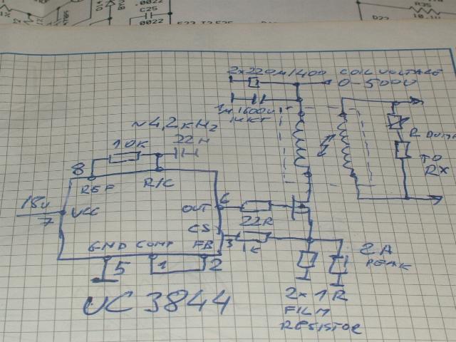

                        • Variable pulse TX
                          My intention is not to dissolve this thread by posting pointless stuff, this well may go to off-topic or somewhere else, not directly related to ground balance, but indirectly can be.
                          Sorry for hand writing, this is from old scrapbook, i'm not too good for making documentation, but can be interesting. Built long time ago just for waveform observation, now something similar rebuilt to take some measurements, very interesting for experimentation.
                          Circuit TX part is based on constant peak current control of fixed inductance coil, turning it off when preset value is reached. Now just varying drive voltage, pulse width can be varied over very wide range, 50:1 or 100:1 is easily achievable, keeping energy stored in the coil and magnetic field during this time constant. Energy is 1\2 L x I sq. considering I is fixed, resultant pulse width needed to ramp up to predetermined value is I\ (1\L) x Vcoil. Circuit is built using UC3844 SMPS chip, driving power mosfet or IGBT. R\C constant at pin 4 sets operating freq. around 4.2kHz with given component values, but adjustable over wide range. Pin 3 is current sense input, with precision 1V comparator, sensing voltage across resistor from mosfet source to gnd to monitor peak current. Without coil or coil voltage applied, will produce 50% square wave drive, but when coil current ramp up and pin 3 voltage reaches 1V cycle is terminated. In this case, 0,5R resistance gives 2A peak.
                          This on picture is “high voltage” version built time ago, present setup is bit different, intended for lower voltage operation for convenience. Coil is 8in speaker wire flat spiral, about 160uH, 25 turns, connected using ordinary wire (same as coil is made of) not coax, but it consists of two identical halves, strongly coupled. Very convenient, RX side and dumping resistor can be galvanically insulated otherwise everything have to be floated on high voltage side. Value of dumping resistor must be adjusted for each pulse width, so this is still point by point method (some sort of dumping network will be needed, not resistor). With this values, 1uS is reached at somewhat above 110V, 3uS around 36V, 50uS at only few volts (i'm running out of PSUs). UC3843 is needed for 12V operation, original HV circuit was built using rectified tube filament voltage, and variac\HV rectifier to supply coil voltage (not good, ripple voltage can interfere with integrated measurements). Separating TX from rest of the circuit, just to contain damage in case of “big bang”.
                          I assembled another similar device, but for differential measurement, based on SG3525 chip and two coils from flat spiral, to generate one fixed long, and another variable pulse, to measure just difference between them. Can be connected for unipolar or bipolar pulsing, can be used for actual detector TX. Not finished timing and integrating part yet. Want to try another modification, “transformer coil” multifilar, say 5:1 turns ratio, most probably UTP, giving large inductance ratio to achieve two different pulse widths using single battery voltage. Naturally, field straight is lower for less turns, but fixed and can be compensated later. I wish if I have more time for this...
