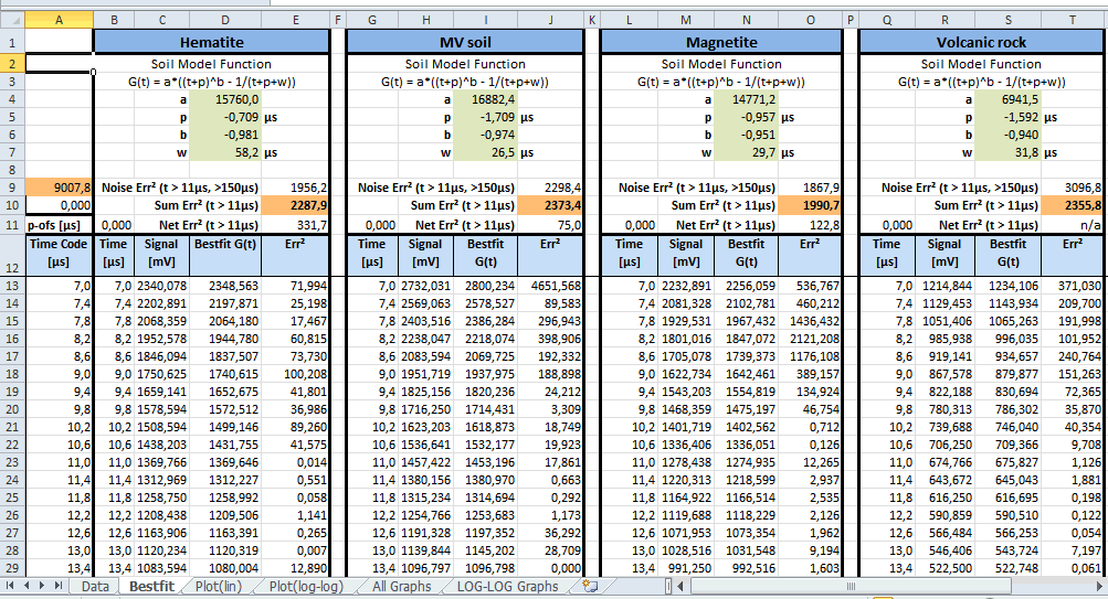

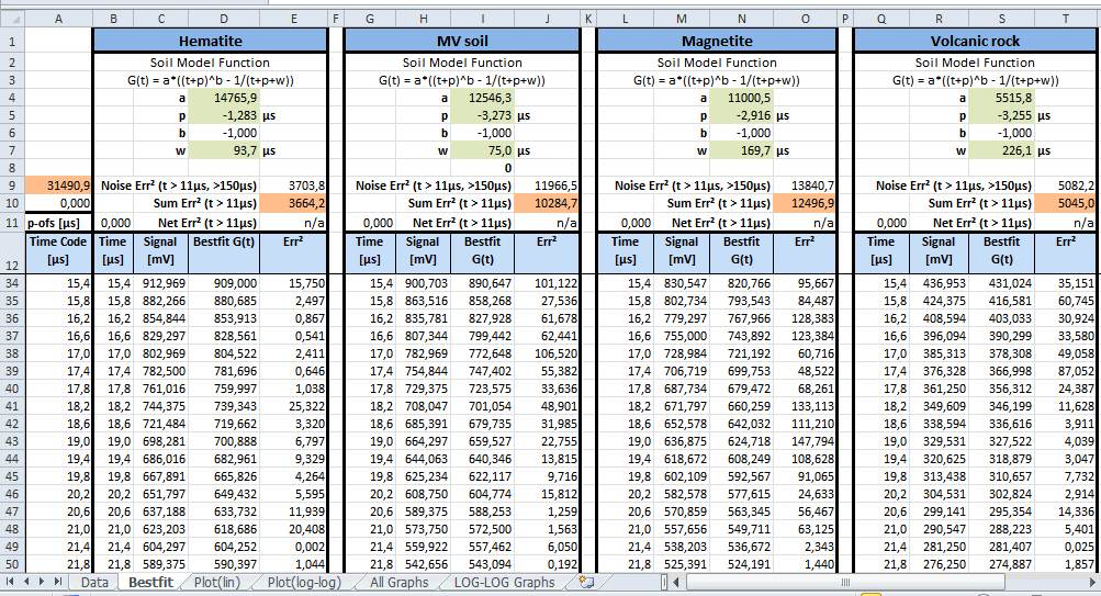

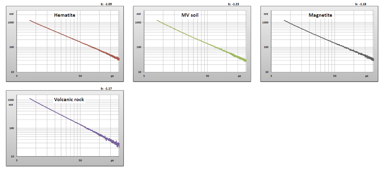

      • Hi all,
        look, what the numerical simulation analysis brought to us.
        I'm referring to the latest data from Thomas I have used last time.
        Provided that, that G(t) is accurate enough (= most correct) we can make two experiments:
        - Find time base correction (p-ofs) and set p=0 everywhere in the data set and tweak all the green variables to minimize the orange fields (Sum Err² of all four samples).
        I get really very nice curve fittings with quite low sum of errors. And the distribution of exponent b makes perhaps sense. So it is obviously varying.
        This is what I get:
        - Assume, that exponent b never changes and stays at b=-1. Set p-ofs=0 and find all individual phase offsets p by tweaking all the green variable fields. Minimize the orange fields.
        Well, I don't get very nice curve fittings anymore. Quite good but I've got seen better results with the first experiment. The Sum Err² is now bigger.
        This is what I get:
        Provided that, that G(t) is accurate enough, the first experiment is indicating a varying exponent b due to less fitting errors. Interesting experiment - isn't it?
        I won't give up to find the answers.
        Cheers,
        Aziz

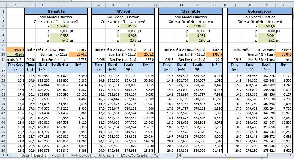

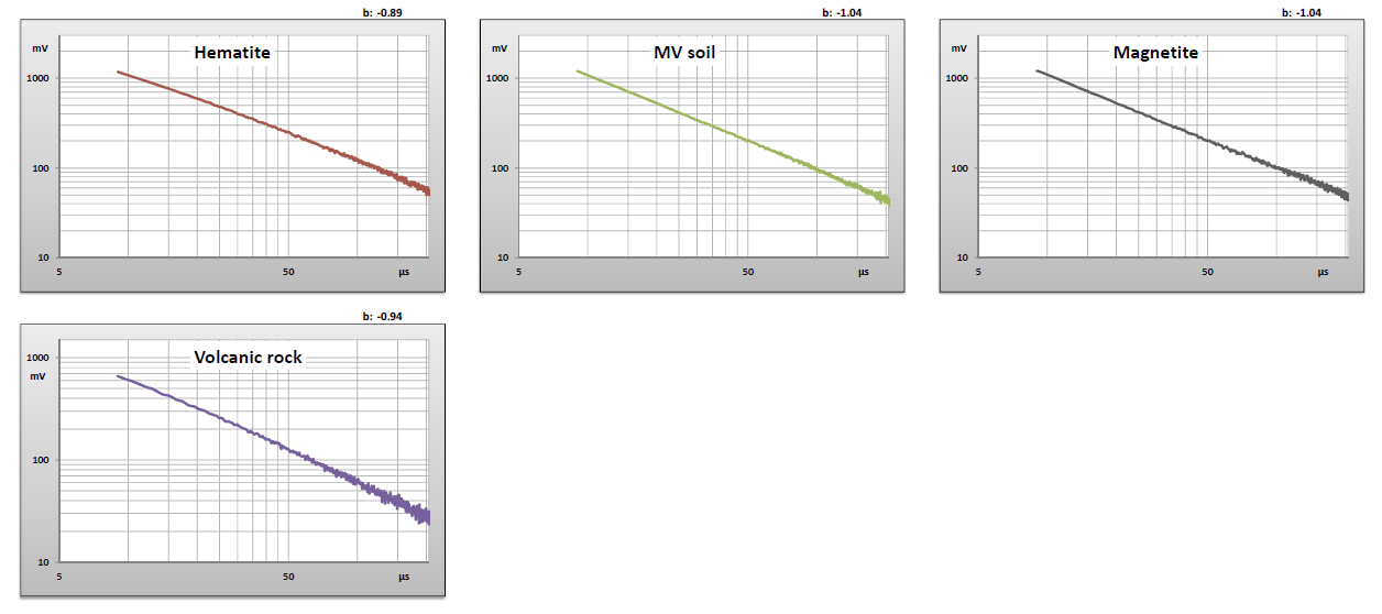

              • And this is what I get, when I make both p and b variable. The time base correction (phase shift) is inherently in the parameters p. But they differ now.
                The error gets slightly smaller and I get very nice best fit curves. But you can easily be get fooled when solving both p and b parameters together. The Excel Solver might not find for you the best solution. Noise in the measurement data and inappropriate starting values for the parameters can force the solver to a local minimum error.
                Cheers,
                Aziz

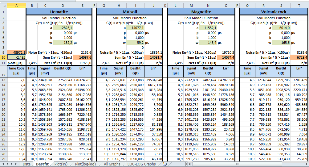

                      • 1A Premium Service Continues
                        Hi all,
                        and this is what I get if I take the original formula 17 mentioned in the scientific publication above.
                        Note, that I have set p=0 (no phase) and exponent b=-1 to we get the original formula.
                        When I solve the best fit for all four measurements with the original time code (no correction made), I get a Sum of Errors² of 133297.5. This is quite large. If I search for optimal time code & phase correction for all four measurements together, the error decreases to 48972.1. This is still large.
                        These numerical simulation experiments on measurement data indicate, that the original formula isn't much correct. That's the reason, why we use the variable exponent form (b) and a phase shift term (p). The new G(t) is fullfilling the requirements and is showing its power by delivering very very nice curve fittings.
                        BTW, the time code of such measurements is very very important. It must be consistent for all measurements. So don't trigger your oscilloscope on the flyback decay signal. Use a very stable digital logic source for the timings (at TX switch-off). The system time delay in the TX clock stages, TX mosfet driver, TX mosfet and front-end amplifier delay must be taken into consideration and the time code needs some correction of course. BTW, that is my variable p-ofs in this case (see Excel sheet). But the variable p (phase shift) can inherently do a time code correction as well if you don't use p-ofs.
                        But what's when the new G(t) isn't correct? Well, we have to find a better soil model function.
                        Cheers,
                        Aziz
