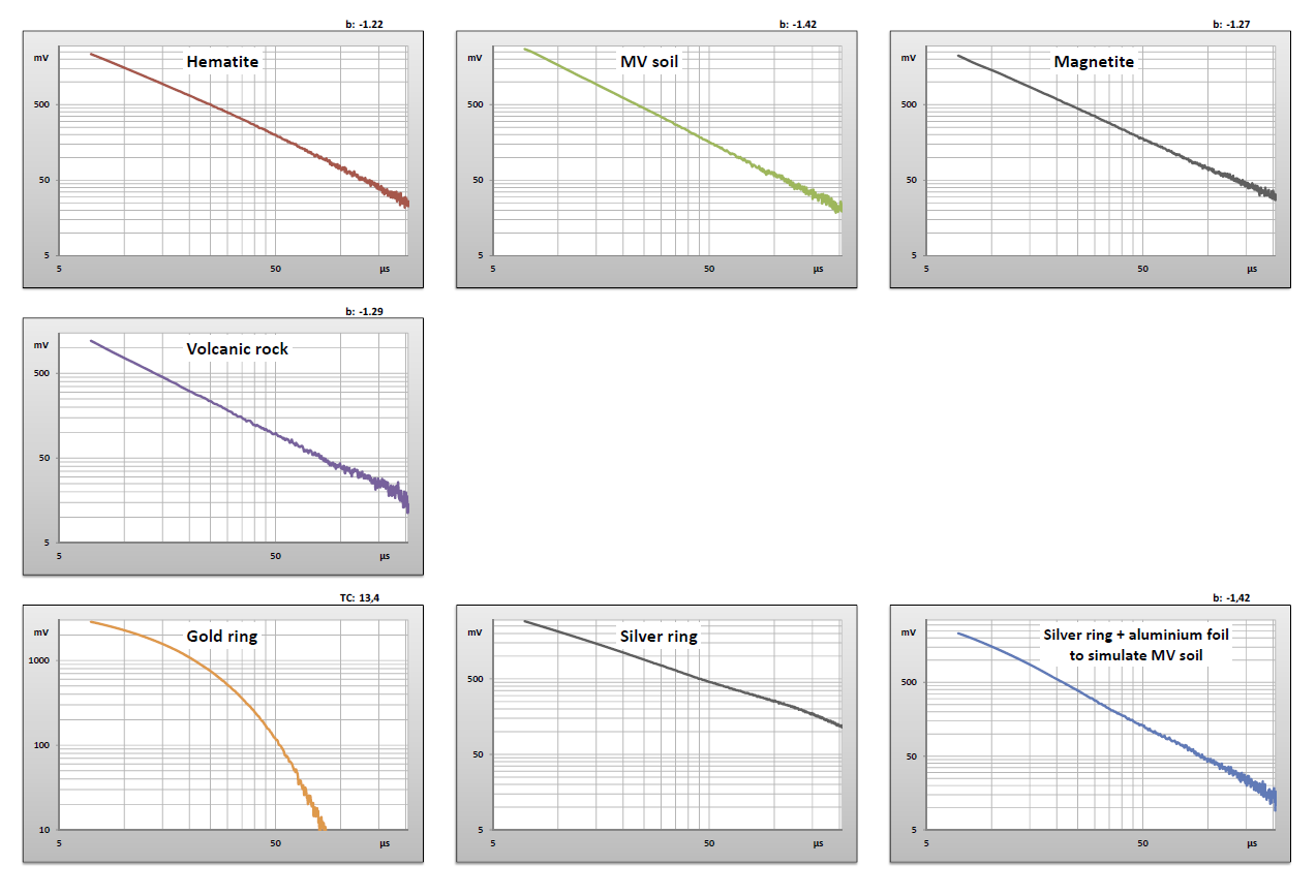

      • New measurements with 7 µs delay
        Here are new measurements with a delay of only 7 µs (i.e. 50 µs TX on, 2 µs TX off, then 7 µs delay). This is shortest time possible with the current setup. Horizontal range: 5 to 205 µs, with the curves starting at 7µs. Vertical range: 0 mV (lin) resp. 5 mV (log) to 3000 mV (1500 mV for volcanic rock).
        Excel file: decay_curves_03a.rar
        Notes:
        • There is no time offset, i.e. p=0
        • The dynamic range is higher (1:100 for the MV soil sample)
        • The hematite curve is not exactly straight in the log-log graph. There is a slight kink at about 30 µs – no idea why.
        • I had to use aluminium foil instead of the gold ring to simulate the viscosity decay. The resulting curve does not fit exactly, but I only spent a few minutes with adjusting the positions of the ring and the foil, so this could be improved.
        Unfortunately, I do not have any Oz samples ...
        Thomas

          Thanks Thomas for your valuable effort. The exponent b is almost in the same ball park for Oz soils.
          See the attachment for the short TX pulses of the above measurements in Oz.

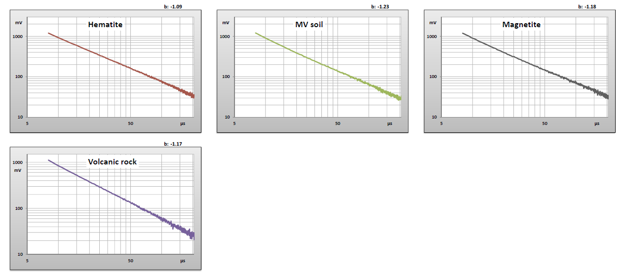

                  • More measuremets
                    I made more measurements to show how the TX pulse widths affect the exponent b. The previous measurements were made with a 50 µs TX on pulse, followed by a 2 µs TX off (flyback) pulse, i.e. quite typical for a PI detector. The flyback pulse is the one that actually induces usable eddy currents in resistive targets and magnetizes the soil. The TX on pulse is counterproductive, so separating it from the flyback pulse reduces or even eliminates the weakening effect. See my post from 24 Jan 2013:
                    Here are 2 sets of measurements with a TX on pulse length of 500 µs. 450 µs of these are constant current, so the flyback pulse is effectively the only pulse that kicks the targets. The first measurements were made with a 2 µs flyback pulse as before. The exponents are closer to -1 now:

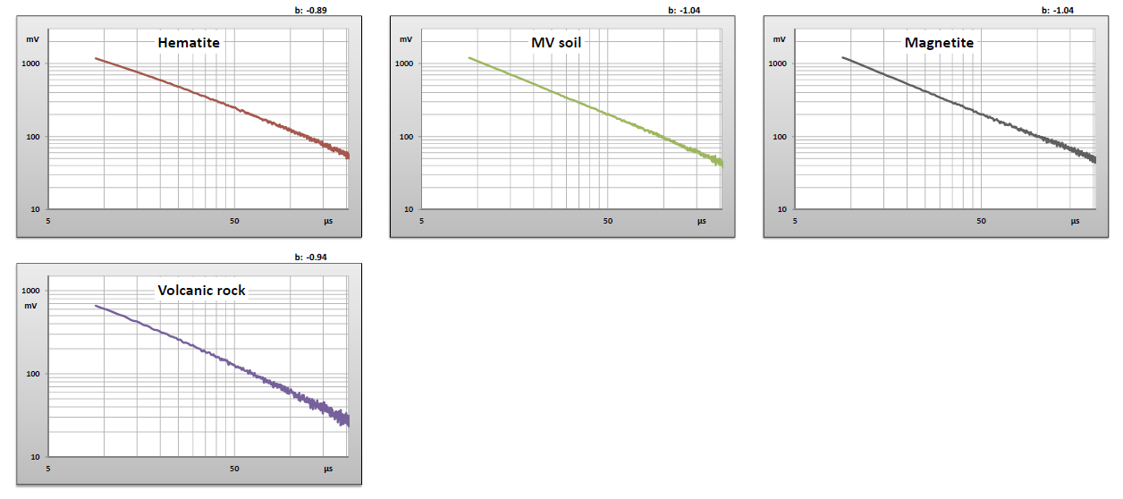

                    With an increased flyback pulse length of 10 µs particles with longer time constants react stronger, and the exponents are getting quite close to -1. This seems to be a timing that is more similar to what Eric uses in his tests.
