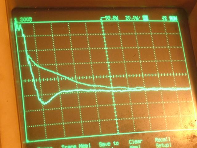

                    These plots were done in 1968 by C. Colani and shows the advanced thinking at that time. All were done with a logarithmic front end amplifier so that exponential decays from non-ferrous targets appear as a straight line decay. Top left is a brass test plate 10 x 10cm. This is the noise free trace. The lower trace is a derived negative voltage level that is proportional to the slope, and that gets noisier as the signal decays. There is some non linearity at the bottom end of the decay, hence the curve. Top right is the trace from a nail which gives a log lin response similar to viscosity. The bottom left photo is for three exponential TCs - 50, 100, and 150uS and also shows the three derived levels. Further details can be seen on the .pdf (pages 8 - 10) attached to Post 65 on The PI History and Theory thread.
                    Eric.
                    [ATTACH]24332[/ATTACH]
                    Very interesting, ahead of it's time definitively. Good old days of Tek 54x scopes and film cameras. Logarithmic display, then differentiated to get deviation from linear ramp, that is 1\t in original signal, fine. Just probably cannot be used for soil characterization this way due to S\N limitations. Notorious issue with log-amp, noise and interference problems became exponentially more visible. Considering bandwidth required, even limited and filtered to, say, 10kHz to 1MHz, this is still two decades, compared to 1Hz or less in integrated measurement, nothing can compensate for difference. Modern day equivalent of this measurement can be using DSO to average out noise from log-amp, transfer data to PC and process with LabView or something similar. Time ago, around 1975, Tektronix produced 7000 series “calculating scope”, with P7001 processor, capable to do this without any external computing. I'm just completing sample holder, something like 5cm diameter, 7cm long coil to put sample inside, will try to measure response directly, but what is expected is maybe 20-30dB above noise floor, not enough. Not even with some cheating, using thermite mixture for sample (and hoping PI cannot ignite it). Pure Fe2O3+Fe3O4 mixture, if we neglect Al, perfect stuff. Will see..

                          • Ended up exactly that way. Particles are certainly not 30nm, more like 30um or larger, very uneven. This oxide part is usually waste product from some chemical factory process, can contain just about anything, not good for this purpose, also not good for reference, different mixtures may behave differently, actually some Thermite types contain no Fe at all. Trying to find some other suitable substitute in form of ferrite. Ordinary soft ferrite is useless, but other types, like low permeability RF materials, or very high permeability, usually highly conductive types, or noncrystalline cores may be.
                            Idea with log-amp and differentiated output is phenomenal. I never before considered using log-amps for any hobby project, chips were expensive and hard to find time ago, but funny things can be done this way. Tried this “discrimination” method as described, well, works perfectly for nails, tools , paperclips and similar stuff, but unfortunately not for bottle caps or any more complexly shaped object. Very strange effects can be observed at shorter pulse lengths. Most objects tend to anomalously fall below it's natural linear (1\t log) curve earlier, some have “early time” bump more visible, some (larger more complex) deviate from linear in both directions during decay... Too many variables here.
                            • Noise floor
                              This is best I managed to get, using brick, this %^&*~! thing is impossible to get above noise floor. TX width around 70uS, but coil intentionally underdumped, so it goes down in 4-5 fast cycles, increasing speed and visibility at early time. Two things I concluded so far, this response is also TX dependent, falls down with pulse width (rendering my double pulse idea useless), getting just noise floor at 3uS, also, process is probably not 1\t. Hard to distinguish from images like this, but ordinary soft ferrite is almost ideal 1\t, trace is just parallel (at some angle) to reference, this one is not (traces averaged x256). With some modifications, fixed TX time, more power, filtering, shielding etc, this can be improved for another 15dB or so, just not sure it is worth doing. Direct measurement may not be the best idea.
