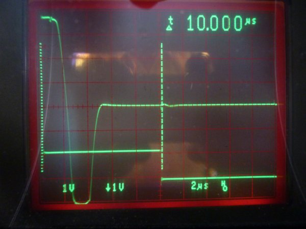

                              For delays <20uS the decay appears to have another faster curve superimposed on it. This should become more apparent when I run a modified timer to observe signals at 5, 10, and 15uS where the discrepancies can be seen. Till now, I thought that it could be an instrumentation error, but as I see it with the faster coil, it may well be real. This has implications for those trying sub 10uS sampling, as the amplitude will rise even faster than it does with the fundamental decay.
                              Eric
                              [ATTACH]25626[/ATTACH]
                              This is interesting, I noticed something similar. By all chance, there are actually 3 exponents. First, usually fastest one is dictated by coil and changes only with coil, another one, lasting to about 10uS is target related. Varying with shape and material, in not quite logical and predictable way. Also, strongly dependent on pulse width, gradually fading out at very short pulse excitation. After that, 15us or so later, everything is quite regular single exponent. How this can affect real detector is less important, very fast setup is needed for this effect to be visible. I'm using old and obsolete LM733 (NE592) video amplifier, in fully differential connection, but at least no speed limit and recovery issues with it, measurement after only few hundred nS is possible.
                              Another interesting effect I noticed is related to flyback release time and shape. Mostly related to “wet sand effect”, I can be wrong with this, but here is my conclusion, may be relevant to soil samples too, so please correct me if i'm wrong. I never figured out what is exactly going on with this wet sand stuff, salt water alone, or sand alone produce no response, but in right combination (and right sand type, ordinary sand for construction work will not respond, something grain size related probably), problem appears at short delays. Now, effect that looks like very short TC object happens. Only, problem is by all chance not initiated by TX pulse, independent on width, but by flyback cycle dV\dT in relatively low conductivity medium. Slower rate of change produce less effect, exactly opposite of what fast coil designer is trying to achieve. Not only longer sampling delay, but intentionally slower coil seems to help here.
                              I played with this effect, and figured out that intentionally underdamped coil, with flyback release in form of one complete ringdown sine cycle significantly reduce response. With flat spiral coil, each cycle is only 1.5-2uS, so delay is reduced only by 3-4uS, still fast enough, but more stability with same delay compared to “optimally” dumped coil. Even, at some empirical adjustment, consisting of 5-6 cycles of exponential ringdown, large, some 500g ferrite is completely ignored by detector, everything else being unaffected?!? Unfortunately, not soil sample or red brick, so nothing about “passive” ground balance. Still this may affect response from low conductivity soil samples, also may be interesting for underwater detectors. Any idea, what i'm missed, my measurement error or something else, these effects are real. Devil is in the waveforms , positively.

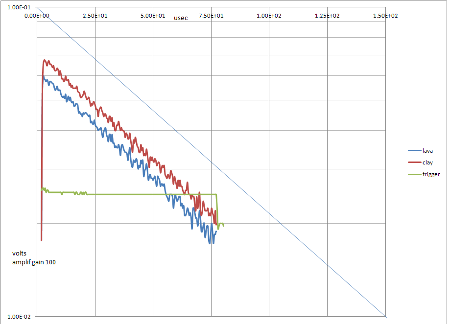

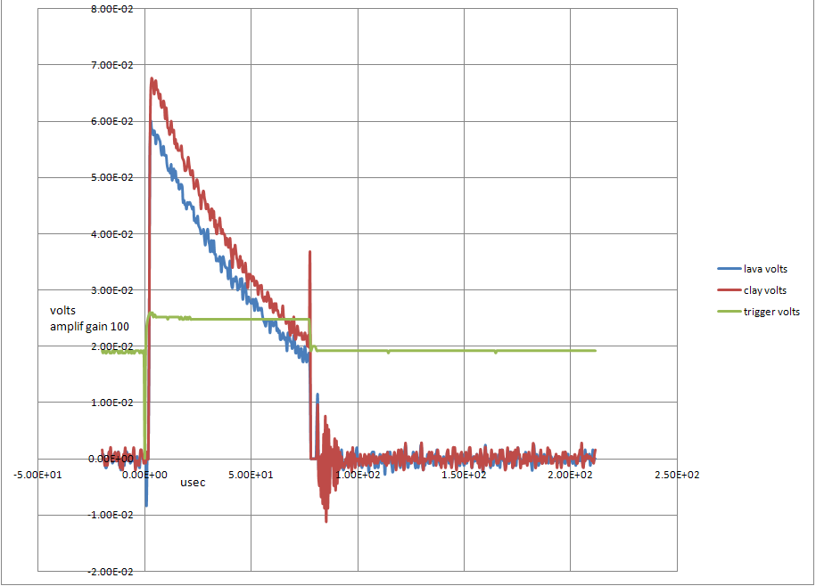

                              • I've been playing with a PI circuit with a DD coil looking at coil on and off signals. I tried a piece of landscaping lava rock and some clay from the yard. I get a signal during on time, not much if any during off time. Exponential, 300usec TC. Should I expect the on slope to be different than the off slope(power)? Are my samples not typical? Excel plots, target - reference.
ID:	337273Click image for larger version
