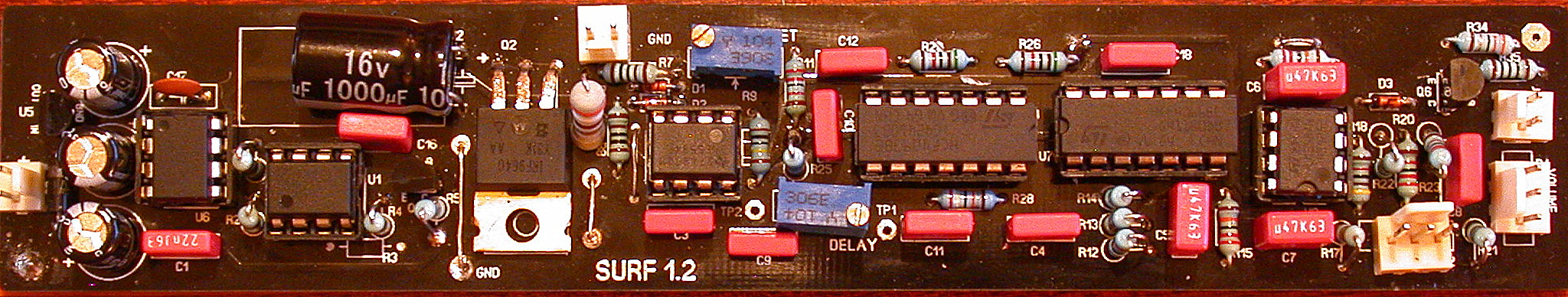

                    Can you post a clear in-focus image of your PCB, just in case someone can spot the bleeding obvious?
                    • #70
Name:	surf pi v 1.2 002.jpg
ID:	337076 my board hope this is clear enough please note r3 is underneath but is there !
                      • #71
                        Check twice where you soldered R3, connected to pin 4 instead of 3 will cause exactly same symptom and similar voltage readings you have. Voltages you measured are strange, indicating transistor is nonconducting, or maybe faulty (possible B-E breakdown, despite you measured it on Hfe test, peculiarity of some DMM types, intended to measure only working component). Certainly not failure type I described earlier.
                        • #72
                          I agree. The fault definitely must be located in this area, despite what the meter indicates.
                          Alcartraz - Please try replacing Q1 with a new transistor and move R3 to the top side of the PCB.

                            I have been closely following this thread because I have the exact same problem with my surf pi 1.2 since the beginning.
                            Now that Qiaozhi has narrowed it down to Q1 I took mine and had a good look at it with the schematics in hand.
                            The leg of Q1 that goes to R4 are right next to each other and were soldered seperately I now bridge soldered them and..........UREKA!!!!
                            now my detector works like a charm and even the delay which never made any difference now works.
                            I have to thank Qiaozhi for his dedication and patience with this matter. It really shows a lot of character. I salute you sir.

                              I just did a continuity test between Q1 emitter and R4 on a blank PCB, and the connection is good. Therefore, it sounds like you either had a break in the track, or there was a dry joint.
                              At least that's one Surf-PI which is now working, and helps to confirm that Acartraz's problem must be a similar issue.
                              Thanks for the feedback.
                              • #75
                                ok i wish mine was that simple new q1 resistor back in place and still the same made no difference and tried a new coil as well
