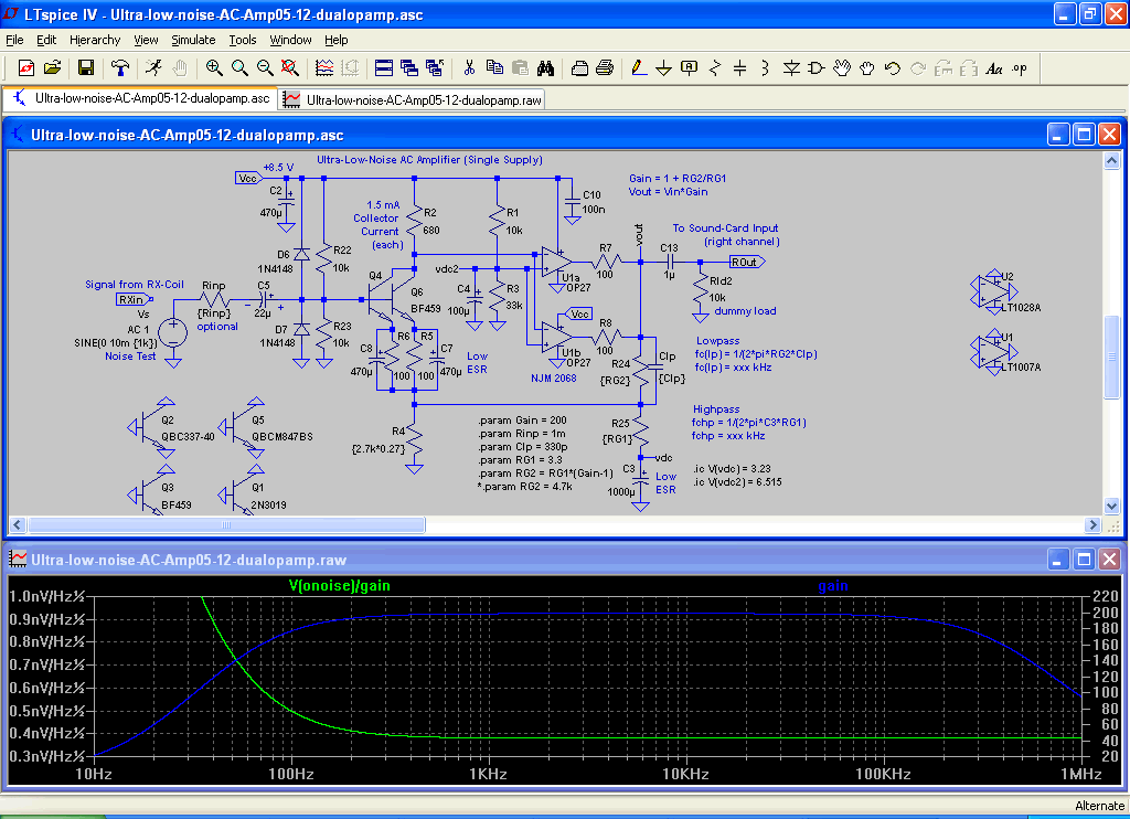

Very Ultra Low Noise AC Amplifier
Hi all,
I have forgotton to mention, why the perfect matching of the transistors isn't much important here:
We don't have a differential pair amplifier topology here.
Just parallel the (input) transistors and take care, that they have enough collector current for each transistor. I have chosen a collector current of 1 - 2 mA each (actually 1.5 mA).
And we can load balance the emitters with one elco and one 100 Ohm resistor for each transistor.
Ok, I have taken the OP27 for the NJM2068 for the noise performance simulation. Both have around 3 nV/sqrt(Hz) noise density. So a dual op-amp can be used to minimize further noise and has more current drive capability in the gain resistor divider network. You can use the OP27 for the single op-amp version too. Just take care, that the resistive load does not go below 600 Ohm. You can use a series resistor at the op-amp output (just like in the dual-opamp version) if you have a very small gain resistor divider network (< 600 Ohm series).
You can use the NE5532 too. The noise density spec just increases marginally (totally neglectable IMHO). But the OP27 is a better choice for the single op-amp version (has more output voltage swing).
And you can use a single transistor as well. Then leave the emitter load balancing part (elco + 100 Ohm resistor). Noise density still way well below 1 nV/sqrt(Hz).
This is just to give you some ideas:
