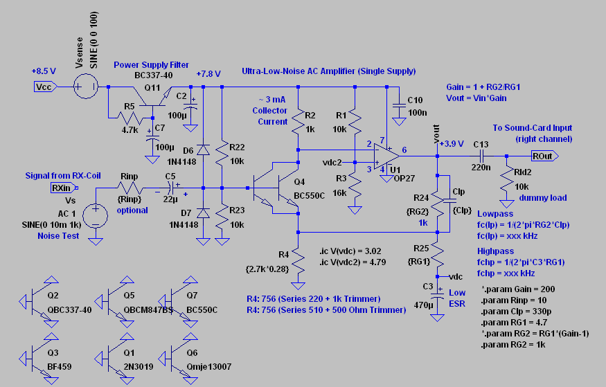

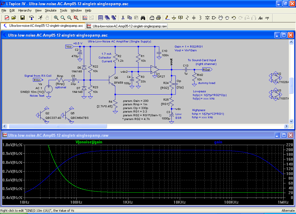

    And this is the single transistor, single op-amp version (OP27). Still below 0.5 nV/sqrt(Hz).
    Note, that OP27 has minimum load drive of 600 Ohm. In this circuit, it has 3.3 Ohm*200 = 660 Ohm. We are above 600 Ohm. That's ok.
Name:	Ultra-Low-Noise-AC-Amplifier-SingleTR-Single-Opamp-Version (OP27).gif
    I will use this amplifier in my next laptop detector controller project. It has been optimized for 8.5 V single supply voltage therefore. The 8.5 V needs to be stable of course (from LDO voltage regulator). And no transistor matching required.

    • #62
      Um didn't we want it low noise at 3 - 10 hz? That's the noisy part in most designs...
      • #63
        Hey Silver Dollar,
        the voltage noise density gets high at lower frequencies, but the gain is low too. Voltage noise density isn't equal to total noise energy (integrated over a frequency range). And there is an inherent high pass filter.
        In my application, I'm using frequencies above 1 kHz. That's the reason, why I can use the simple AC amplifier. All low frequency region isn't important to me.
        The low frequency amplifier noise isn't important in a PI as well, which has the static magnetic field/geomagnetic field cancel feature.
        Aziz

          C5 will blow... Boom.... Everything else looks attractive, in simulation. Lets wait for results of soldering.
          Magnetic field/geomagnetic field cancel have to be balanced well to kill that low frequency noise. With 5% tolerance capacitors it may let some part of noise to pass.
          • #65
            No, C5 won't blow. It has the right polarity.
            There isn't any serious input high voltage protection there (except the two diodes). I hope, I don't have to increase the series input resistor.
            Booooooooooooom! *LOL*
            Aziz

              The latest ultra low noise AC amplifiers won't work in your standard PI circuits of course. They aren't DC coupled as you would require in most PI circuit cases.
              They presume the induction balance (IB) coil configuration, where the high voltage from the (transmitter) coil is absent. They require very low impedance path to the RX coil to achieve the superior low noise performance.
              In the traditional PI:
              You have the 1 kOhm series resistor with anti-parallel diode high voltage proctection circuit usually. Unfortunately, the 1 kOhm resistor connected in series to the coil will kill all of the low noise performance. The resistor noise density of 1 kOhm is approx. 4 nV/sqrt(Hz) and you can dream of ultra low noise designs. We would require a low impedance path switch via input fet switch to overcome the 1 k series resistor.
              I might increase the 3.3 Ohm resistor to 4.7 Ohm or even 10 Ohm. And I might put a 10 Ohm series input resistor just to limit the current during the high voltage spike periods (if there). And the noise performance will be affected slightly but I would have a save operation.
              Cheers,
              Aziz

                  Some Noise Figures
                  Hi all,
                  I have increased the RG1 to 4.7 Ohm (from 3.3). Depending on the input resistor Rinp, I get the following noise figures:
                  Rinp = 10 -> 0.64 nV/sqrt(Hz)
                  Rinp = 22 -> 0.8 nV/sqrt(Hz)
                  Rinp = 33 -> 0.9 nV/sqrt(Hz)
                  Rinp = 47 -> 1 nV/sqrt(Hz)
                  (Rinp = 1 kOhm -> 5.4 nV/sqrt(Hz) )
                  It seems, that I can have some input protection up to 33 Ohm input series resistor and I'm still in the ultra low noise ball park.
                  The power consumption is around 6 mA. Oh well, I can live with it.
                  BTW, one have to set the operating point accurately by adjusting the emitter resistor (R4). Set R4 to get the average output voltage in node vout (output of the op-amp) at Vcc/2, so 8.5/2 = 4.2 V. Best done with a combination of resistor and trimmer network.
                  Cheers,
                  Aziz
                  • #69
                    Alternate BJT Transistor
                    Hi all,
                    I have found another good BJT transistor:
                    MJE 340 (0.27 EUR)
                    As good as BF 459.
                    You can use NE5534 instead of OP27 of course. But the OP27 performs better.
                    NE5534: 0.25 EUR or 0.33 EUR A-grade
                    OP27: 1.70 EUR
                    Aziz

                            • #74
                              Improved PSRR
                              Hi all,
                              the initial amplifier circuits were prone to power supply variations or high frequency regulation ripple/noise. This improved version greatly improves the power supply rejection ratio (PSRR). Although, we have some voltage drop loss of approx. 0.8 V, there is still enough voltage swing range for the output.
                              Notice: the power supply filter has been "stolen" from the AN-222 publication mentioned here.
                              I have taken two parallel transistors without emitter load balancing. This is just a preparation for the intended BF459 usage. Note, that the 10 Ohm input resistor greatly degrates the noise performance. I hope, I can reduce it in the real usuage. Fingers crossed.
                              The new schematics:
Name:	Ultra-Low-Noise-AC-Amplifier-DualTR-Single-Opamp-Version (OP27).gif
                              Did I win the great prize? *LOL*
                              Cheers,
                              Aziz
