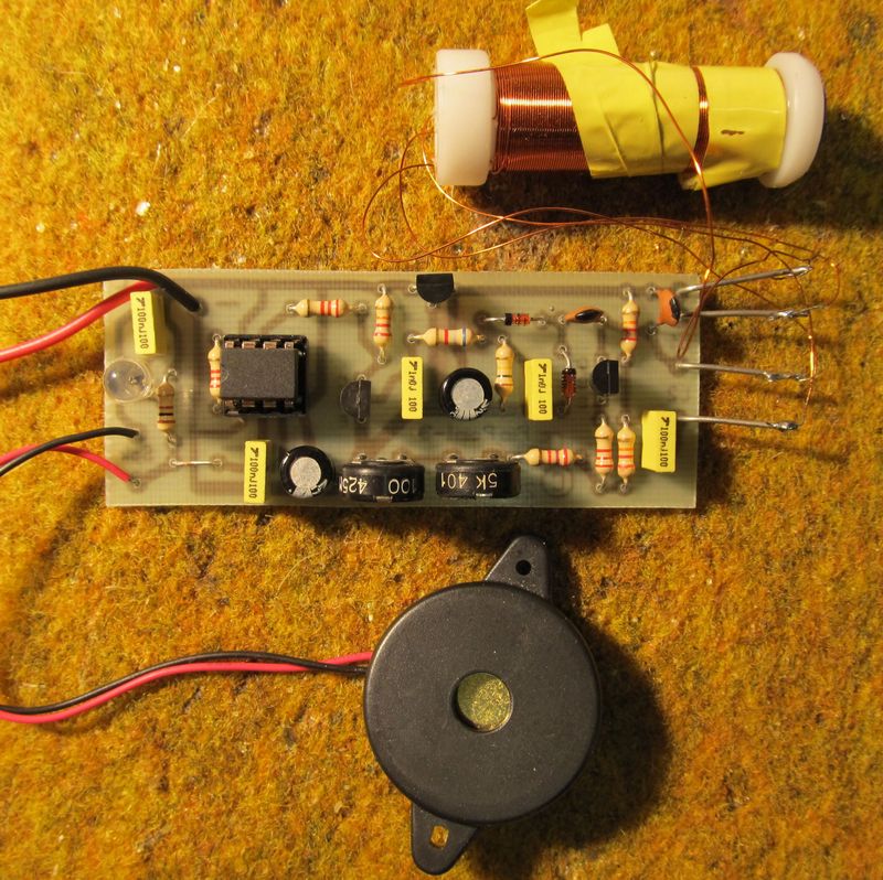

Another Pin Pointer.
  • Another Pin Pointer.

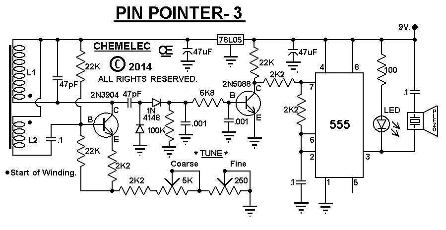

    Another Quite Sensitive Pin-Pointer.

    Looks nice
      Yes, nice minimalistic design.
        nice schematic any chance of the coil specs?
          nice job.
            CORRECTION on SCHEMATIC.
            Also See the Coil Info on it.
            But I have made Numerous Different coils also.

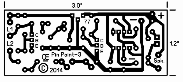

            The PCB Artwork will be posted Tomorrow

                The PCB Artwork.
                  how do you accurately resize images like this ?, for direct printing?
                    By using graphic application with dimension ruler on top and side.
                    Even with MS Word this is possible.
                    Insert PCB drawing in document and resize it to suit dimensions on ruler.
                    Then you can make test print and check inter-hole dimensions with real IC (here NE555).
                      Well done Garry, Thanks for sharing, Anyone wanting to have a go at making there own PCBs this is a good time to start nice easy what I call sensible layout.
                        Download Libre Office, its free and open like Linux , Far better than Microsoft
                          I Use "ACDSee", to Resize Pictures.
                          "Paint Shop Pro" or "Ipplus" will also Resize Pictures.
