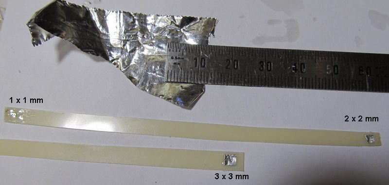

        Cutting a .02mm Thick piece of Household Aluminum Foil.
        See Picture:
        1 x 1 mm square, Detection distance is 5mm
        2 x 2 mm square, Detection distance is 1.3cm
        3 x 3 mm square, Detection distance is 2.1cm
