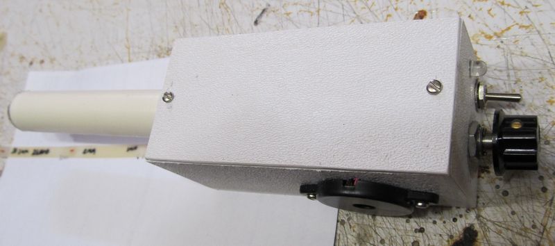

          I'm in the process of making a Box for it and finishing it off.

                  It is All Apart, Making a Case for it.

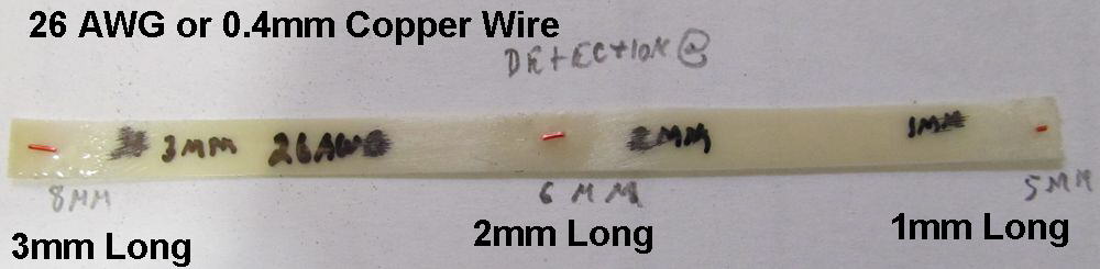

                          Originally posted by Harp View Post
                          Hello chemelec!
                          For the purpose of information, can you give me the following information, with your most precise coil, to compare data with other pin pointer:
                          Distance (mm) of detection for:
                          Aluminum foil of chocolate: 3x3mm, 2x2mm and 1x1mm
                          Copper wire 0.4mm diameter: 3mm, 2mm and 1mm
                          Thank you!

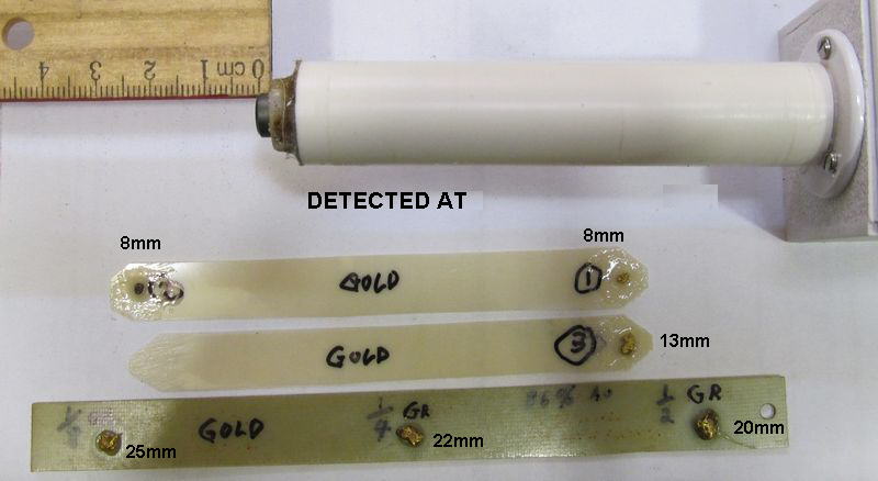

                              It does not work out for me to do a Video
                              And I do Not have any Chocolate bar Foil.
                              Besides they can Vary Considerably in Thickness.
                              But here are Some Pictures and Test Results.
                              EDIT NOTE: I Accidently Reversed the Distances on the 1/8 and 1/2 Gram Nuggets.
                              So SWAP THEM.
                              A Canadian Penny at 55mm
                              A US Quarted at 60mm
                              Bottom of a 454 Gram Steel Propane Bottle at 90mm
                              Now see Pictures for More:

                                I Found the one showing COINS.
                                But I DON'T see any Info on Detection of those 1mm, 2mm and 3mm, 0.40 Copper Wires.
                                Not on that Foil either.
                                So Where is it?
