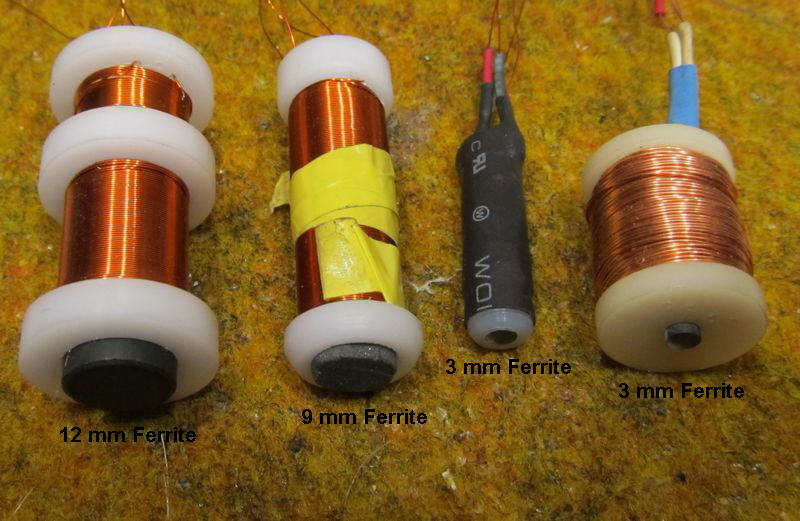

    Here are Some of the Coils I Made.
    Bigger Diameter Ferrites Detect at Greater Distance.
    Smaller Ferrites Detect at Less Distance, but More Accurately "PIN-POINT" the Exact Location.

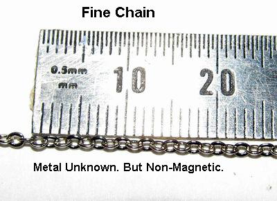

    Also the "Fine Chain" I used for testing.
      What is your suggestion for wire (diameter) used?
        Not Critical, But I used a 30 AWG on most of them.

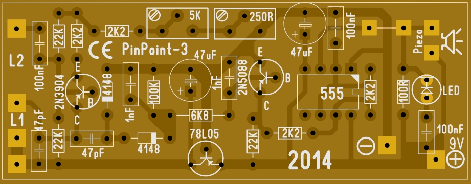

        On that Bobbin with the 12 mm Core, L1 is 1 mH and L2 is 80 uH.
        It Requires a Lower Total Resistance on the Pots and 2K2 resistor.
        So that 2K2 Resistor needs to be just a Jumper Wire.
        I only Added in that 2K2 Resistor so I could use Lower value Pots to make tuning Easier.
        If Wanted, You can Totally Bypass it.
          Using that Black Colored Coil with the 3 mm core that I Posted earlier, It Easily detects that Fine Chain at just over 1 Cm.
          And this Detector Holds Quite Stable.
          I only used Trimpots on the PCB, because I don't have any Low Value Pots below 1K.
          A 500 Ohm, 10 Turn Pot would be Really Good for the Fine Adjust.
          Or Bypass the 2K2, use a 10K Coarse Adjust and a 100 Ohm Fine Adjust.

                        Hi Garry,
                        Do you have the pin out voltages for the transistors and 555 for trouble shooting as I am having trouble getting mine to work the only diference on mine is I used multiturn pots and the coil's are wound on a piece of 10mm diam. ferrite rod as that was what I had in the junk box with out power connected and with the 5K pot set at 2,5K and the 200 ohm pot set at 110.2 ohms the peizo sounds off but nothing with power conected.
                        Regards, Ian.

                          I Doubt Those Voltage Measurements will Help you.
                          First Measure the Voltage Across the .001 Cap at the Output of the Diodes.
                          If you have NO Voltage there, Your Oscillator is NOT Oscillating.
                          Are your Inductance Values Close to my values?
                          (If No Voltage, Check Polarity of Coils.)
                          Possibly Reverse Just One and Try Again.
                          Gary

                              Hi Gary,
                              The voltage across the cap is .17V the inductances are with in 1 or 2uh they were perfect when I hooked it up and I am pretty certain that they are the correct way round I am inclined to think one or both the transistors may be out as I inadvertantly hooked it up wrong way round on first attempt when it did buzz all the time I replaced the 555 and hooked up the battery corectly so trying to find what is cooked the 2N 3904 has voltages on the pins but the 2N5088 does not you know you have to let the smoke out at least once on a project Hi.

                                Hi Ian, Is your 5 Volt Regulator Still OK?
                                Voltage at the cap should be about 0.6 Volts with NO Metal Present.
                                As Metal Approaches the Coil, This Voltage goes LOWER.
                                With No Metal Present, Voltage at Collector of the 2N5088 is about 4 Volts.
                                As Metal Approaches coil,This voltage RISES, possibly up to about 7 volts.
