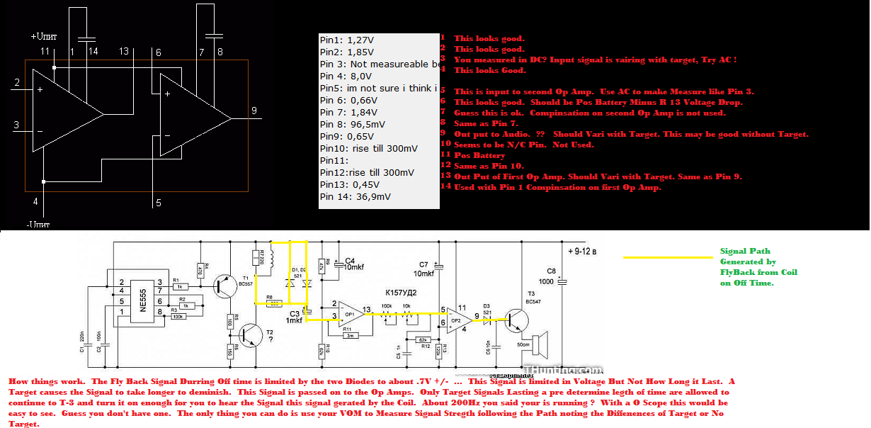

  • I had the black probe at negative rail(battery minus) and the red probe at the pins, voltages are like in the picture.
    I dont have the third diode like in your pictures, but i think you mean the two in the middle.
    I need to test the voltage after the diodes tomorrow. Maybe thats the problem.
    • Third diode is just to stop someone from hooking up the battery wrong. The Two Back to Back are the Limiting Diodes.

        • The Voltage Readings taken with Neg Reference are meaningless on the Op Amp inputs. You need to Reference them to Pos.
          • Ok, i have this voltages with pos reference:
            Pin1: 1,27V
            Pin2: 1,85V
            Pin 3: Not measureable because it changes and sometimes the speaker makes a short crack
            Pin 4: 8,0V
            Pin5: im not sure i think i have forgotten this pin , the next two pins are 6 and 7 or 5 and 7 , im not sure , but i think they are 6/7.
            Pin 6: 0,66V
            Pin 7: 1,84V
            Pin 8: 96,5mV
            Pin9: 0,65V
            Pin10: rise till 300mV
            Pin11:
            Pin12:rise till 300mV
            Pin13: 0,45V
            Pin 14: 36,9mV
            I had 300mV after the diodes before , but only for one time. After that it was always 7,8V.
            The rail which supplies the K157ud2 from the left side had 7,8V too.
            • Ok, now your getting places. From your Reading the Op Amp looks to be OK. You need to check Out puts to see if they vary with target or not.
              • I dont know very much about electronics. Can you tell me what do i need to get a sound from a speaker? Which signal is it? How much volts, oscillating or not?
                I still have about 7,8V after the diodes.
                • Use the Trouble Shooting Aid I built for you. You need to follow the Signal through the circuit. the Audio is generated by and comprised of the Signal Generated by the Coil during Switch switch Off time. That in turn is forwarded to the Op Amps. In this simple PI, Only a signal of sufficient power is allowed to Pass on to the Audio Section.
                  Without a Scope this is no easy task. Use your VOM starting after the First Op Amp and look for Changes of No Target and Target Signals. You should see some differences in signal strength. Next Move to Pin 9? Out put of second Op Amp. Center your Pot. Note your Voltage NO TARGET. Use the Pot or Pots to adjust as so you get the most change in signal from NO Target to Target signal. When this signal is at it's most Positive the T-3 should turn on and you hear the signal.

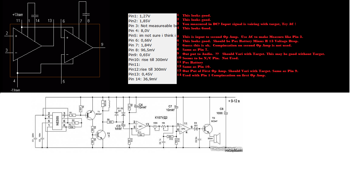

                        • Okay, i made the measurements:
                          Pin3 AC : 0,047V not varying with target.
                          Pin 5 AC: 0,150V not varying with target
                          Outputs of the op amps:
                          Pin9AC: 0,012V
                          Pin11AC: 0,007V
                          both outputs not varying with target. How much should they vary?
                          How much voltage should i get after the two diodes and before the capacitor. I have almost nothing here measured with positive reference. And i had something about 1,5 V with negative reference. I can remember that my multimeter showed something about 7,8V yesterday. I also have now a frequency at the left bar where the damping resistor is at about 0,45kHz. How can this be?
                          Diodes?
                          Coil Specs:
                          I use the coil from my easytreasure bfo: about 15cm diameter and 12-15 Turns with 0,3mm or 0,25mm enamelled wire. The whole setup worked before like it its, so i dont think that the coil is the problem.
                          The coil was attached this time while i made the measurements.
                          • Something is wrong for sure. You need to confirm your Fet is Firing. If you place a speaker in side the coil loop you should hear it Humming if it's working. If nothing we figure out what is wrong.
