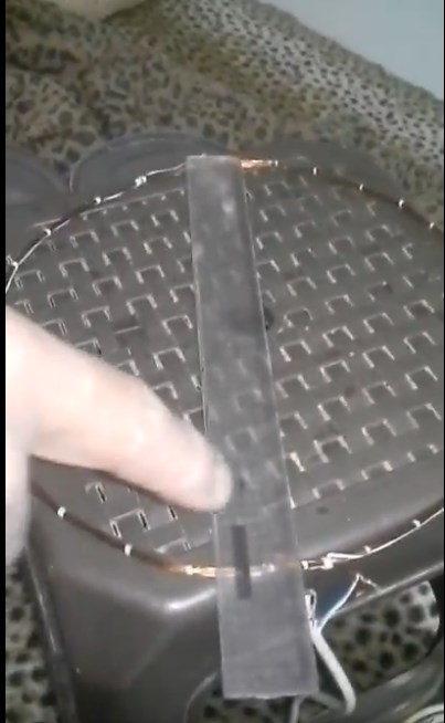

    • Hello Hammerhead, good videos thanks, could I ask you a question just to clarify two things, on the video you say the coil is 26cm but then with the ruler you say 20cm and also do you say that the coil has thirteen turns يتحول 13
      is that correct ? thanks I hope google translates the correct word

          Coil 26 cm 13 Turns Coil and Bronze 0,6mm
            Thank you for the reply
