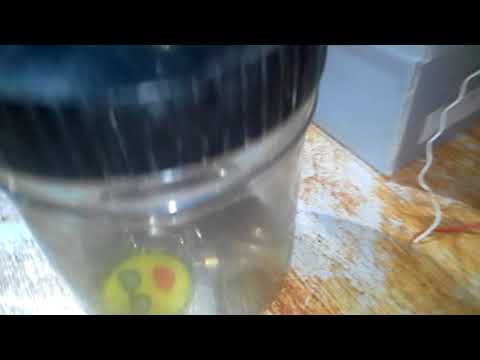

Your student has succeeded in building a pirate my friend https://youtu.be/7QtBcQ9Yxjw?t=3Originally posted by Arionas View Post
