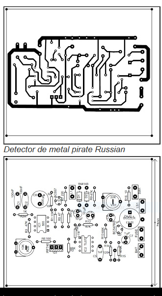

        • #79
          Damn , i printed it at the wrong side, and already etched it. lol
          I need a new layout file. Can somebody give me the layout file from this three pictures: http://blog.novaeletronica.com.br/en/detector-de-metal/
          I dont know how to print the pictures in the original size. I have all parts from this layout , its just a bit bigger.
          Or is it the same as the other ones?
          • #80
            Open this i and it will come out to size.Click image for larger version

                • #83
                  I think what is going on is you have your print set to fill page. Put setting to Print as is. The PCB will come out the correct size.

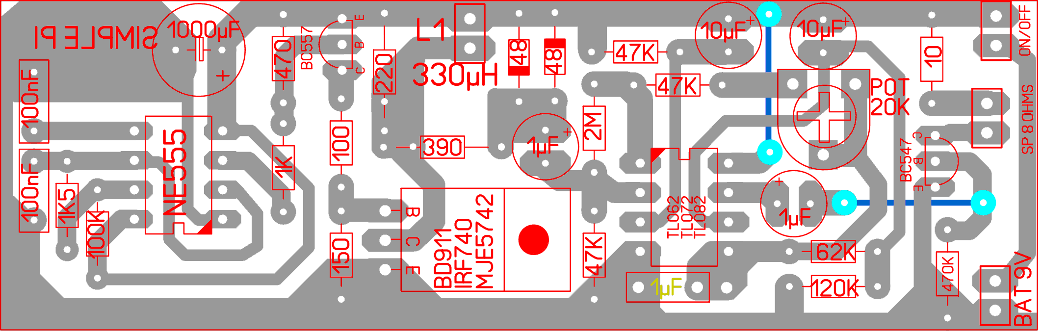

                  • #84
                    I found a layout from simple pi, looks like it is the same.
                    Need a .lay file if possible. I will try it tomorrow.
                    It's from this link: http://www.thunting.com/smf/pi_desig...t21224.30.html
                    But i dont have an account on this site.

                      • #86
                        Just build the TL072/71 version.

                          [QUOTE = BKY1337; 231282] Lol
                          Or is it the same as the other ones? [/ QUOTE]
                          My PCB drawing made in February / 2013......
                          The last two videos are mine too.
                          Very poor operation.
                          I find that without original k157ya2, it does not work......
                          It follows files, including PROTEUS ARES if one wants to modify.
                          https://drive.google.com/open?id=0B4...UhfbVVGZEpzWms
                          • #88
                            don't work very well... ...
                            • #89
                              LOL, Drill it and Solder from the top. Ugly but works.
                              • #90
                                Well some thing else is wrong then. Nothing wrong with using the o71 or o72. These are about as simple of a PI circuit as you can get. Not even a Delay line other then one cap.
