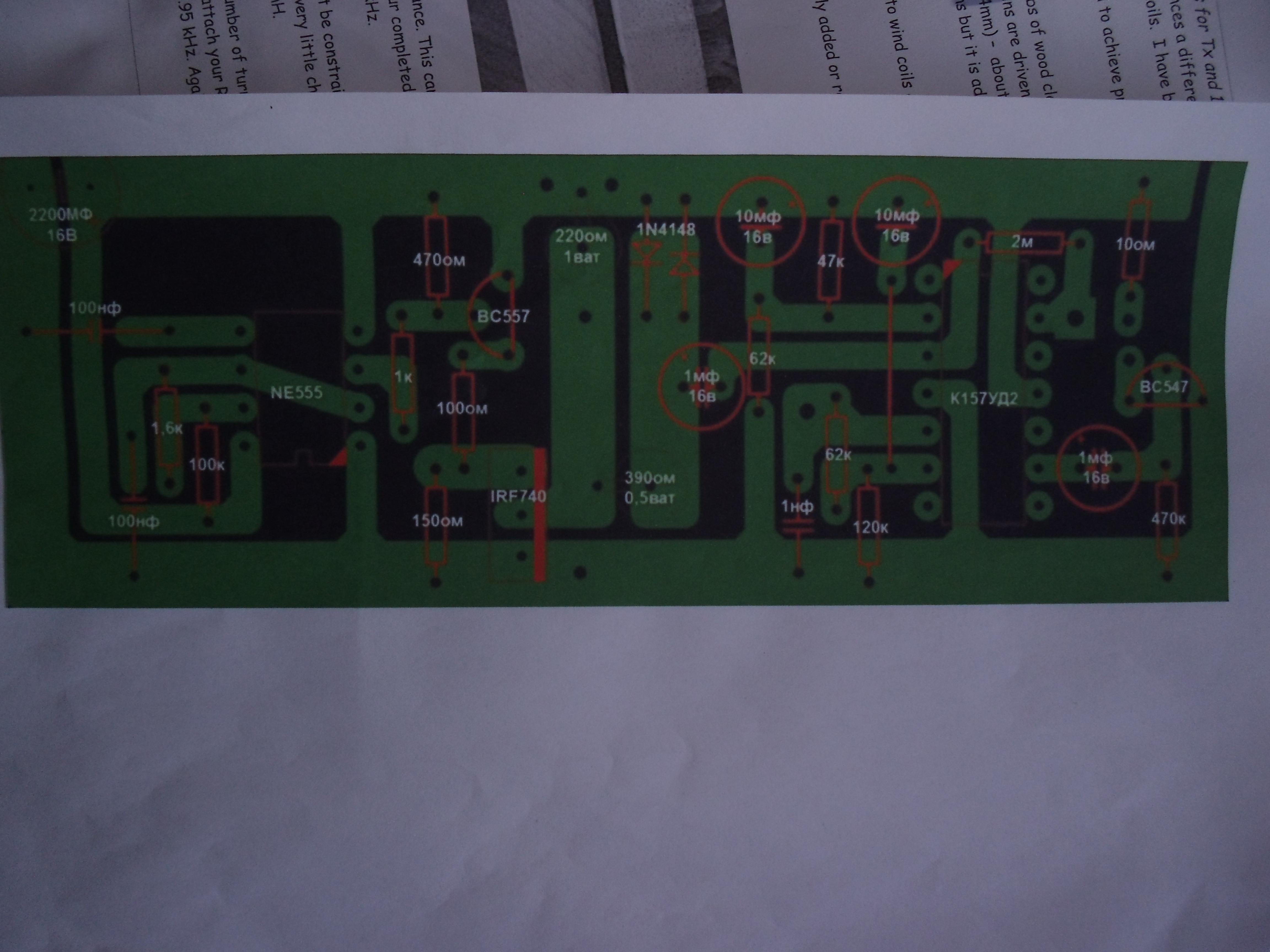

    Yes i wanna see the smd layout.
    Hi Bky1337 I hope that this image will help youClick image for larger version

      Thank you , this is maybe the simplest version of the Pirat. Mine is almost the same but with a 14 pin russian ic instead of the 8 pin TL072.
      I cannot wait till next week when my parts arrive, i think i will try this version because i have TL082 as replacement.
      Im confused because one is with 14 pins and one with only 8 pins.
      Thanks.

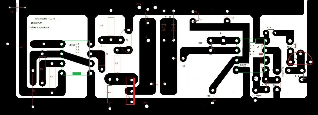

      • #63

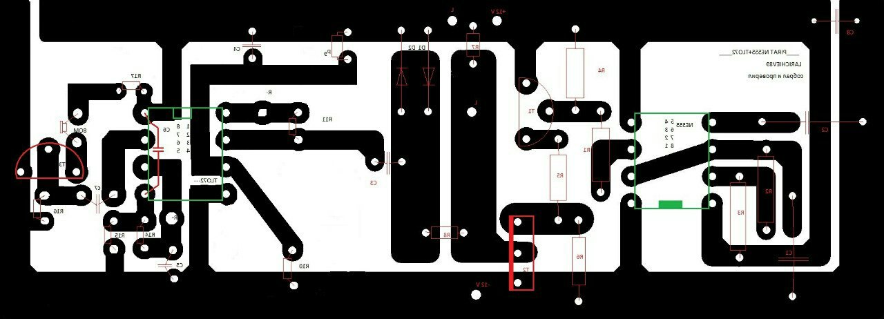

        Pirat SMD TL072
        • #64

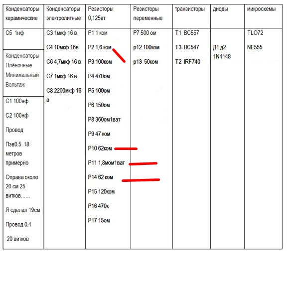

          Thanks, im building the version from you but not the smd one, i have problems with reading the parts. Can you write them down for me pls in english?
          • #65
            I only see two words in russian (in the schematic):
            частота - frequency
            длительность - delay
            мкф - micro farad

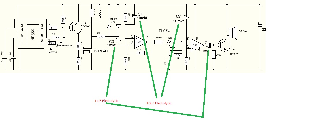

            • #66

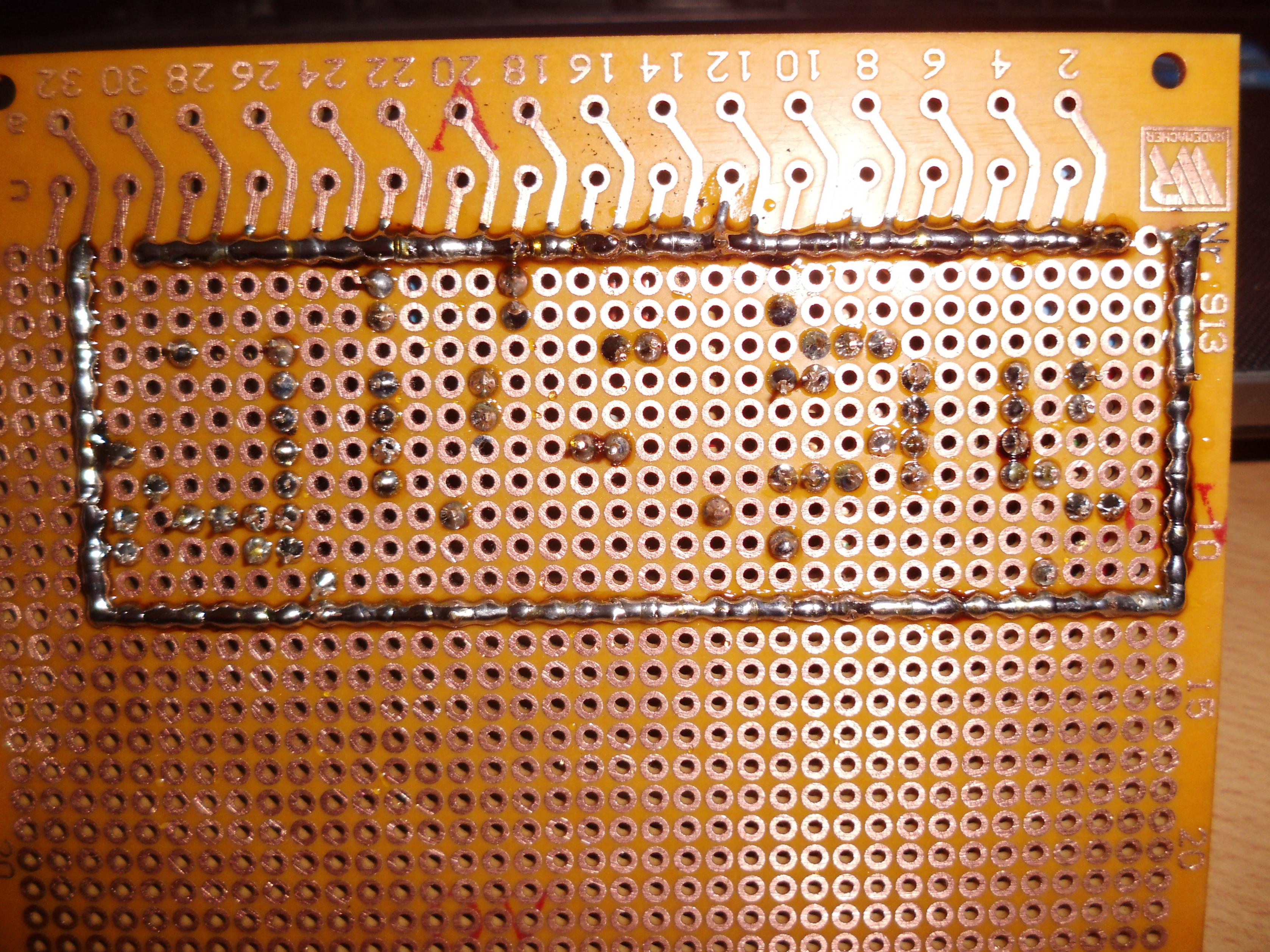

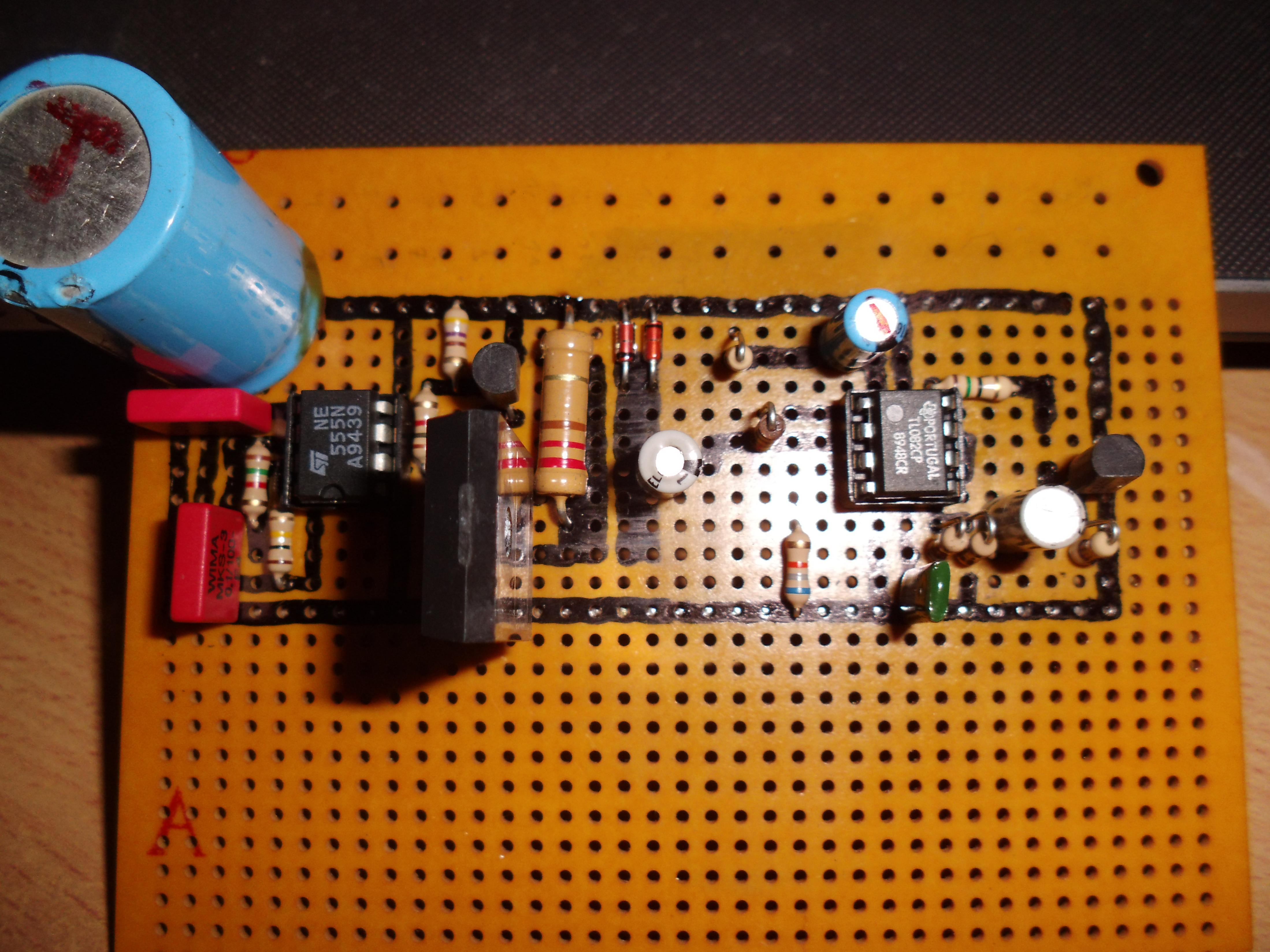

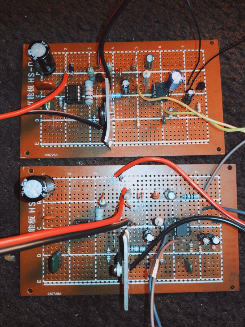

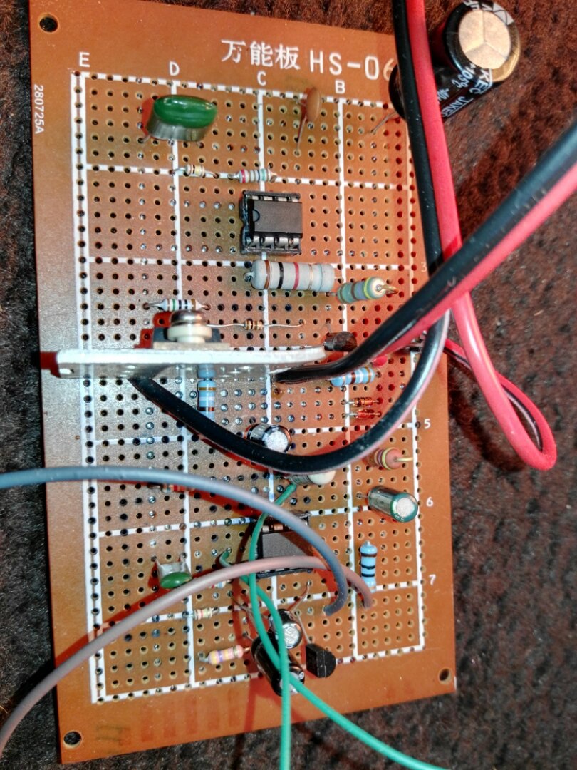

              i need to know where the potentiometer are. And i made the mistake that i used the half of an other schematic, now i have the 1 Watt 220 Ohm resistor in the middle.
              Which capacitor is behind the ic? Is this the 4,7uF electrolytic?
              Here is a picture from what i have made until now. I still have the 220R mounted i dont know how much watts.
              I dont have a 360R 0,5 watt, can i replace it with something?
              This is the layout which i wanted to use first:
              Some resistors are different, maybe because of the layout and/or the different ic. Im not an expert, im new to electronics.

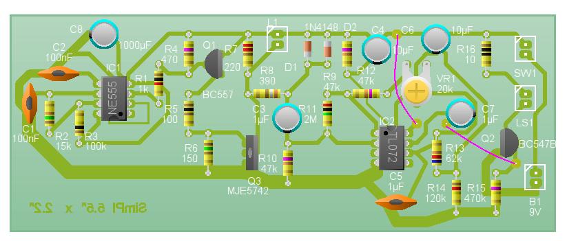

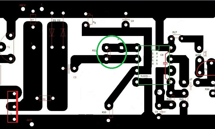

              • #67
                R11 and R8 are the pots. looks like only two legs being used on R11 Can't find 8.
                • #68
                  I see 3 Pots in the russian parts list: 500 Ohm, 100K and 50K.
                  I have used resistors where the pots belong to, I need to change them.
                  R8 is in the middle between the two black strips. It is the 360/390 one?
                  Do you think i can use a 500 ohm potentiometer for it?
                  • #69
                    It would work. Just not as fine adjustment. I only see two pots in the parts list. I'm lost in this mess. LOL I have too many damn Schematics.Click image for larger version

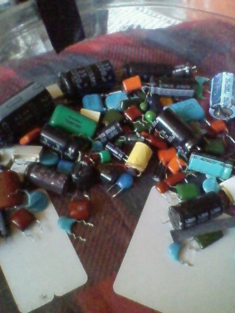

                                Just use 1/4 W resistors on every thing but the Damping. Looks like Reclaimed Parts sources. I do it all the time (Trash Technology) .Click image for larger version
Name:	Trash Tech1.jpg
                                Use 1 Meg http://www.taydaelectronics.com/1m-o...urn-3362p.html
