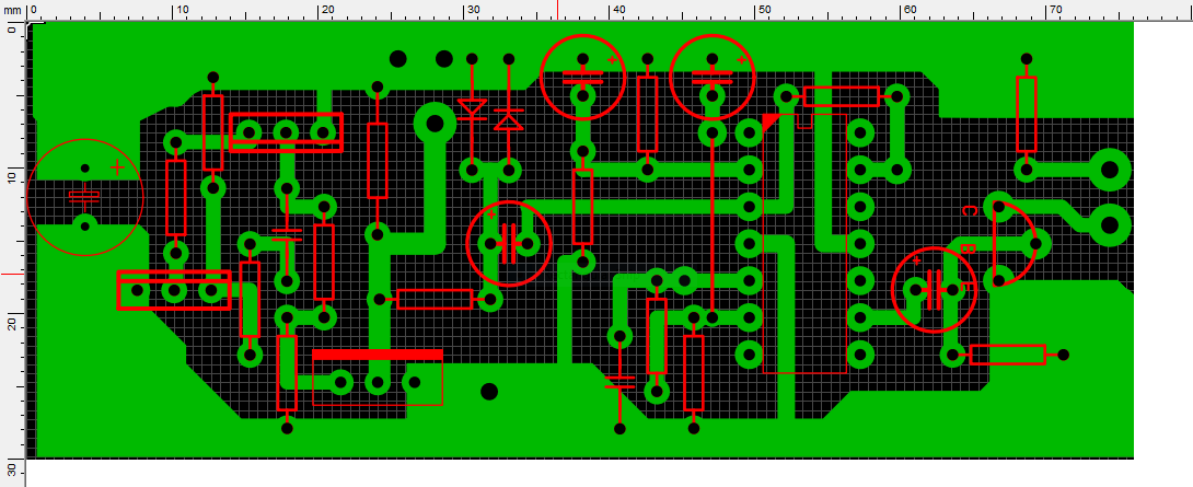

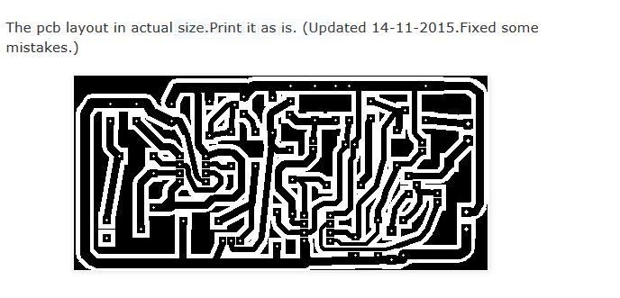

                Im doing the easier pcb with the 2200 uF electrolytic capacitor. The green and black layout picture from the site.
                https://www.youtube.com/watch?v=FsBIR41amtU
                I just saw that people are using different electrolytic capacitors and different pots.
                Its the only one that i have with the russian ic. The other ones use TL072 and the layout is different.
                By the way: Can someone please open the sprint layout file with a russian version because i cannot open it with mine.
                Or is it damaged?

                    • #55
                      Well my Lay viewer does not recognize it.
                      • #56
                        just rename the *.lay with latin letters and it works.
                        • #57
                          Ok , thanks, it worked, i needed to change the names of the folders too.
                          But its not the layout which i wanted to make. Same parts and size but different layout.
                          Its not important because i will use a stripboard.
                          The layout file is without NE555 , maybe another version.

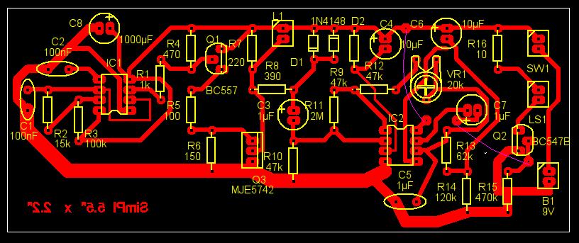

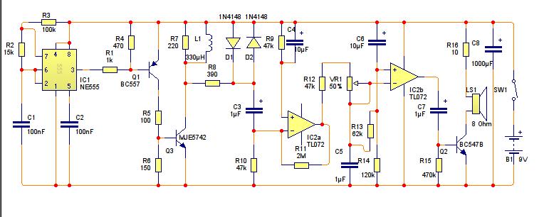

                          • #58
                            I have an SMD layout with Tl072 and ne555. + spl7 +schematic.
                            do you need it?

                              I have a Butt Load of Pirate stuff. Maybe one of these ?Click image for larger version

                              • #60
                                Homefire its none of these.
                                Yes i wanna see the smd layout.
