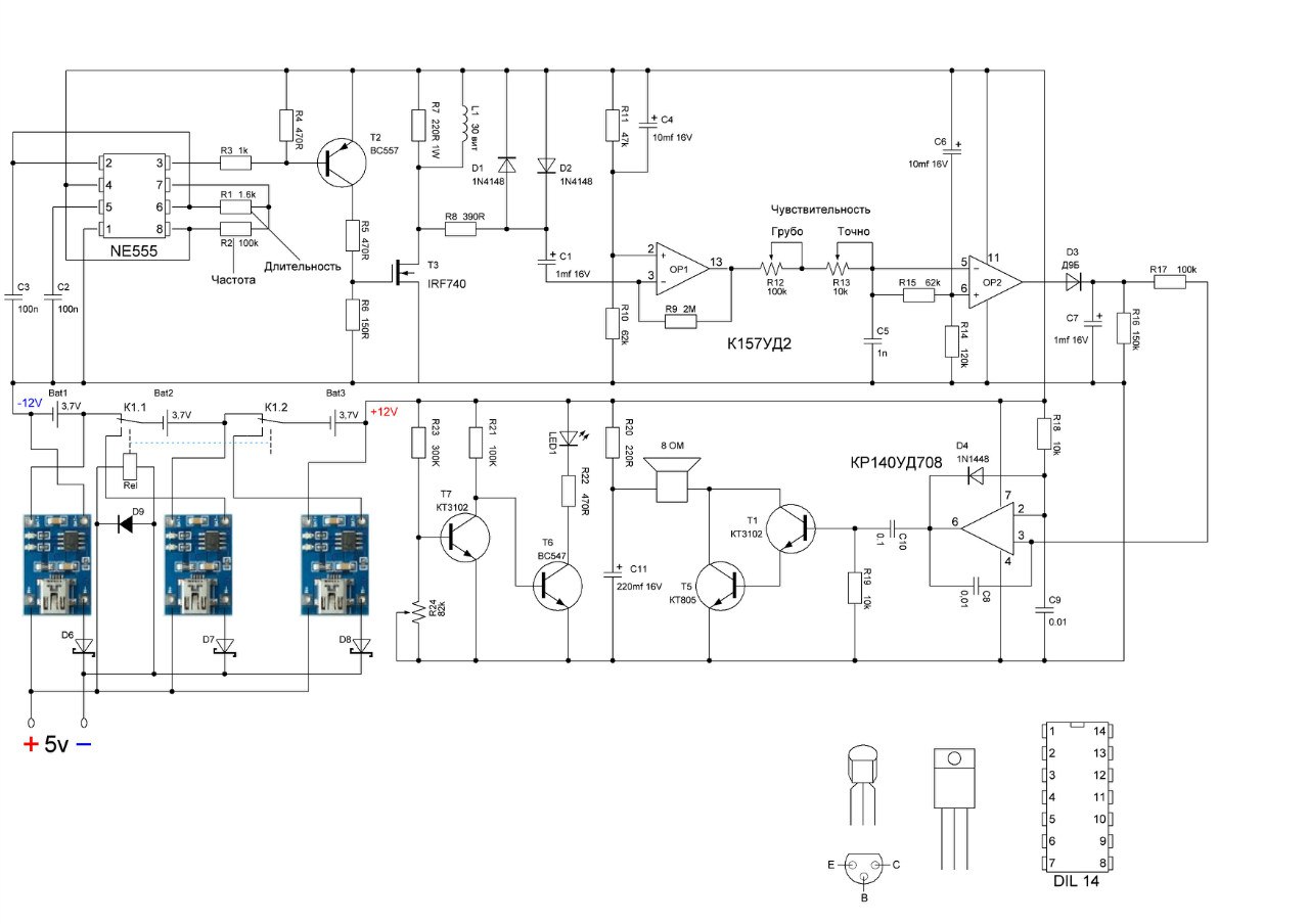

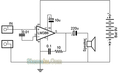

Can i change R8 in your schematic to make it louder?
Simple Russian PI detector Pirat
I checked my Russian pirate build from two years ago, on my PCB between pins 6 and 7 of 555 chip should be resistor 1.5k not 15k otherwise schematic posted is good. I think I used a Darlington plus 8ohm speaker for audio. If you build coil according to specs I posted it will definitely work with good results.

I like the loud sound. I can adjust the detector more sensitive when its louder.

Do you think a bigger Mosfet can make the detector stronger?
try a variable damping resistor and find best working value (wire pot- Drahtpoti) later you can change it with a normal resistor, (read the best value from wire pot with multimeter and take fixed resistor the is next in the value), and a coil diameter of 25-30cm.

I made a new coil 5cm diameter 46 Turns 0,3mm wire.
And im impressed with the results.
14 cm for a euro coin. And still a very good depht for bigger things and an acceptable depht for smaller things than an euro.

I use two trimmer pots now to test the board and its very stable.
Post #173 in this thread is my layout, i used 68k instead of 62k resistors, the ceramic cap is a foil capacitor and the transistors are BC558 and BC548.
12 Ohm instead of 10Ohm and the Mosfet is IRFP450, but i think this doesnt make much difference.
