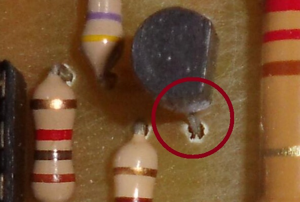

              • Thanks for the pictures. Perhaps it is this tansistor:
                Also the electrolyte capacitors can get damaged if they have connection with wrong polarity.
                First I would clamp in a different 555 chip, next I'd change the transistor and elkos.
                If this doesn't helps you might be better off building a new circuit.
                • I have already ordered some NE555. Do you mean this because theres is a white spot at the side of the transistor?
                  I have desoldered everything and tested with a transistor tester.
                  I need to look again what this white spot is.

                    • Originally posted by BKY1337 View Post
                      Yes, the white change of black "plastic" -could have been caused by heat - or just is some light-reflection.
                      Depending on the material, you can see if something was burned using a magnificent-glass
                      or with macro-mode pictures. Sometimes there are even little blisters or "hills".
                      Faulty Elkos even can look like "blown up" or they have white-yellow dirt at the cap.
                      This happens especially if they get too much heat over longer time.
                      Another method is using the nose to find the burned spot - but the later the harder it works.
                      Holding the pcb directly at your nose while breathing in over the nose gently.
                      Perhaps you have still a small change to locate the burned part this way.
